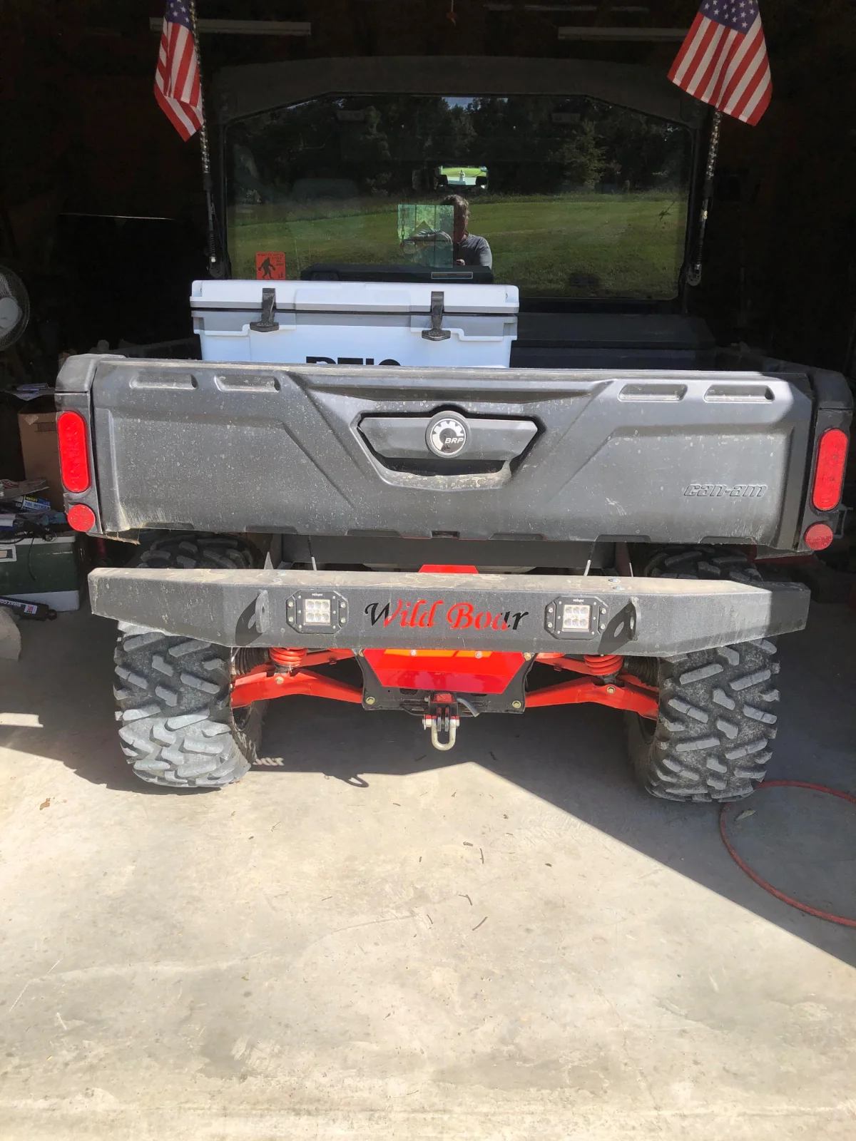

Im wondering if these lights would be a good choice for front turn signals? Any thoughts?
I ordered two of the cyclone (red) lights off amazon. Thay are advertised 516 lumas each. I wanted to see how bright or not bright they are. Reviews are all over the place, too bright, not bright enough?
Yes - 516 lumens.  They are the KC Cyclones.  One guy on this forum was able to rig up his brake lights to blink. That seems to me a better solution. However if you can get one of these KC cyclones to blink… You will certainly get noticed!
Ill report back. I dont know why they would not blink if you hook them to the LED Flasher and tie into the same switch that activates the rear LED turn signals. On my can am, I wired rear auxilary turn, running and brake lights that have their own circuit separate of the stock harness. Way less money and no need to cut into the stock harness.  Only issue so far is finding access to the stock brake wire near the brake pedal. I would cut in there to activate rear aux brake lights.

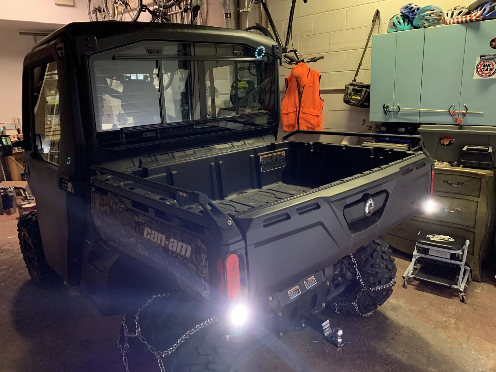

Mounted them to the factory door hinge location plus think I could still install doors once I get em. Got a pic of them lit up already on the topic defenders at work. Bright enough to be able to work into the night.

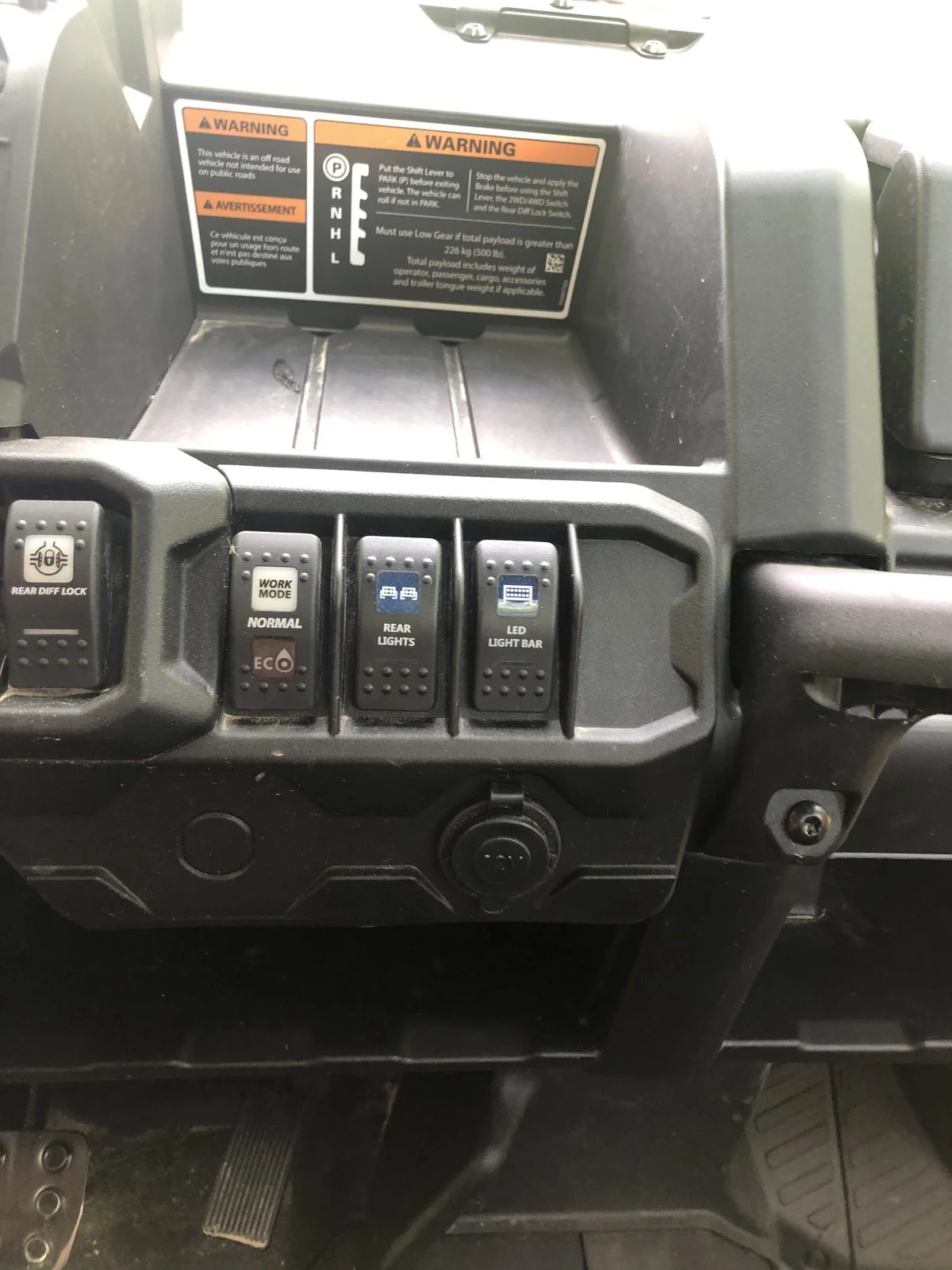

Anybody know if there is a reverse switch that we could tie into that make the backup lights go on when in reverse?  My Yamaha Wolverine had one, and it was nice, others definitely knew when I was backing up, and I didn't have to reach for another switch.
Sorry - not that I have found.  I didn’t go this route.  Back up lights only for me.  -Mark
