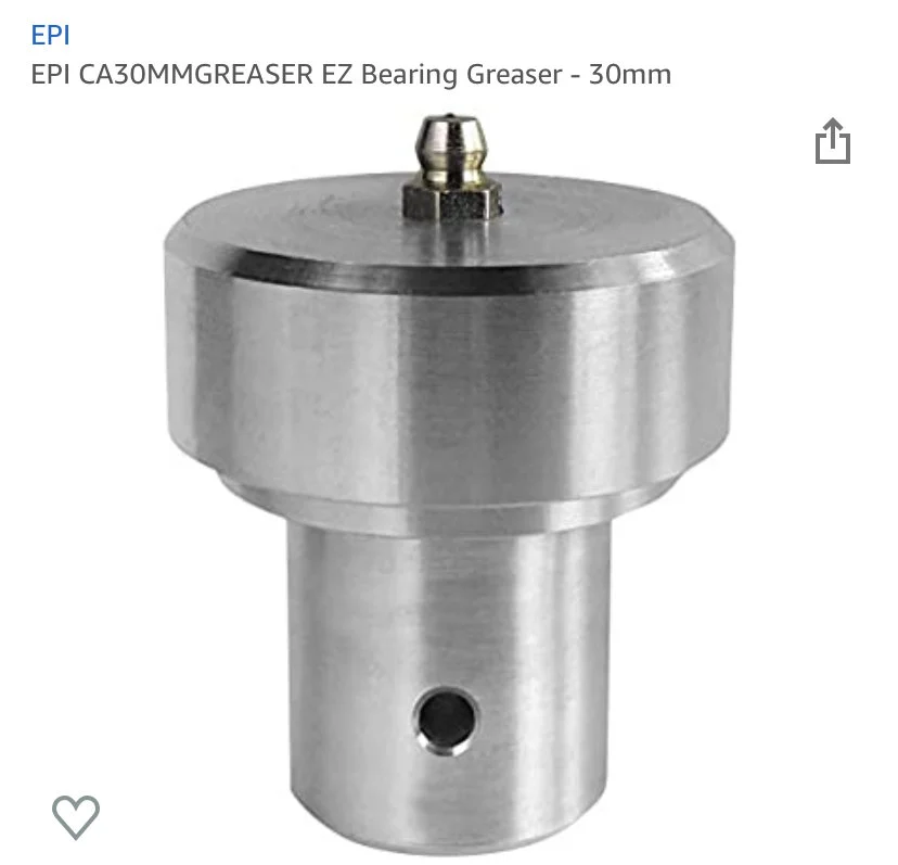

2018 defender xt cab. Hd10.
Looking for the greaser tool for front and rear wheel bearings. Lots listed online but hoping to find one that works without removing drive shaft or ball joints. Read somewhere the x3 might work but ball joint must be removed.
Hey Jason. This is the one I bought for my 2020 hd10 max. You still have to remove the axle from the hub, but it wasn’t awful to do. Doesn’t show any o rings in the picture for some reason, but mine came with them. Won’t inject grease without them. Great tool! Good luck!
Did u just remove the lower ball joint to get it to work or the works?
Yes I had to remove the lower ball joints to slide the axle out far enough. Wasn’t too bad of a job.

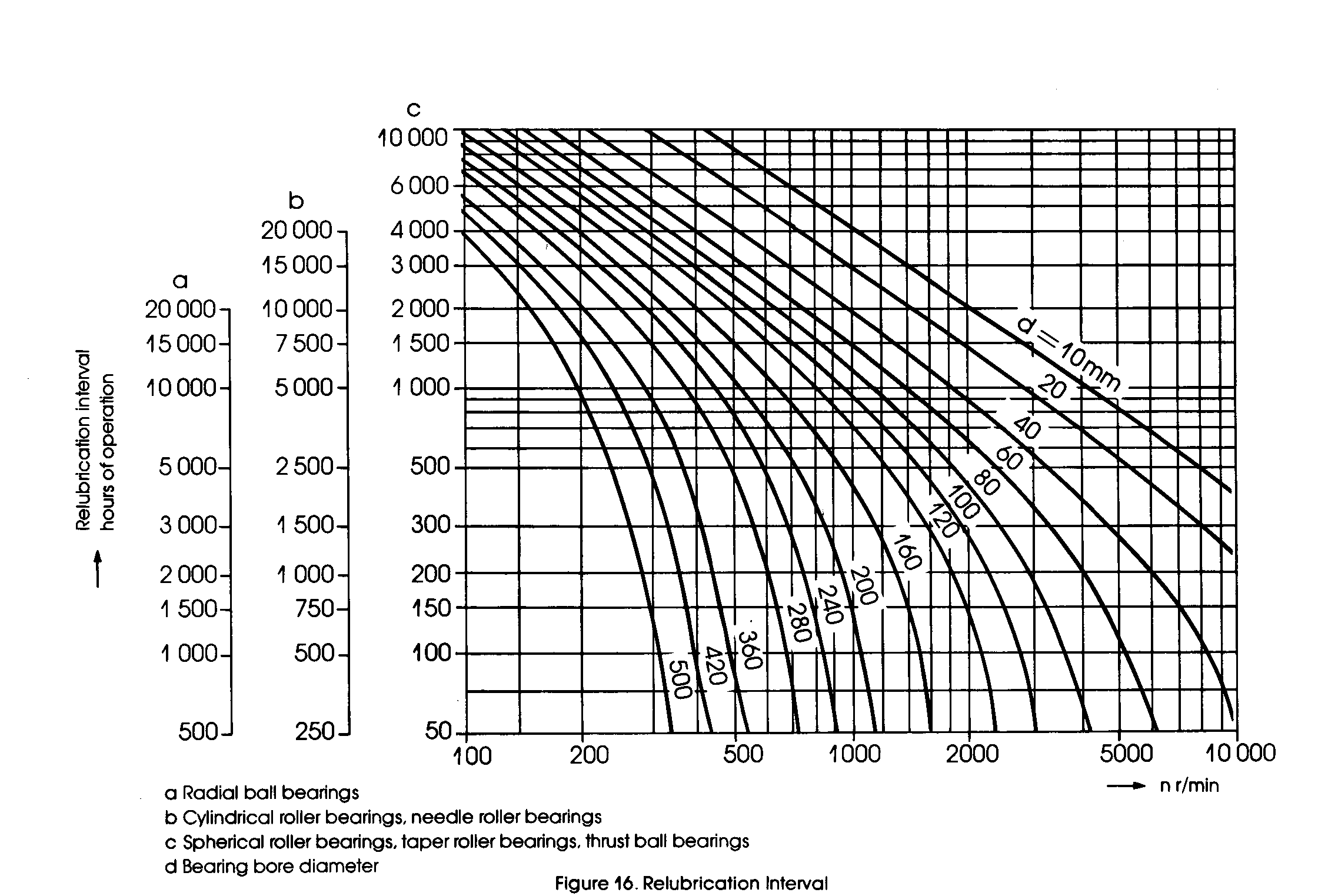

BEARING RELUBRICATION
How often should I grease my bearings, and how much grease do they need?
  • FOR STARTERS, note that most sealed bearings come pre-greased from the factory with a 25%-35% grease fill. This is all the grease the bearings will ever need, because the relubrication interval (explained below) is longer than the expected life of the bearing.
  • DON’T JUST GUESS. It can be tempting to give the bearings a pump of grease each day, or to pump until grease comes out from under the seals.  However, this effectively destroys the seal’s ability to keep contaminants out of the grease; and too much grease “churns” inside the bearing, generating resistance and leading to rapid heat build-up.
  • FREQUENCY: The accompanying chart shows approximate relubrication intervals. Start at the bottom by choosing your speed; follow the line straight up until you meet the curve that matches your bearing O.D., then go straight left to see the relubrication interval for your bearing type.
  • AMOUNT: To find ounces, [(OD in inches) x (width in inches) x 0.114].  To find grams, [(OD in mm) x (width in mm) x 0.005].
(You can right-click and open the image in a new tab to see it full-size.)
  • FOR EXAMPLE, suppose your application has a 6209 ball bearing, running at 1,750 RPM in a clean, smooth machine for 24 hours a day, 7 days a week.  A 6209 bearing has a shaft diameter of 45mm, an OD of 85mm, and a width of 19mm.  Using the chart and the formula, the bearing only needs 8 grams of grease every 10,000 hours.  If your grease gun delivers around 1.35 grams per stroke, that means the bearing needs 6 strokes every 13 months; you could average it out to a stroke every 8 weeks or so.
