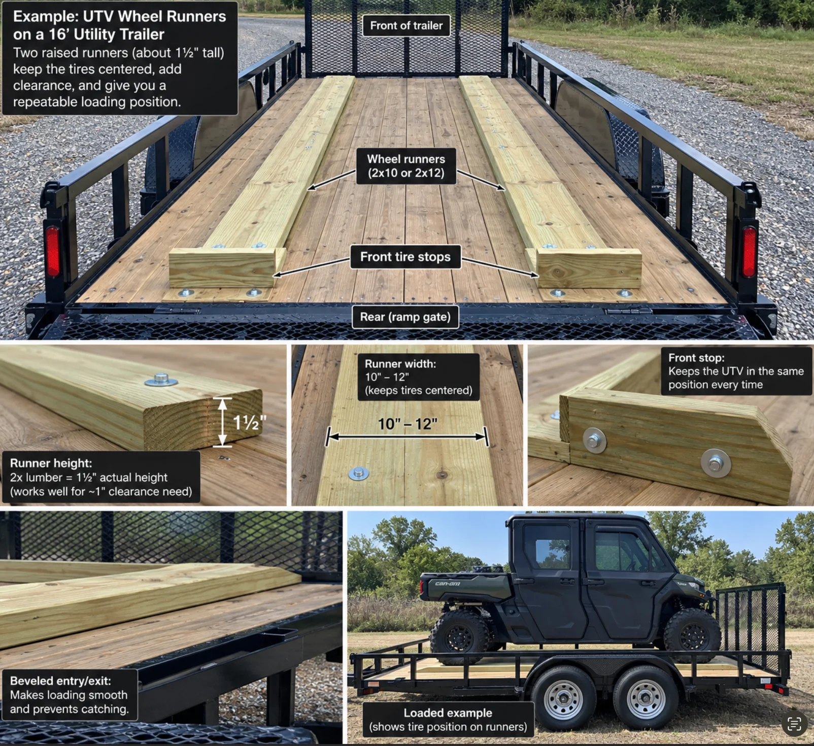

Anyone find a utility trailer with 12" pipe? I have a 14ft that clears the 12" but won't fit the HD11 Max with the gate which I wish to keep, also a little too heavy for the Big Tex 35SA. I'm looking to purchase an 83' x 16' and will have to use wheel ramps to lift to clear about the 1/2" that doesn't allow the doors to open. Am I risking too much with an open trailer?
Photo of possible mod on a 83'x16' for 26 HD11 Max
