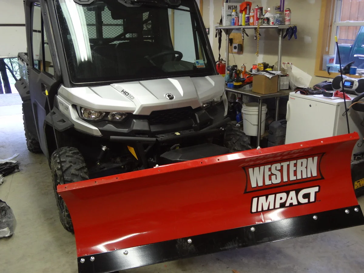

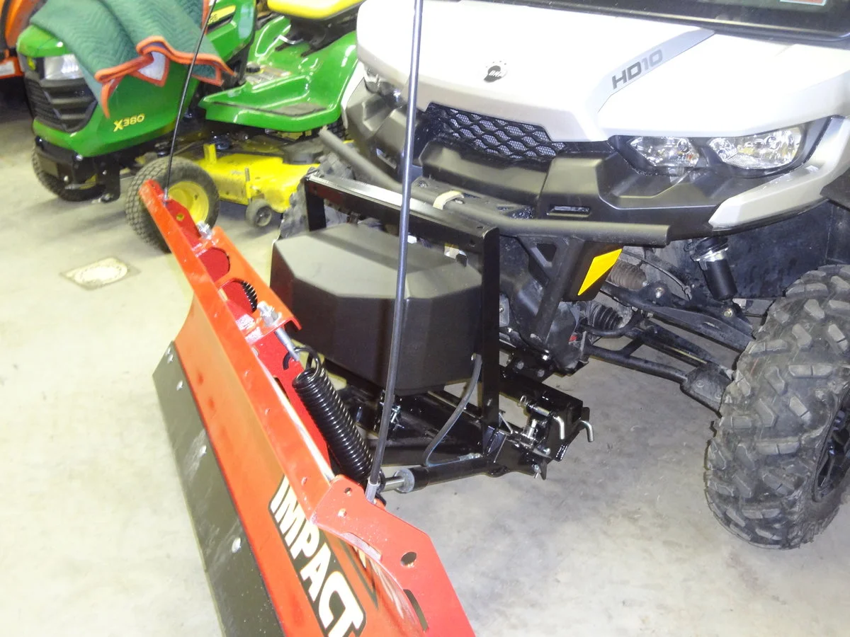

Got the Plow installed. Now just waiting for snow
Looks good!     Do you have any pictures of the mount setup?
The base plate is simple 8 bolts, only need to drill 2 -3/8" in front. The main mount, where the 2 clevis pins are is where the plow clips into. It locks into the mount via a locking pin set
Overall well engineered and thought out design. Although running the electrical from the front back into the battery was a pain , but that's on BRP not Western.

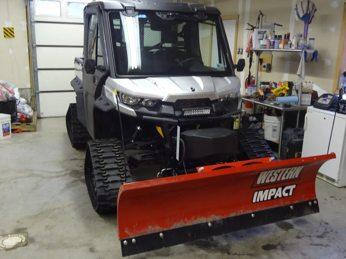

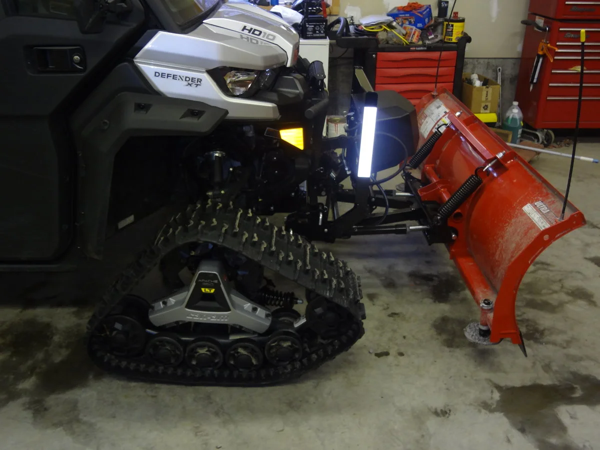

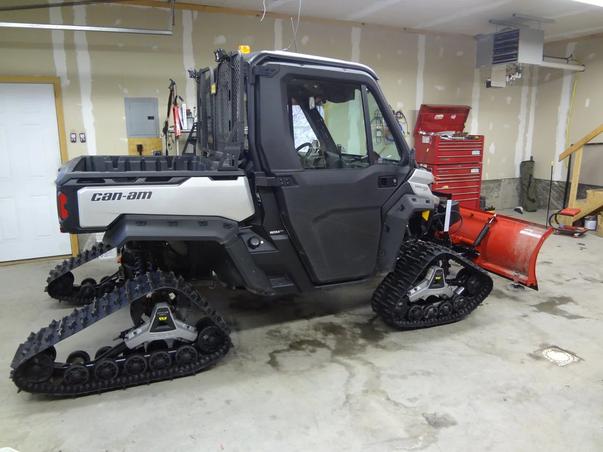

I got the Apache LT tracks installed this morning on the HD10, also mounted the plow to check clearances. I will need to install cylinder stops on the angle cylinders and modify the plow dolly. It should be a blast running this beast this winter.
Think Snow! :classic_biggrin:

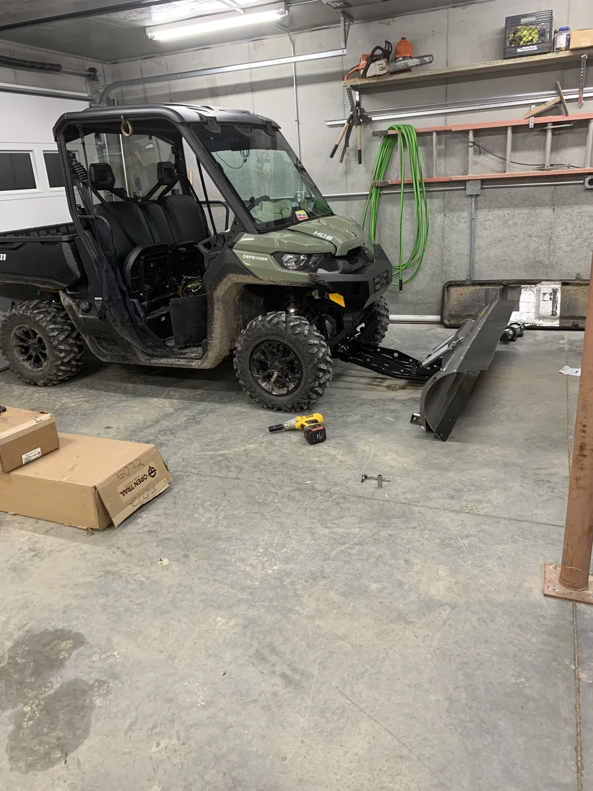

Sorry for the delayed response.  I wanted to wait until I got everything installed before I posted.
I went with the KFI Open Trail 72 steel blade in my original post.  So far I think it will be a very solid set-up.  I have done a little back dragging gravel in the driveway and it's a tough blade.   The blade alone weighs 110# and the mounting was super easy.  All hardware included for $655.98 is a great buy in my opinion.
Now I just need some snow to really try it out.  I'm going to try to post a pic and a video I have on my phone.   I'll try to get more detailed pics later.

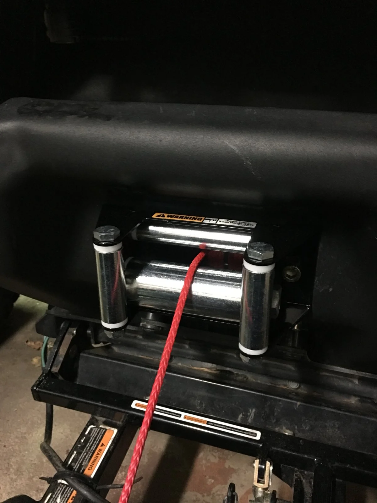

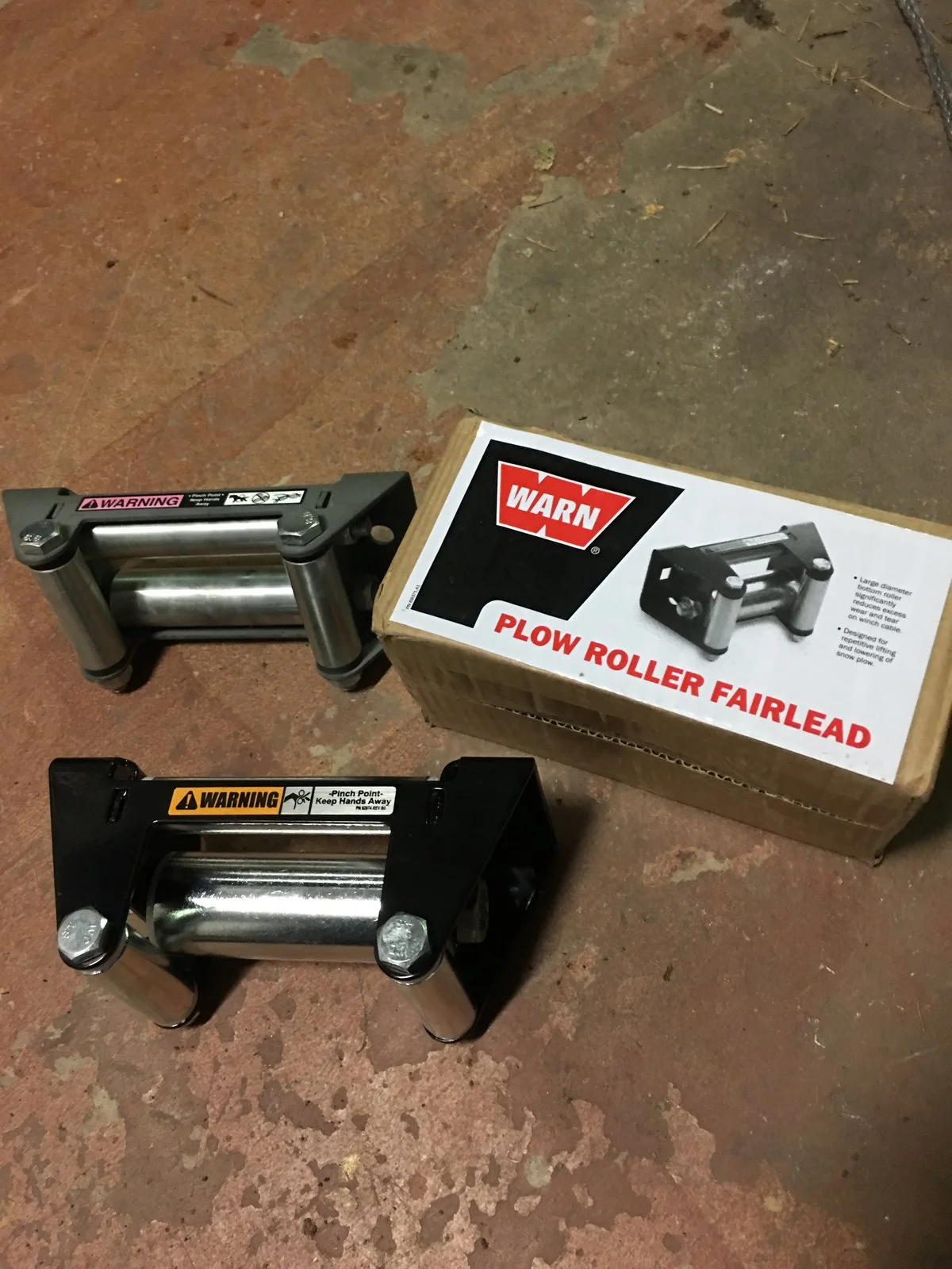

Nice!  If you find that your rope or cable is wearing out prematurely, consider upgrading your fairlead to one with and oversized lower roller.  It’ll take some of the stress off the line caused by the sharp bend doing down to your blade.
My stock fairlead actually BENT under the weight of the Can-Am blade, causing the roller to seize after only 4 days of use.   The Warn upgrade seems to fix it.
