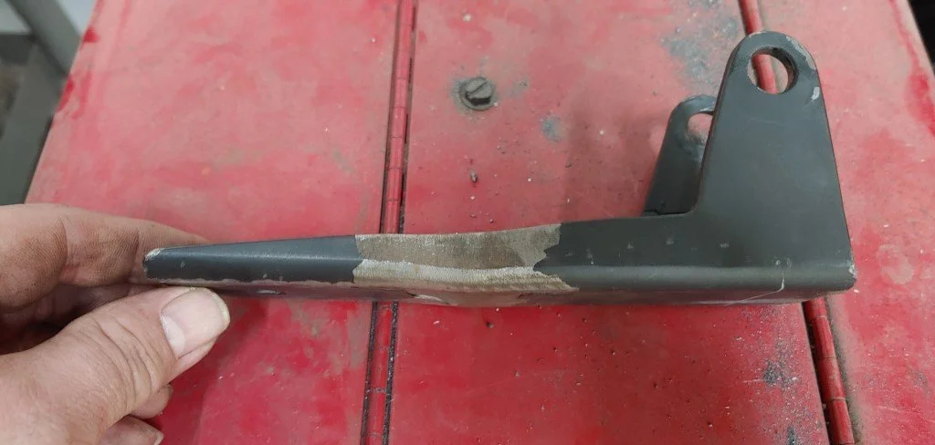

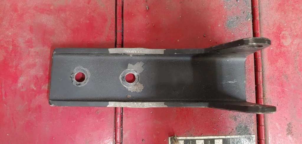

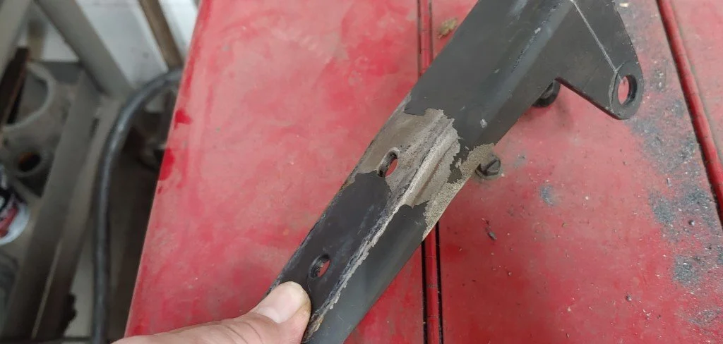

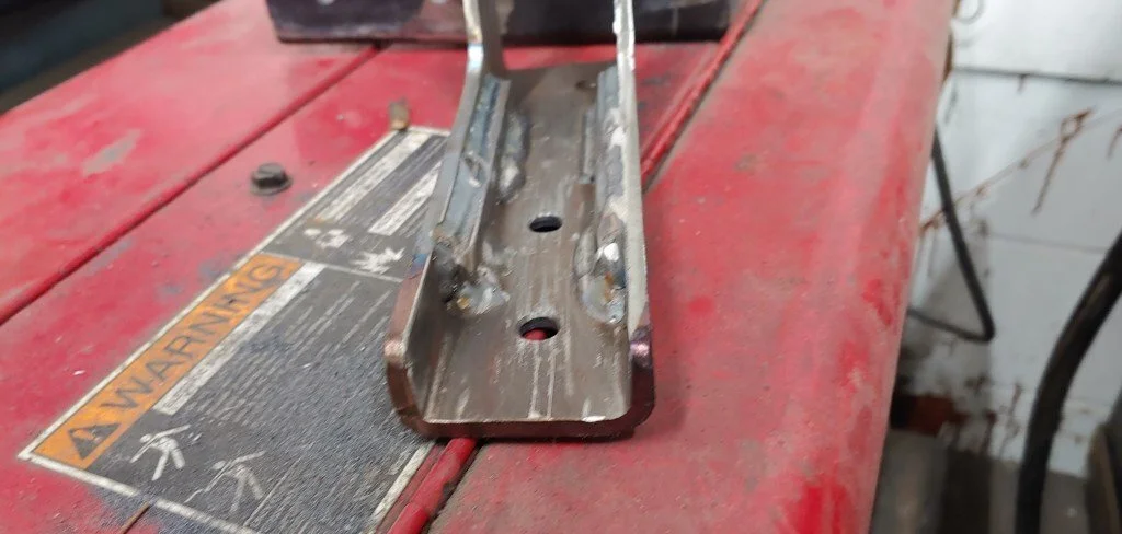

Old bracket with damage from being folded a few times. I didn't get any when it was folded in half at a 90° angle, but you can see the fatigue and distortion. I used the actuator and lever to straighten it enough to finish.

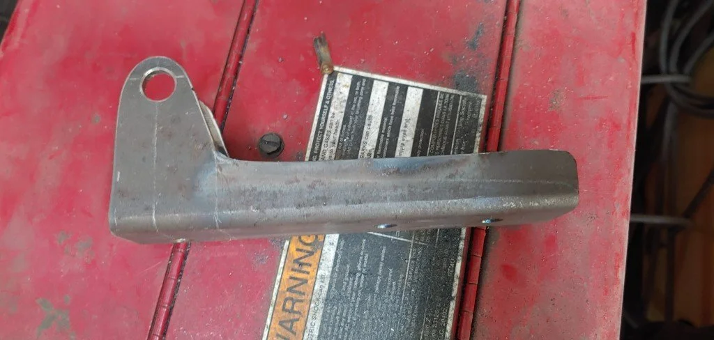

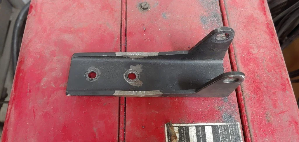

New bracket. Its going to stay in the raw until spring at this point, if it survives.

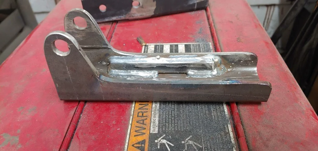

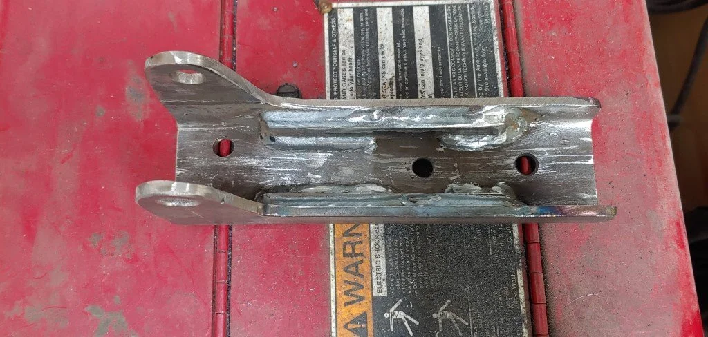

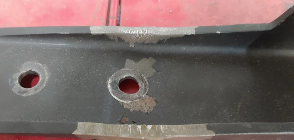

Even the rebuilt reinforced bracket took a slight bend it in. There is a little bit of space now at the back end of the bracket between the push tube. Haven't fully decided what I plan to do. I have a few ideas on how to redesign the bracket to be beefier. Other option is to look for other actuators/rams, one that fits better (i.e. 3" shorter) so I don't have to run an offset bracket.
