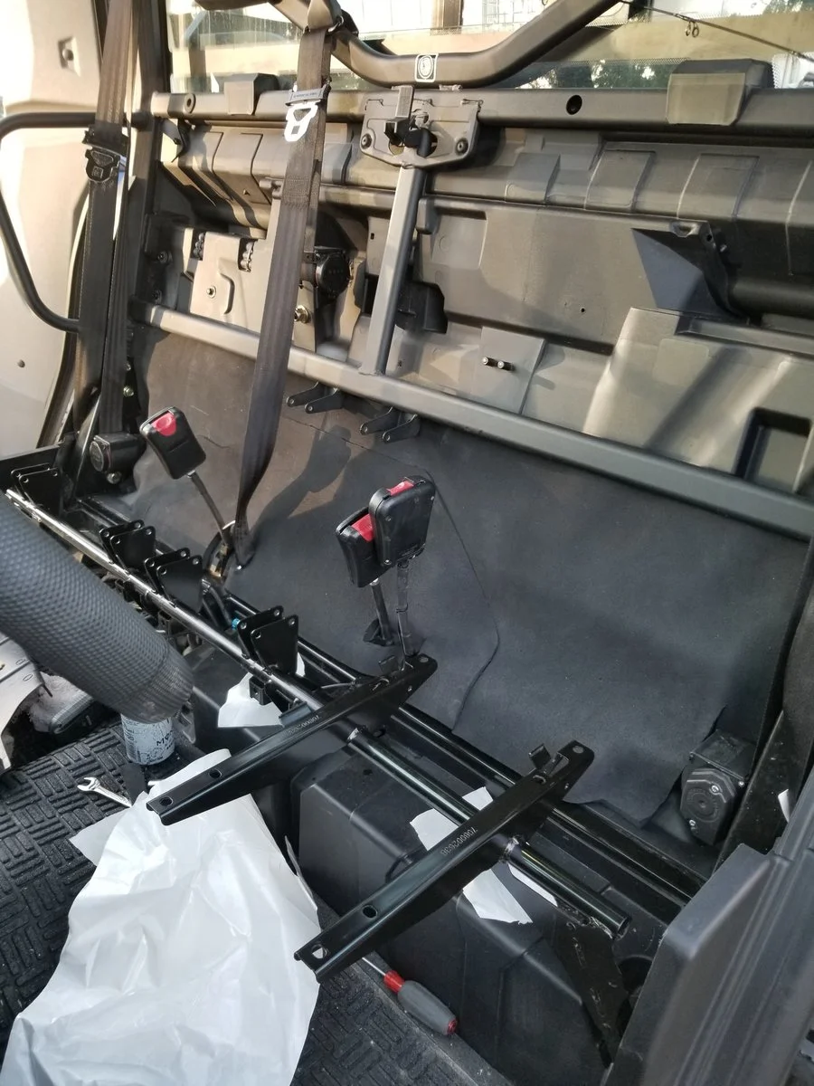

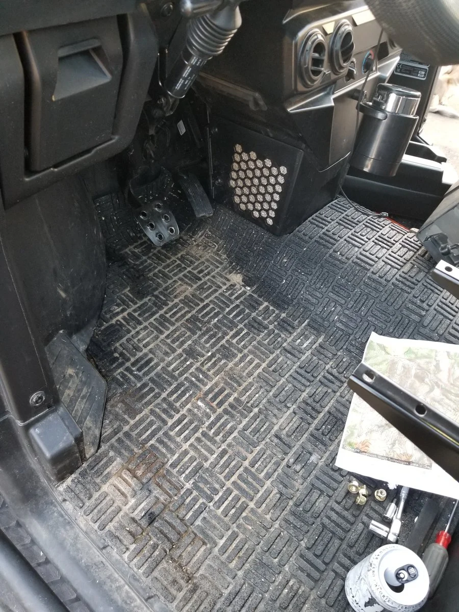

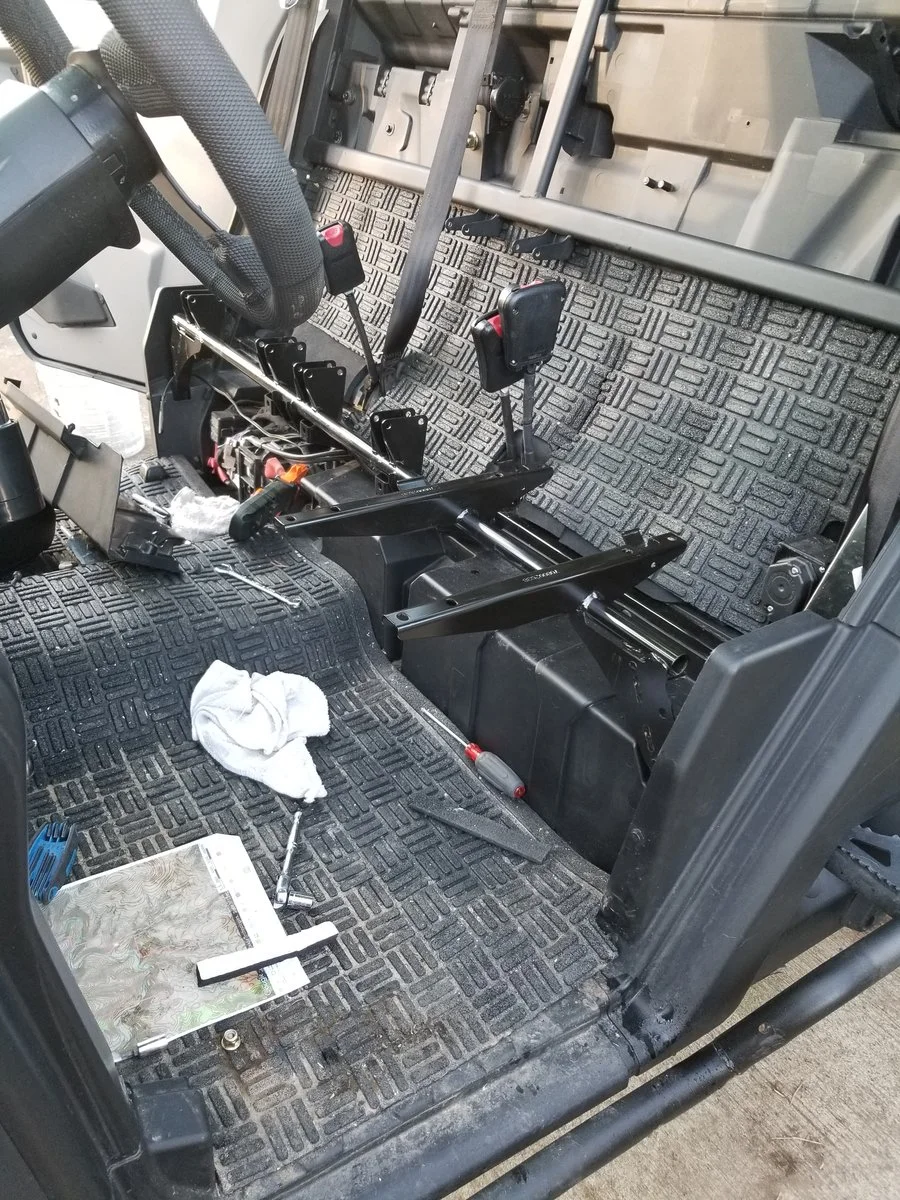

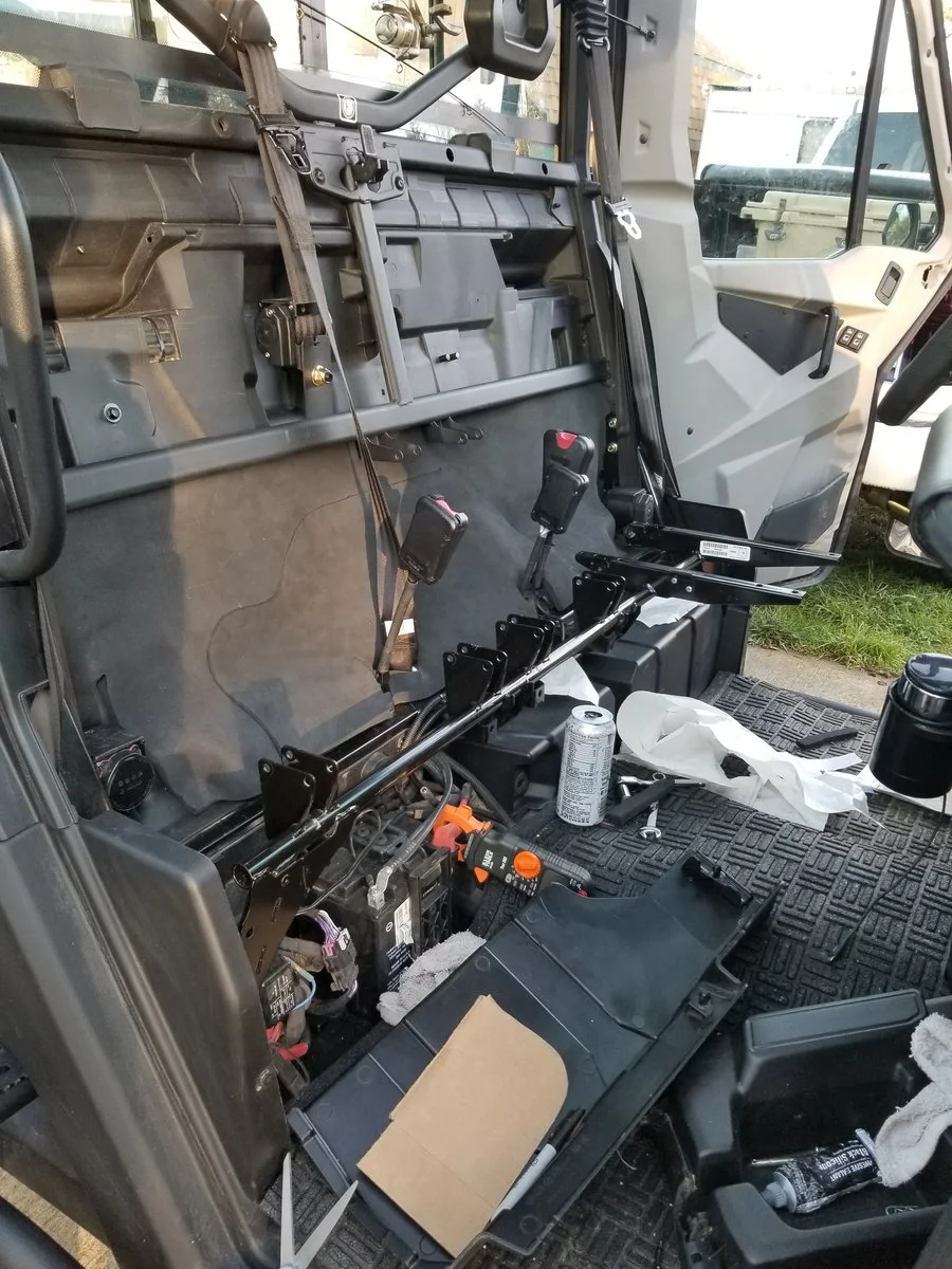

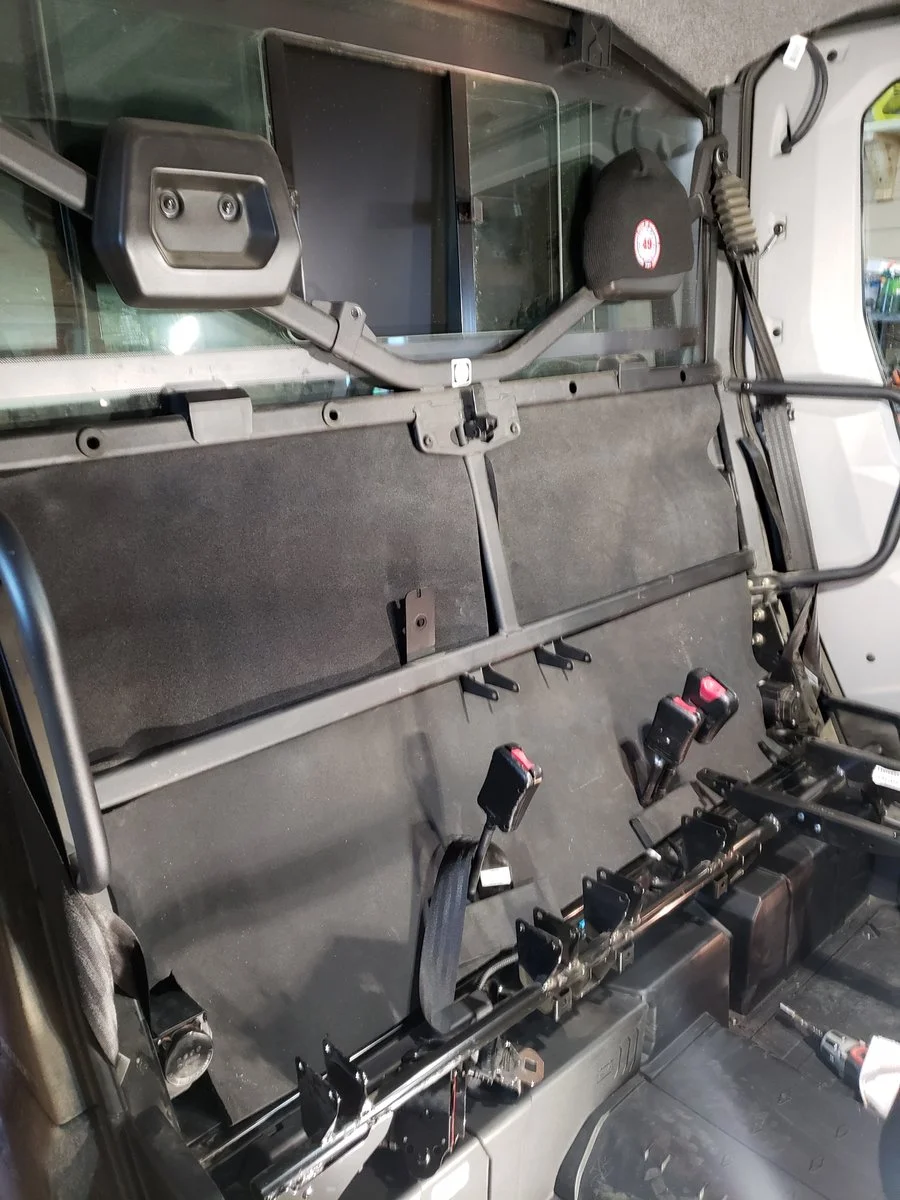

So... after purchasing a soundproofing product from the stereo shop for QUITE A BIT MORE (but hadn't used it) I ran into this thread. My first thought was something in a horse mat type of thing, BUT NOT THAT THICK!!! I found a 6'x4' floor mat at home depot that was my first attempt. It work pretty well overall, but didn't kill the engine at high RPM's. Awesome as a floor mat though!!! Kept great traction under foot even with snow being track in... (I also think the way it lays over the floor laps, it will help with dust in the summer)But after seeing the 1/2" sticky back foam, it was game on. I bought two rolls. One for below the mid bar across the back and one above. Then I doubled the lower section again with the original floor mat I used at first. But again, i think all the extra foaming will contain my heat, dampen the road/engine noise,as well as keep the cab cleaner..... as you can see in pictures (if you look close) I cut the on the lower section so the access panel can still be removed. I also did behind the battery cover. I have all three compartments for under the seats which also helps with the noise below the seats... thinking I may get some for the bottom of the roof to retain heat loss and givethe speakers some backing for some depth/tone....

Oh, I also bought two more rolls for the roof. May even pull the door skins and do them... I mean for the price of 6 rolls? The heat retention and sound proofing it provides is WELL WORTH THAT!! IMO
