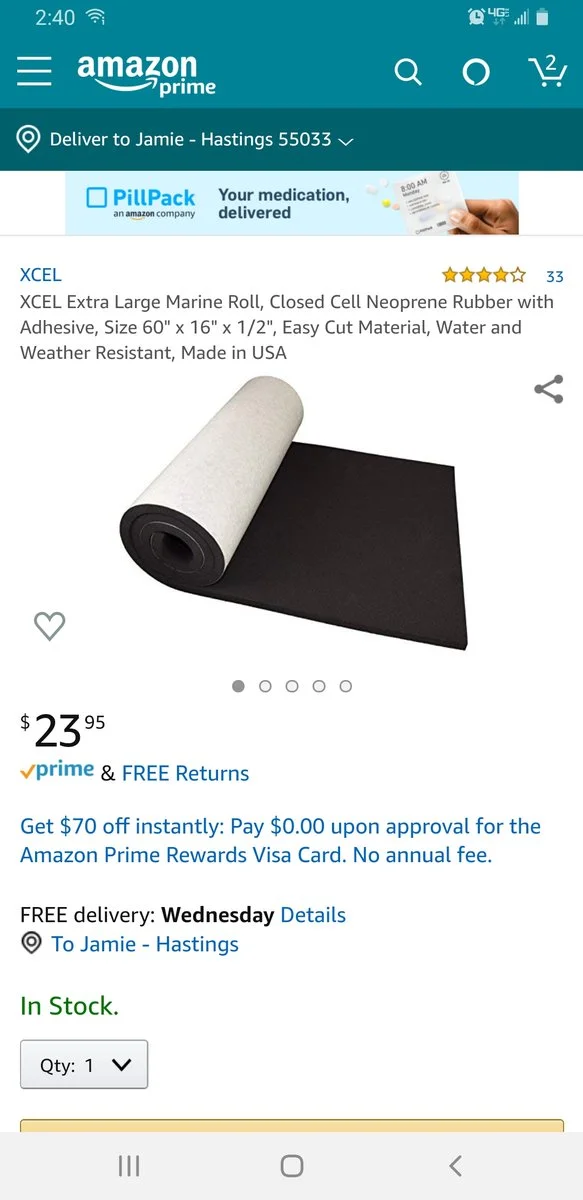

I just ordered some (xcel) brand 1/2 inch sticky padding. Im going to stick on the inside of machine, to try to quit it down.  I'll let you guys know how it works.
I think this should help. All that separates the motor from the cab, is a thin layer of plastic.

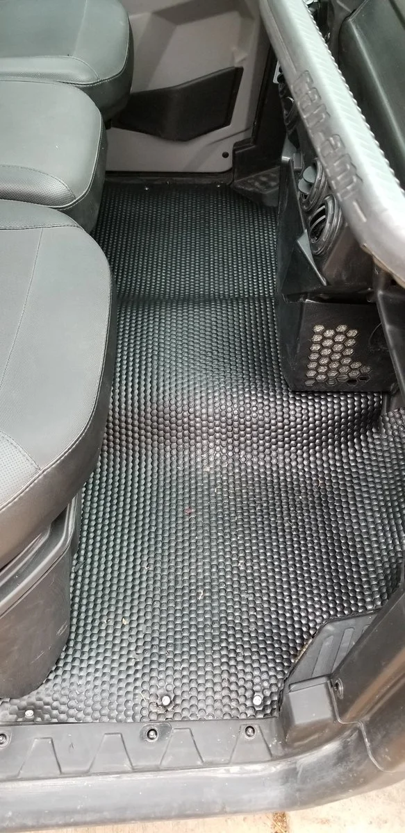

I have a 2019 xt hard cab and have taken a 1/4 inch rubber mat from Tractor supply ( or any farm type store) trimmed it to fit the floor and placed it like a floor mat. Haven't  ridden the bike since but it has got to have some affect on reducing the noise. I am also planning a sound reducing material behide the seat area soon. I will let you know how it works.

The matt looks good and will make it easier to clean the floor without all the cracks etc. I am sure it will have some effect on reducing interiro noise as well.☺️

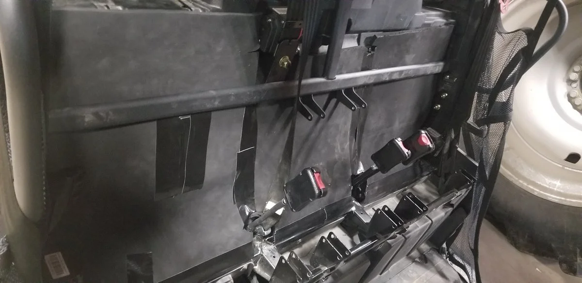

I have 2019 hd10 defender  lone star.   Measured sound levels in back seat and front seat during idle and at 10 miles per hour, and then used thermo tech heat/sound suppressor behind back seats.  reduced sound levels in back and front seats by up to 10 decibels, which is significant.   I can now talk easily to front seat passenger, and noise levels are low enough in back seat for them to also converse without shouting.   Below 85 DB in back seat now, which is the osha level for noise induced hearing loss over 8 hour period.  Overall very worth the time and expense.  I am going to add more in spots in the engine compartment to further reduce but have to be careful to keep away from the hot spots because some have advised it can drip the asphalt backing even though rated for high heat by manufacturer.  I would also like to add some floor mats and put some sound insulator on the bottom.  Anybody know where to get aftermarket floor mats for this vehicle?
