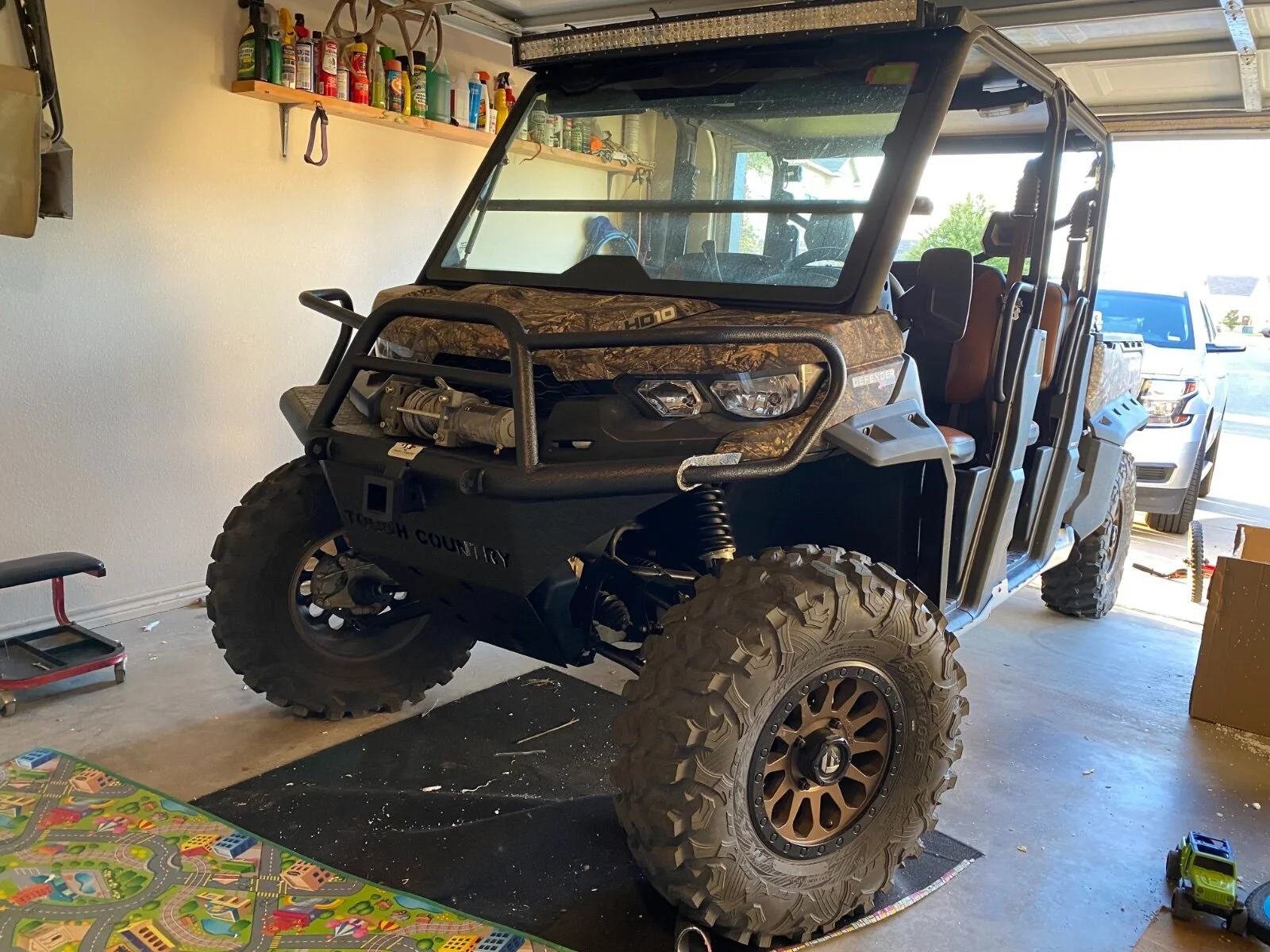

I have a 2019 Lonestar that I'm moving the factory winch from it's lower location to up on a Tough Country bumper I've installed. Trying to re-route the cables and I'm waaay too short.

All that said, I need to re-route my cables that run from the solenoid up to the winch, but am having hell figuring out a way to get enough length to reach the winch, which mounts to the top of the bumper. How are yall re-routing the winch cables on the XT and Lonestar models to a bumper mounted winch?

New bumper just for grins

This was going to be my simplest solution if I couldn't find a good way to re-route the wires. I've moved the cables every which way and crawled up under the dash. I don't see any way of getting any extra length to them, short of pulling the dash, cutting another access hole in the upper firewall area, and going straight forward. That seems like excessive work  IMO. I was hoping there was a simple fix with just a re-route that I wasn't seeing. lol
Updated: Well, I messed with the re-routing of the power cables to the winch quite a bit last night and have it working, but it's not ideal. I pulled the cables back inside the "cab", drilled a big hole higher up in the firewall and poked it all back through. I got the cables to reach, but one of them is super tight. I may have to do some more drimmel work to move the cables up another couple of inches.
