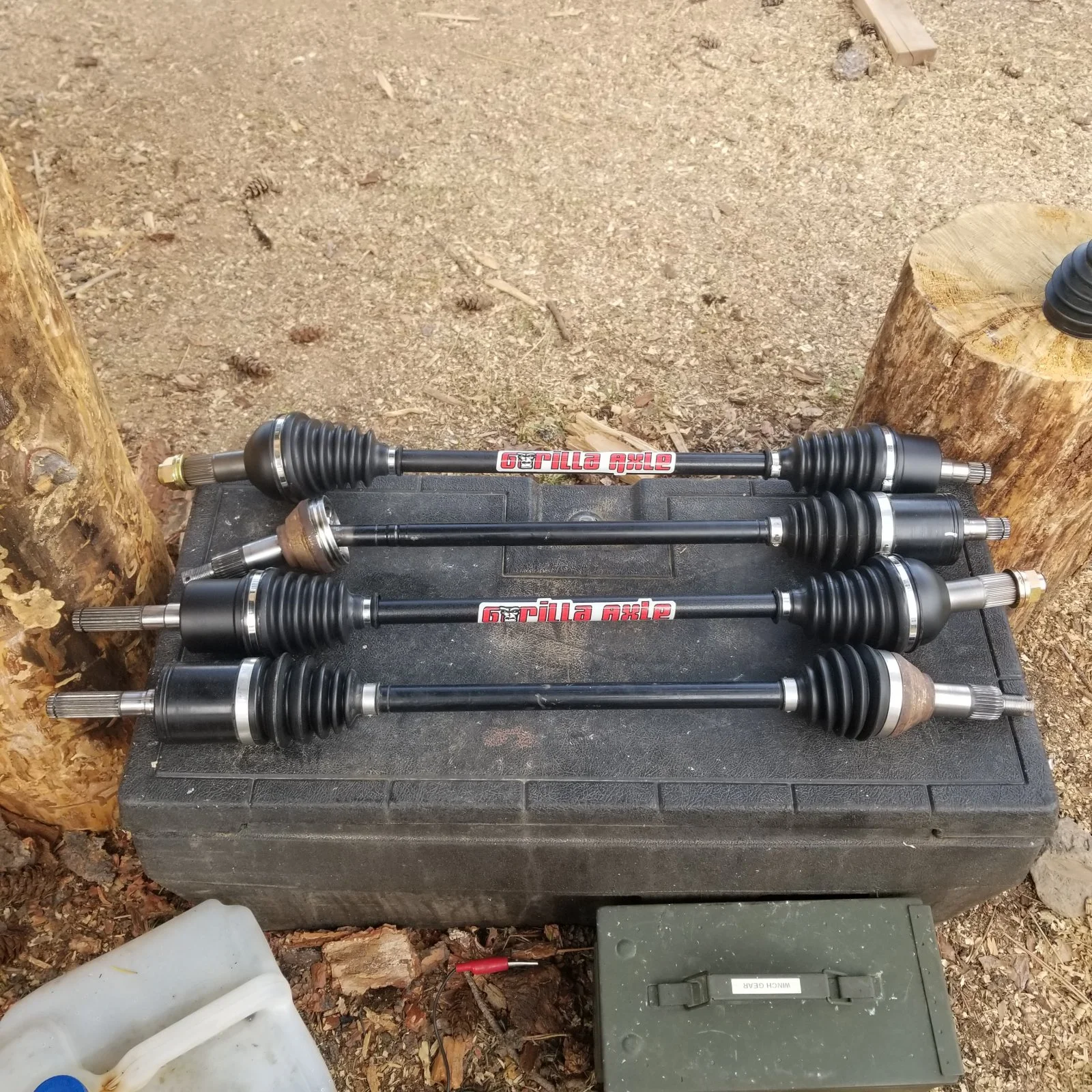

Well here's an update... First off let me say, SIDE BY SIDE STUFF IS A JOKE!!! But I'm not gonna elaborate... BUT.... GORILLA AXLE IS AWESOME!!! NOT CHEAP!!! BUT AWESOME!!! And were STRAIGHT UP WITH ME!!! The double plunge design, along with the HD 40° CV's and Chromoley shafts make these things look dame near INDESTRUCTIBLE!!! But I still opted for the lifetime warranty....
A HUGE THANK YOU!!! To Amanda and the crew at #gorillaaxles for building me a set and overnighting them to me.... Even with the ups hiccup....

These axles have plungers on each end... and HD CV joints... So breaking one of these dudes is gonna be next to IMPOSSIBLE. But if I do? I got the lifetime warranty... It's pretty clear that rear axles and a driveline are in Bears NEAR FUTURE!!
