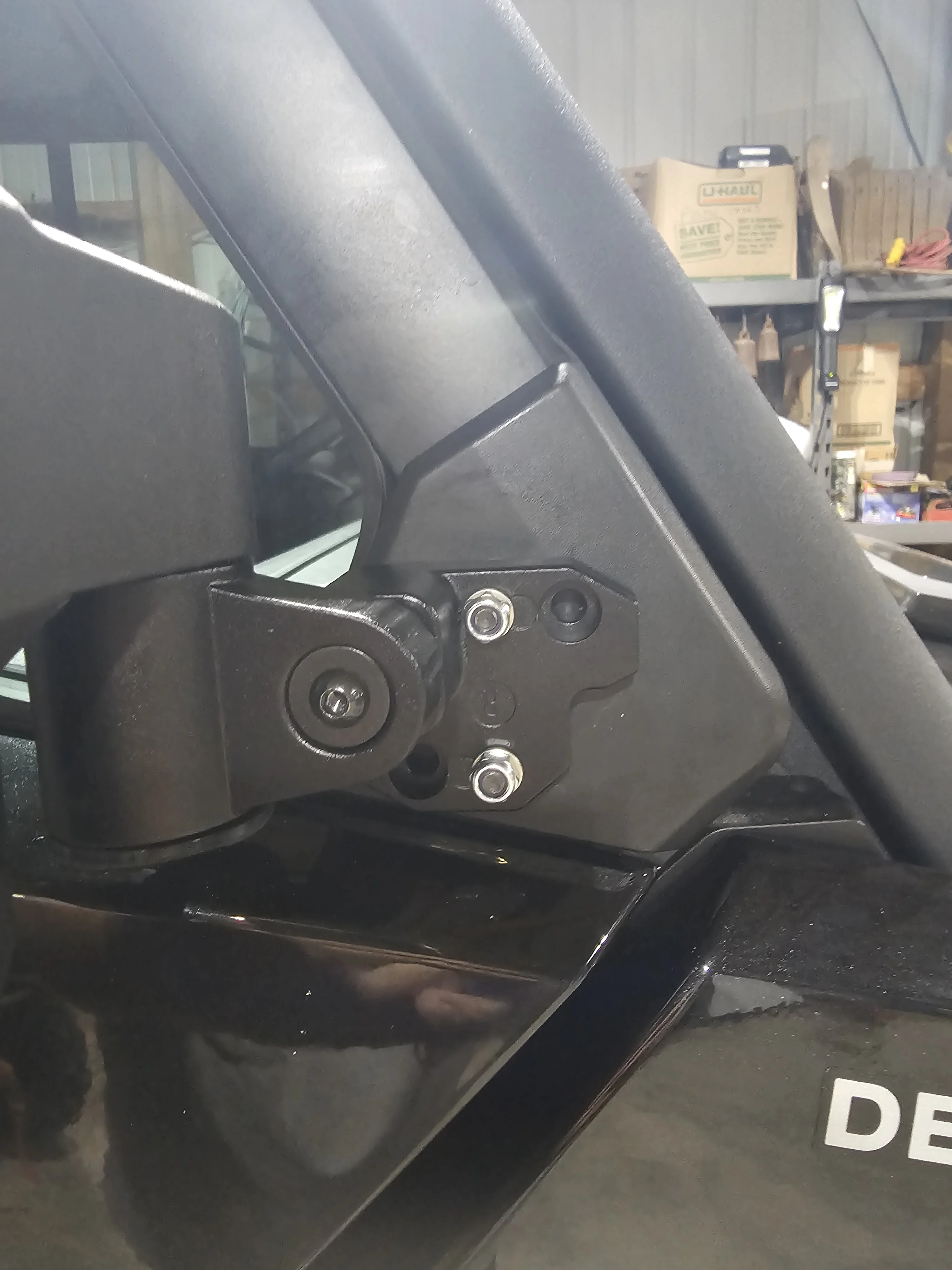

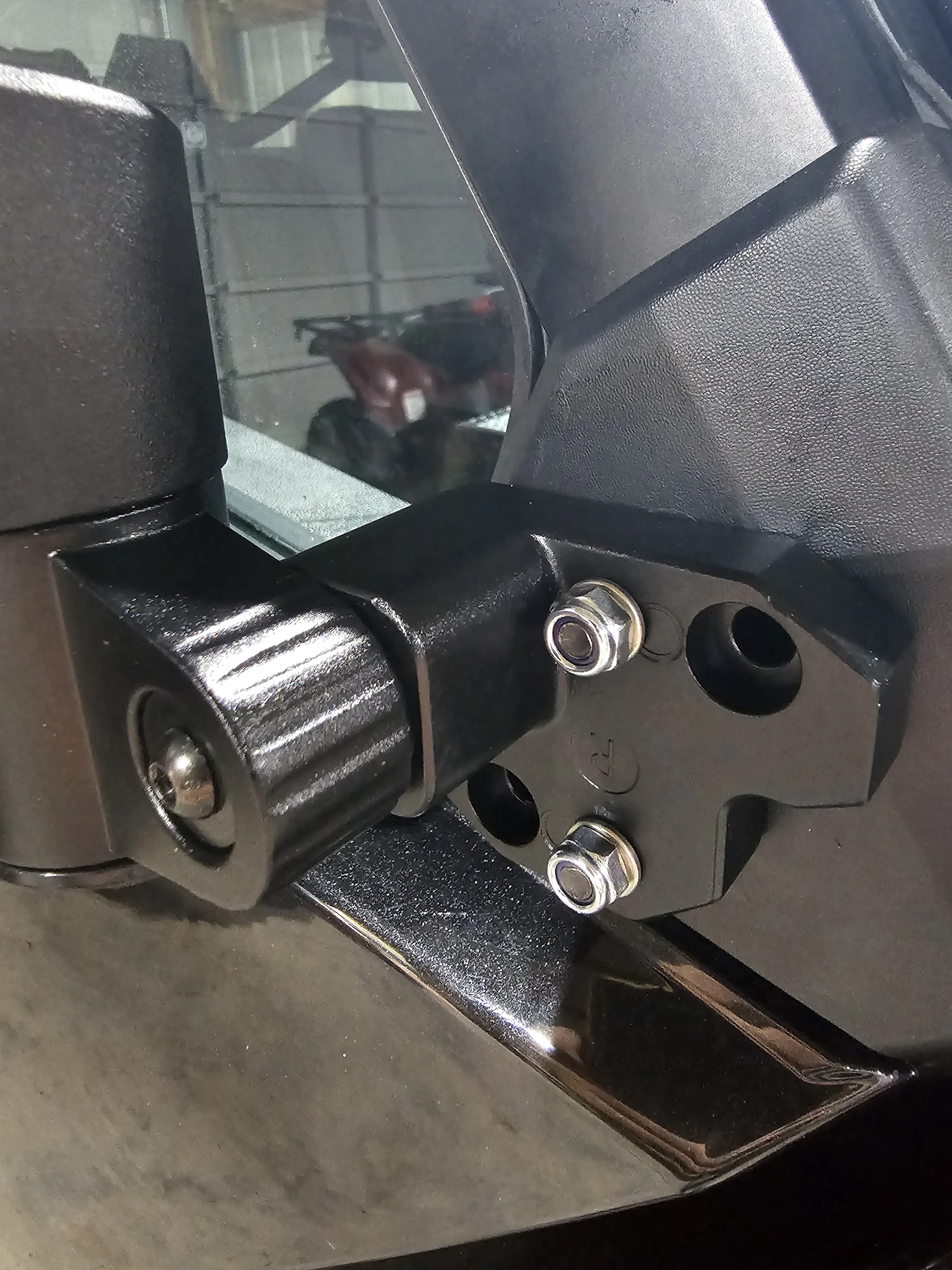

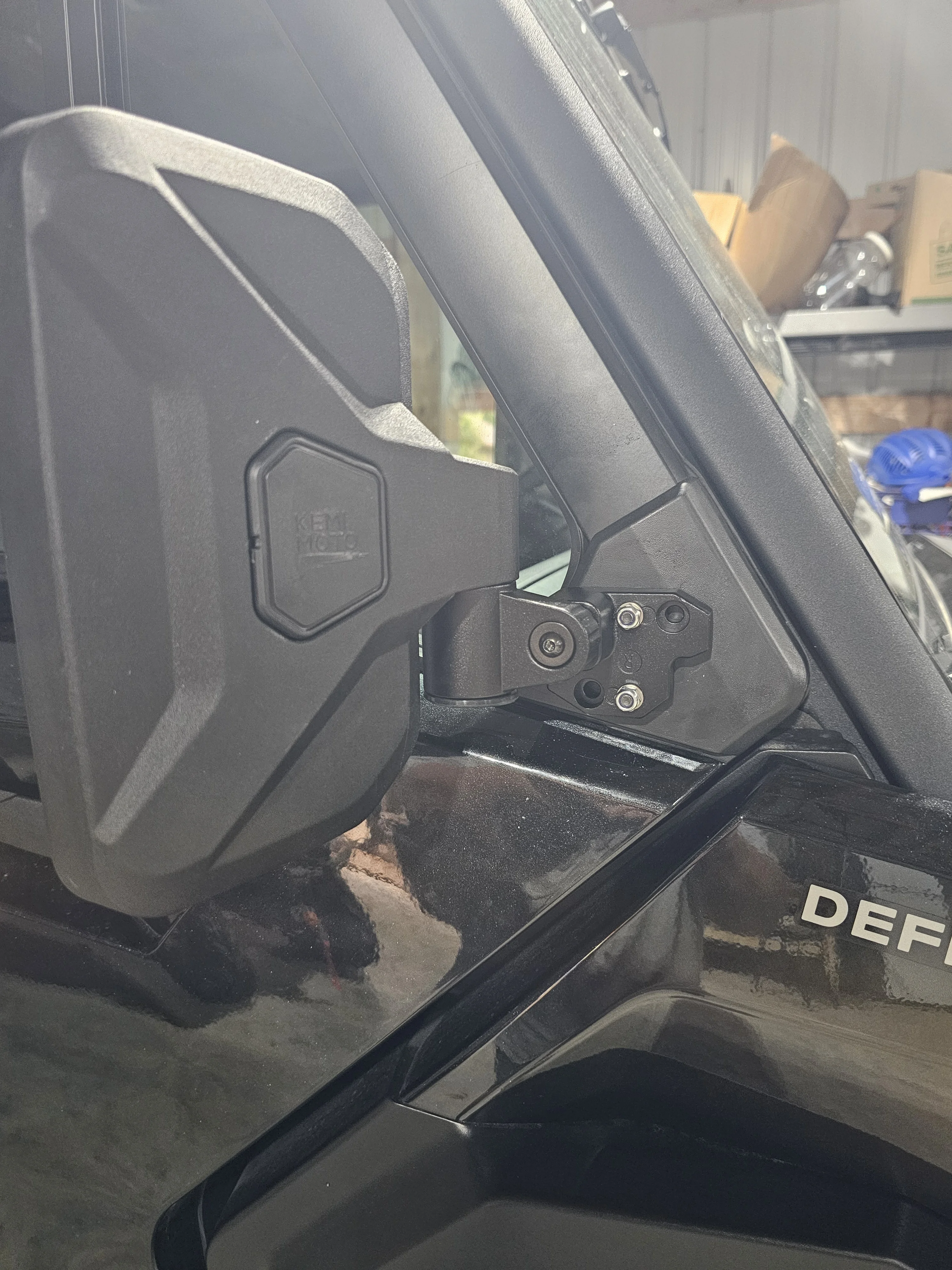

Well I took the plunge and ordered a set of mirrors for a 2024 Defender Cab model. They of course weren't plug and play but were almost. I used the two screw holes in the door for Factory mirrors but had to slot the holes just a little bit. Looks good at least to me, I probably will find some black acorn nuts for the outside to make it blend in better.
