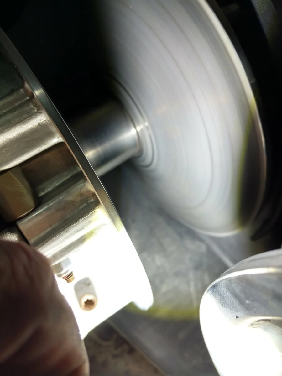

I just put the old belt back on and I'll keep the new one until i need to change it.  I'm no clutch expert, but I have a feeling I'm going to be by the time I get this resolved.  One of the things I noticed was the belt looked a little loose before i removed it.  I was thinking it should be a somewhat tight so when the primary clutch engages it hits the same location on the belt.  I can't find any spec on deflection so maybe it's not an issue or maybe my secondary isn't holding the belt at the right location.  I also noticed a polished location on the primary that seems larger and better defined than the clutches I've seen in pictures.  Anybody know if this is normal?(See Photo).  I'm thinking the looseness of the belt is letting it flop around and cause this.  I guess I need to buy the tools to remove the clutches and see if anything is out of ordinary.  Another thing I noticed was that the new belt i put on and drove maybe a 1\4 mile had the cord wore down noticeably more in about 3 spots on each side but they weren't directly across from each other which makes me think there is something not functioning right with this clutch.
wow, that's interesting. I'm really surprised that this issue has gone unnoticed and unfixed by Can-am.  I don't drive less then 10mph that often, but when I do it would be nice to have a smooth ride.

If I remember correctly, the belt was always loose on the primary side of my RZRs. It was the secondary that gets squeezed tight all the time. There is a break-in period on new belts so that they wear in evenly. I'm almost to 40 hours on my Defender Max and the jerkiness has gotten much better. I'm thinking the belt is finally breaking in. Also, I noticed the jerkiness initially is tied to the machine being cold. It's like the v-twin is extra lumpy when the engine is cold and that combined with the electronic throttle seems to make the clutch real twitchy. Once everything warms up my Defender runs a lot smoother.
