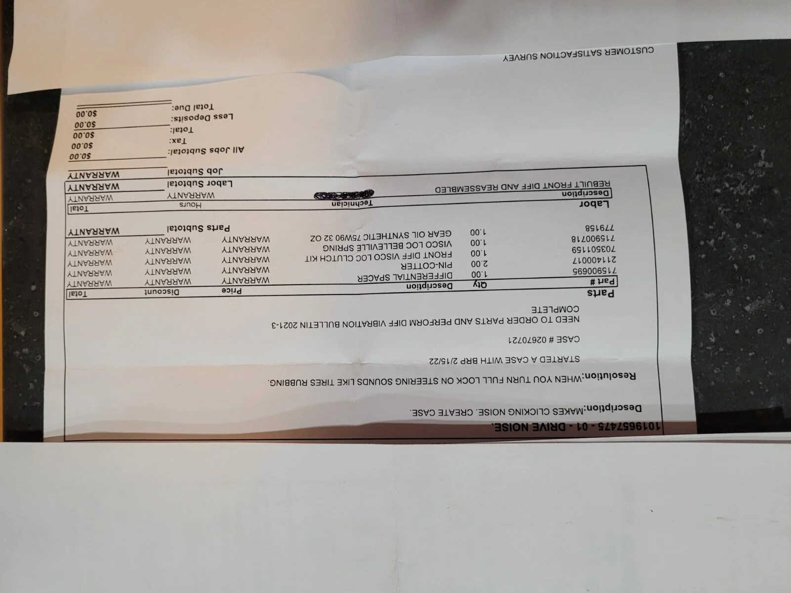

Purchased 2021 can am defender limited. Had growling noise full turn left and right. They repaired under warranty. Just picked it up. Hopefully no more issues. Here is the reciept on what they did.
