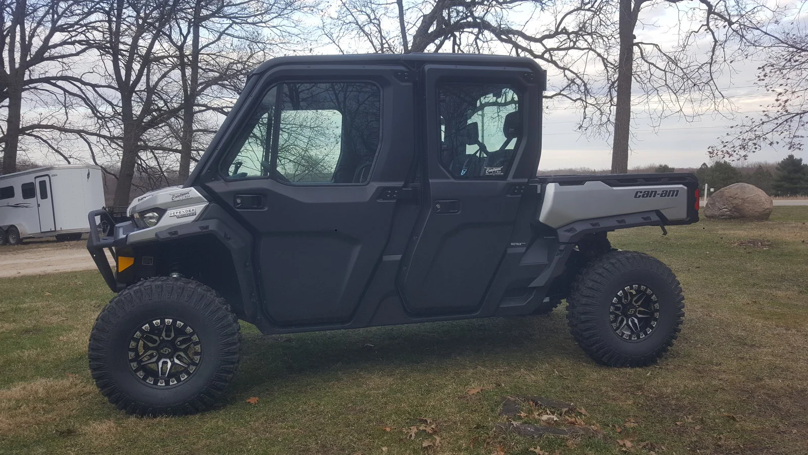

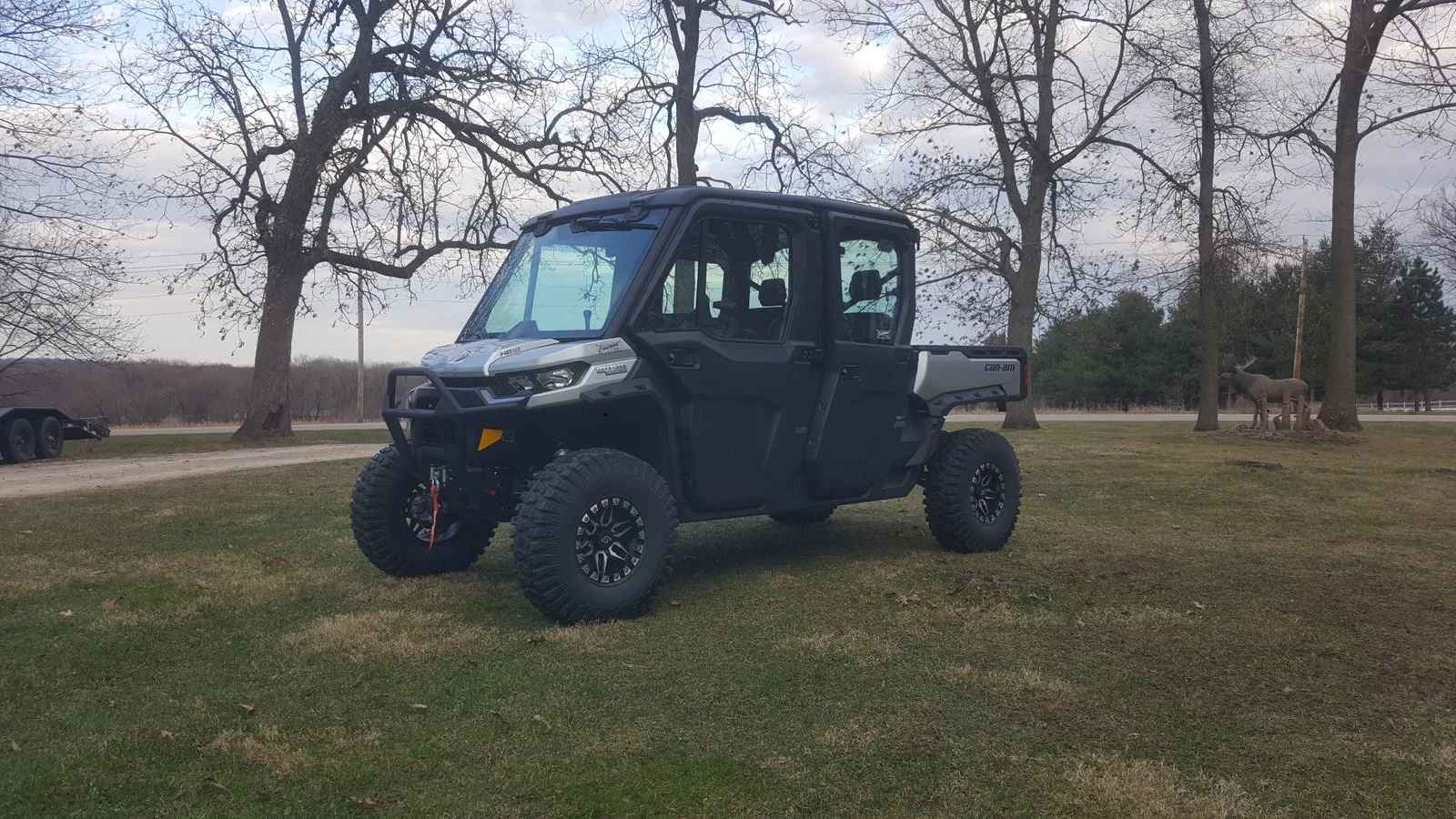

   I just changed out my stock rims and 27" 'big horns for a set of Sedona Split 6 bead lock rims and 32" Rock-A-Billy tires.  Each new tire and rim combo weighs in at 53 lbs.  The stock rear rims with the bighorns weighed 46 lbs. each.   So I figured I might lose some speed with the increased rotational mass.  However I was pleasantly surprised.  The machine still gps top speed on flat ground at 67 and will now run 70 down hill.  There is obvious speedometer error now but it also cruises better at 50 to 55 mph.  The new tires and rims fit fine even with the shocks on the softest setting.  No rubbing any direction lock to lock on the steering wheel.  The new tires are as quiet or quieter than the factory wheels.  I do notice a little more steering wheel wiggle at certain speed but I have not tried to balance each of the new tire/rim combos yet.  The machine looks as it should have from the factory.  Now it look properly proportioned.  I am sorry for not having pictures yet as it as dark when I finished tonight.  I took it for a 16 mile drive on the blacktop roads around my area and I can say I love these tires.  The power steering is not as strong (obviously) with the bigger tires, and there is slightly more road feedback in the steering wheel.  I am running 12-14 psi in the tires right now but will try up to 20 to see if it improves drivability even more.  This combo is going to be a hot ticket, looks and rides great.
     I wanted to let others out there questioning what would fit and what would not, to know that this setup works great.  I will post picks soon.

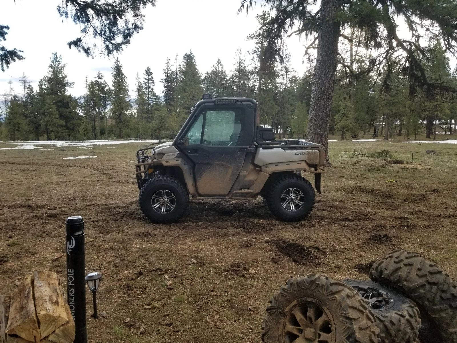

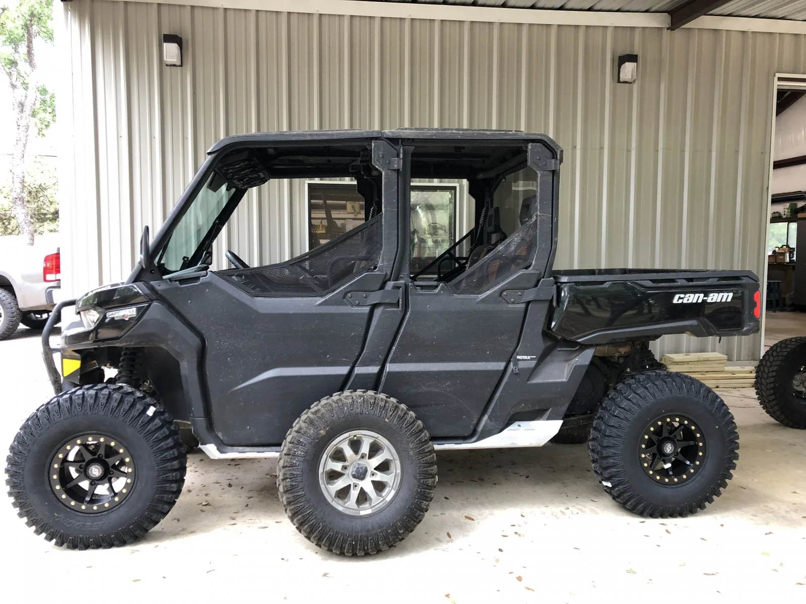

Toolboy, that is a nice looking rig! Those 32’s fit perfectly!

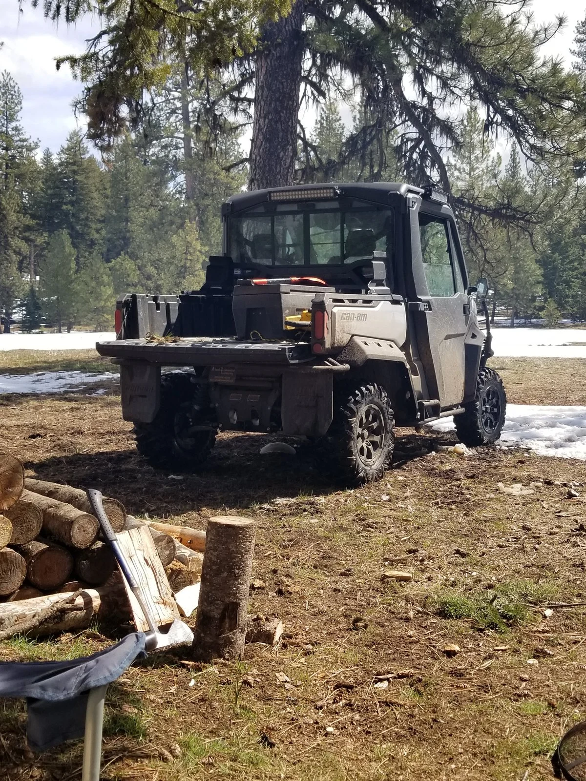

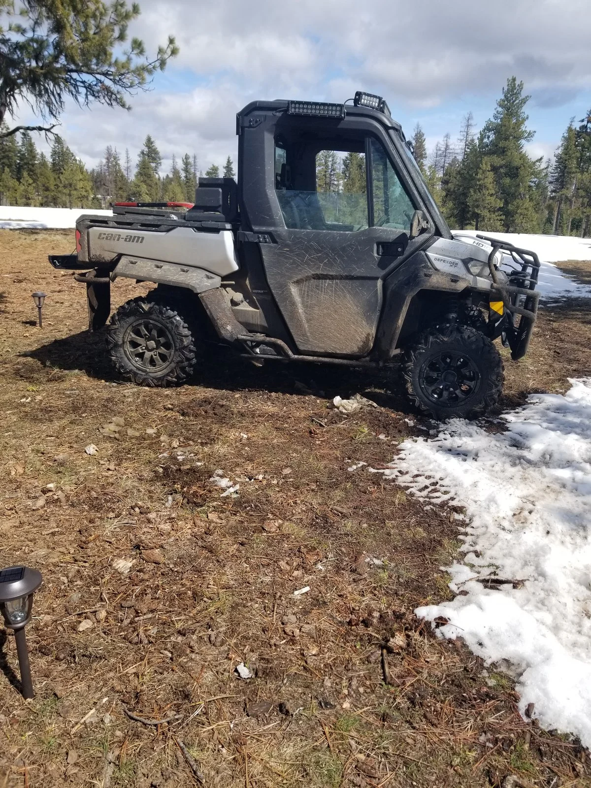

Hoping this is as painless as they make it sound. Because I will be doing this swap in the woods. Luckily I have a 20lb Co2 bottle to set the beads... But I  always carry a full lineup of tools when in the RV. So thinking I got this! Here's Bear as a before picture here in camp.

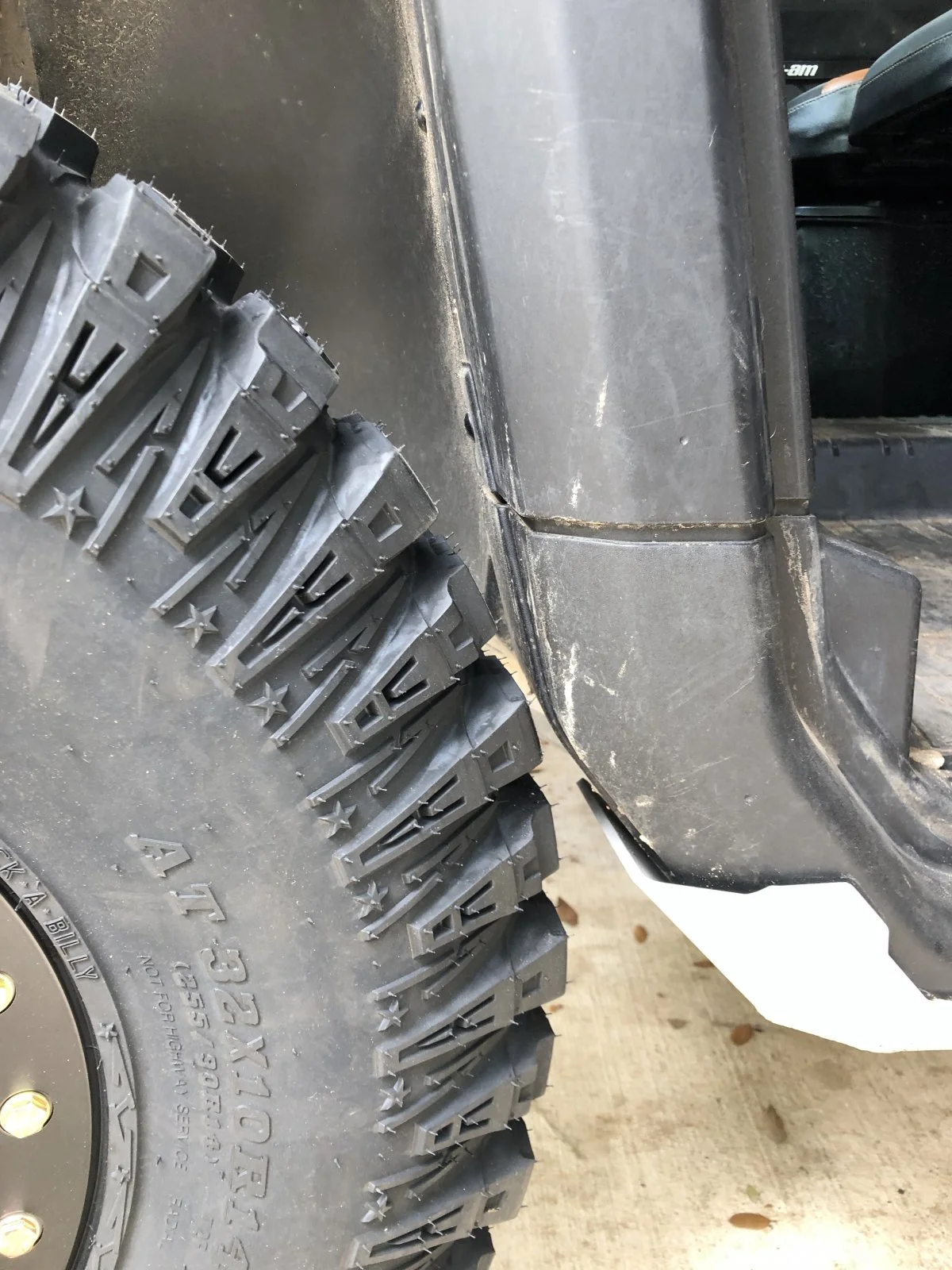

Well, tires and wheels delivered to the local RV  and motel here in NOWHERE.... Mounted/aired up/ mounted....(in the woods) Now for the forward A arms.... but I'm gonna run them like this unil monday.... STOKED!!! I LOVE THEM!!! AND THE GC??? BOOYAH!!
Love the look but I was wondering if you had to use any wheel spacers on the rear.
Nothing on the rear. With OEM A arms I had to tweak out the bottom of the flare with a wedge of wood and on the downward roll hard on the suspension, it will rub. But I've got the 2" forward arms, just haven't put them on yet. I'm in the woods hunting. Although I did mount the tires and wheels here. Let it be known I have added a Battle Armor 2" lift. (which I  happen to have another... long story) but NO SPACERS

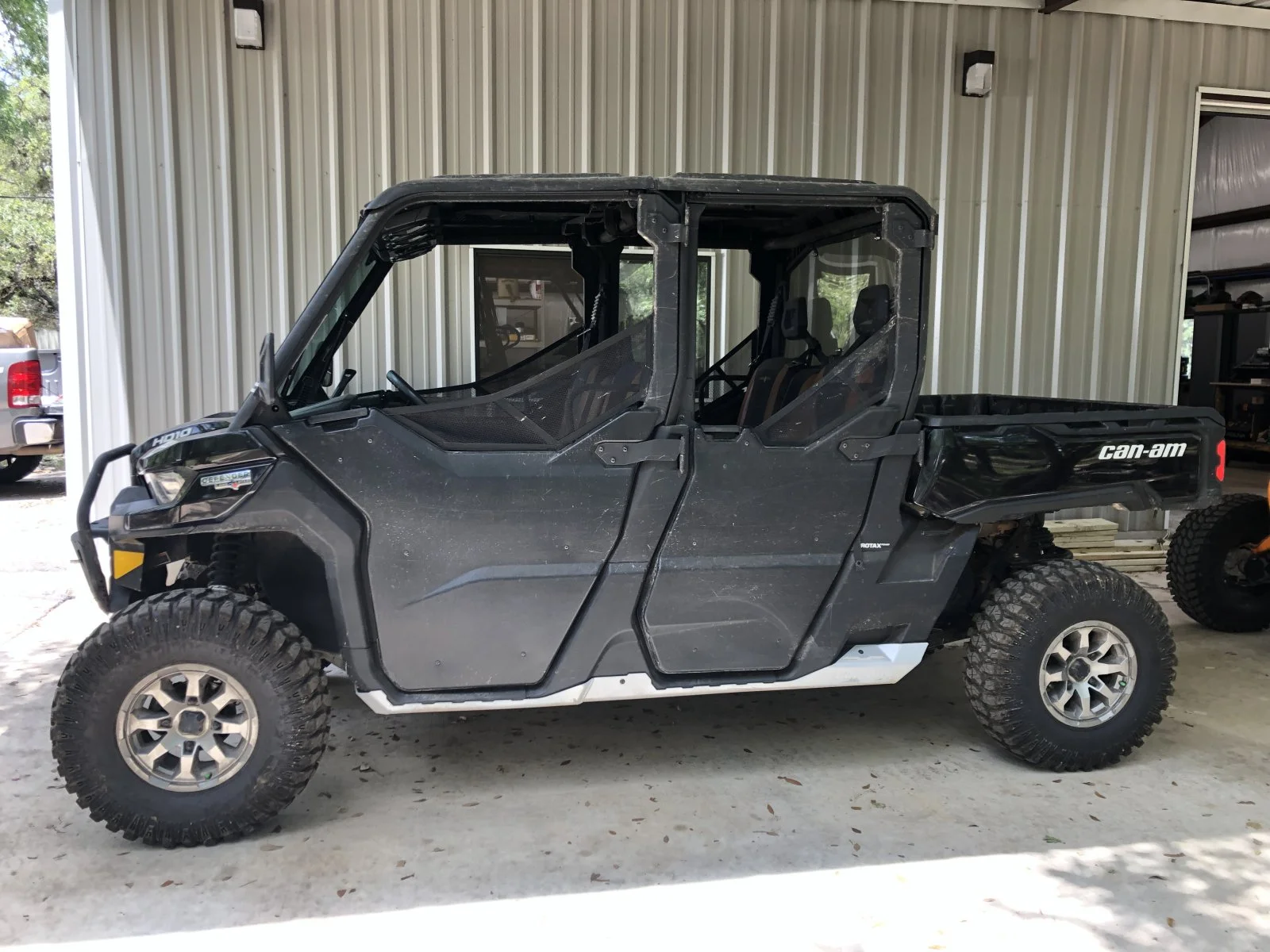

Well, had some extra time and bought yet another grease gun. (Mini sized) and installed the A arms. LOVE THEM!! #superatv Rides smoother on the gravel roads. Seems to handle the corners a bit better without wanting to swap ends.. and the wooden wedgy is gone with PLENTY of clearance. Could have gone 34's if not for the rancher bumper. Oh, and it looks BAD @$$!!!
