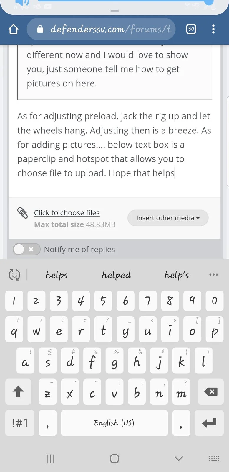

I am running 7 in wide 14" rims on the rockabillys.  All wheels are interchangeable  and rotatable.  How do you guys upload photos, is there a host site you use?    I have been adjusting the rear doors as they needed it and I can tell you it is no big deal to do it yourself.  Don't get ripped off by a dealer to do it.  Can am did it right and you just loosen the bolts and retighten when you get it where you want it, you don't have to take the inner door apart at all.    The tires fit great and I put a 2 in lift on the rear to give it the correct stance.  Now I have about 14 3/4" front clearance on side and 15 1/4" rear clearance on the side, both are slightly more if you measure on the front and rear of the machine.  I also can't seem to adjust m coil preloads as the wrench that came is the wrong diameter and just slips.  I would like to add one click to the shocks for just a little less body roll at high speed.  This machine looks totally different now and I would love to show you, just someone tell me how to get pictures on here.

As for adjusting preload, jack the rig up and let the wheels hang. Adjusting then is a breeze. As for adding pictures.... below text box is a paperclip and hotspot that allows you to choose file to upload. Hope that helps
