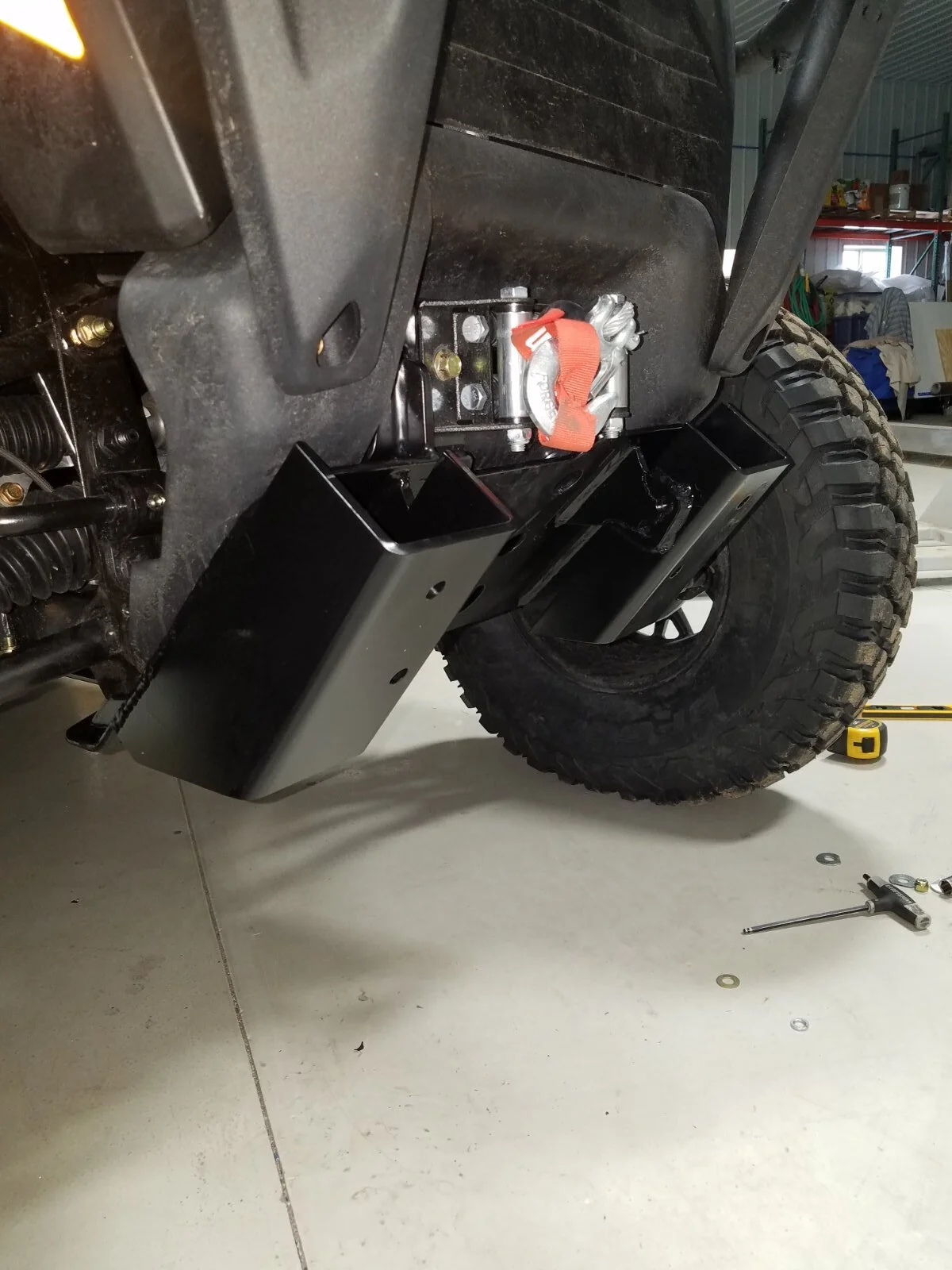

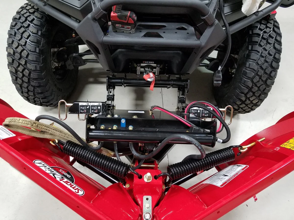

Well I spent all day installing the 78" Boss V plow today only to discover the during the final step that the bitch dont fit with the 2020 redesigned Can Am front bumpers. It hits the bumper prior to getting to the top pin location when you push the carriage back.
I had called Boss a few weeks back to verify if everthing would fit and they said that it would work fine. I'm pissed that I either have to wait for a fix from them or weld up a 1" extension to make it clear ok.

 I had to make custom brackets for the plow myself. Boss would not supply me any brackets in time for the plowing season.  Their design team told me they had no fix for it and it would be months before they would have a solution. = shitty!
With the 30" tires and KM3 springs you will need to push the plow forward approx 2" and lower it approx 2".  If you dont lower it the pitch of the plow doesn't work correctly when you angle the plow in and out. The same effect would occur with any v plow setup if you ran it with tracks.

Yes, I personally gave the Boss's engineer the specs, pictures, and the offsets that they needed to change... That change Im sure occured last spring sometime. They couldn't supply me the revised parts in time because of what they called "testing". I had to make my own to be able to plow since I wasn't going to wait around. Lowering it was required as well so I'm glad I did.
I ran my plow setup with the stock springs at max last year. This year I went with the heavier springs and its much nicer now. The front dont drop 3+" when you lift it anymore The plow is HEAVY I wouldnt even want to run stock tires with it myself. When you have it all the way in scoop mode vrs V mode the mounting height comes into play.
