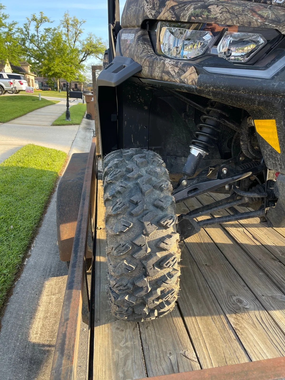

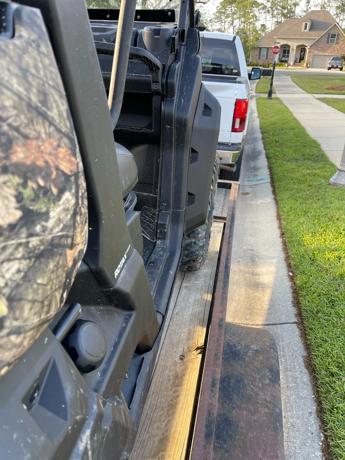

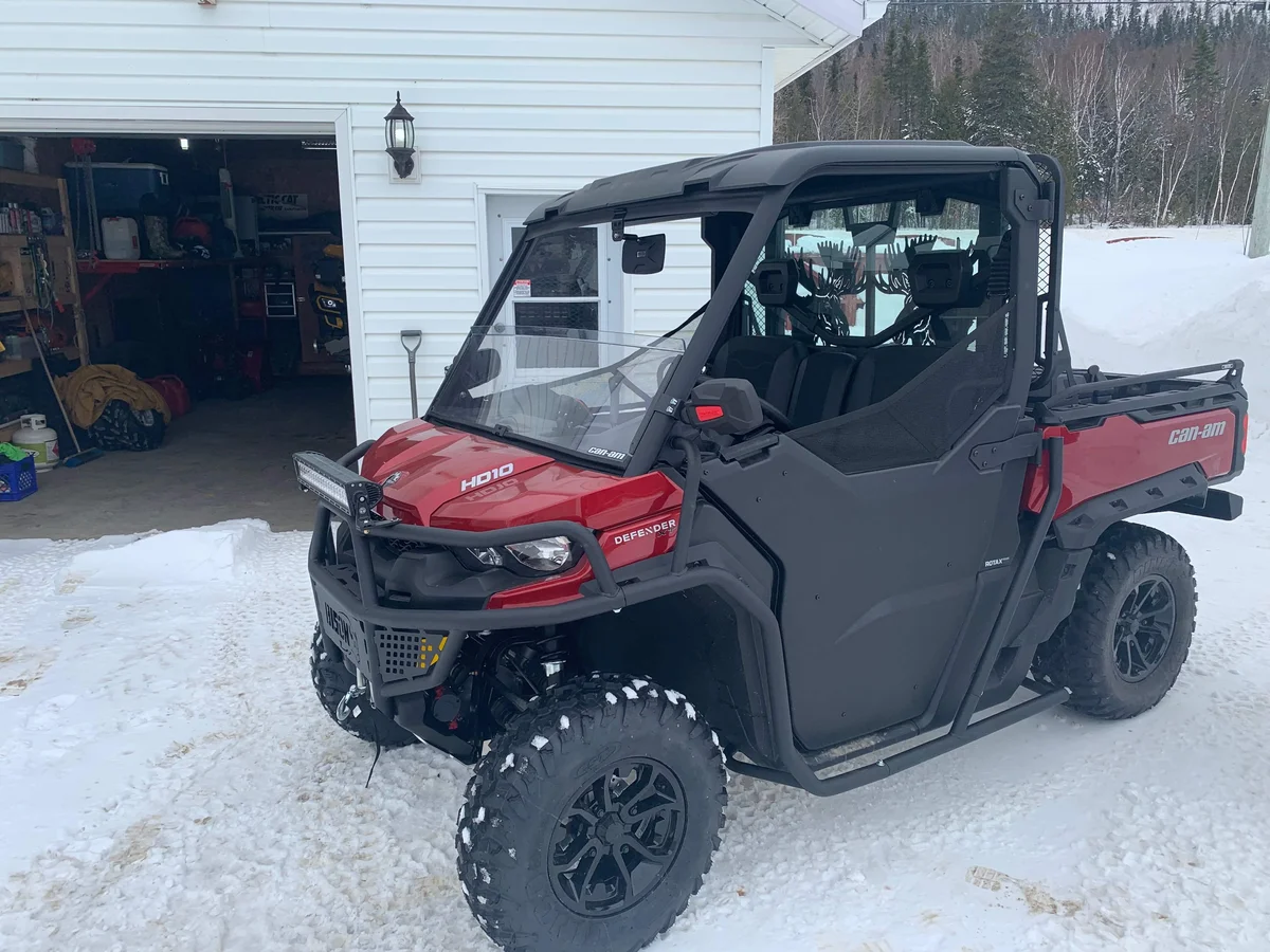

Yes.  No experience with them in the mud yet yet but they look like they should help.

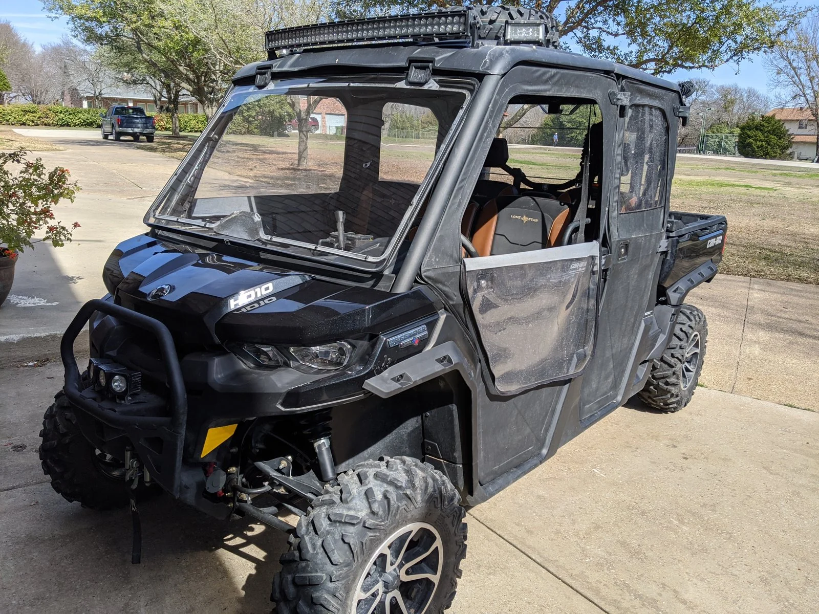

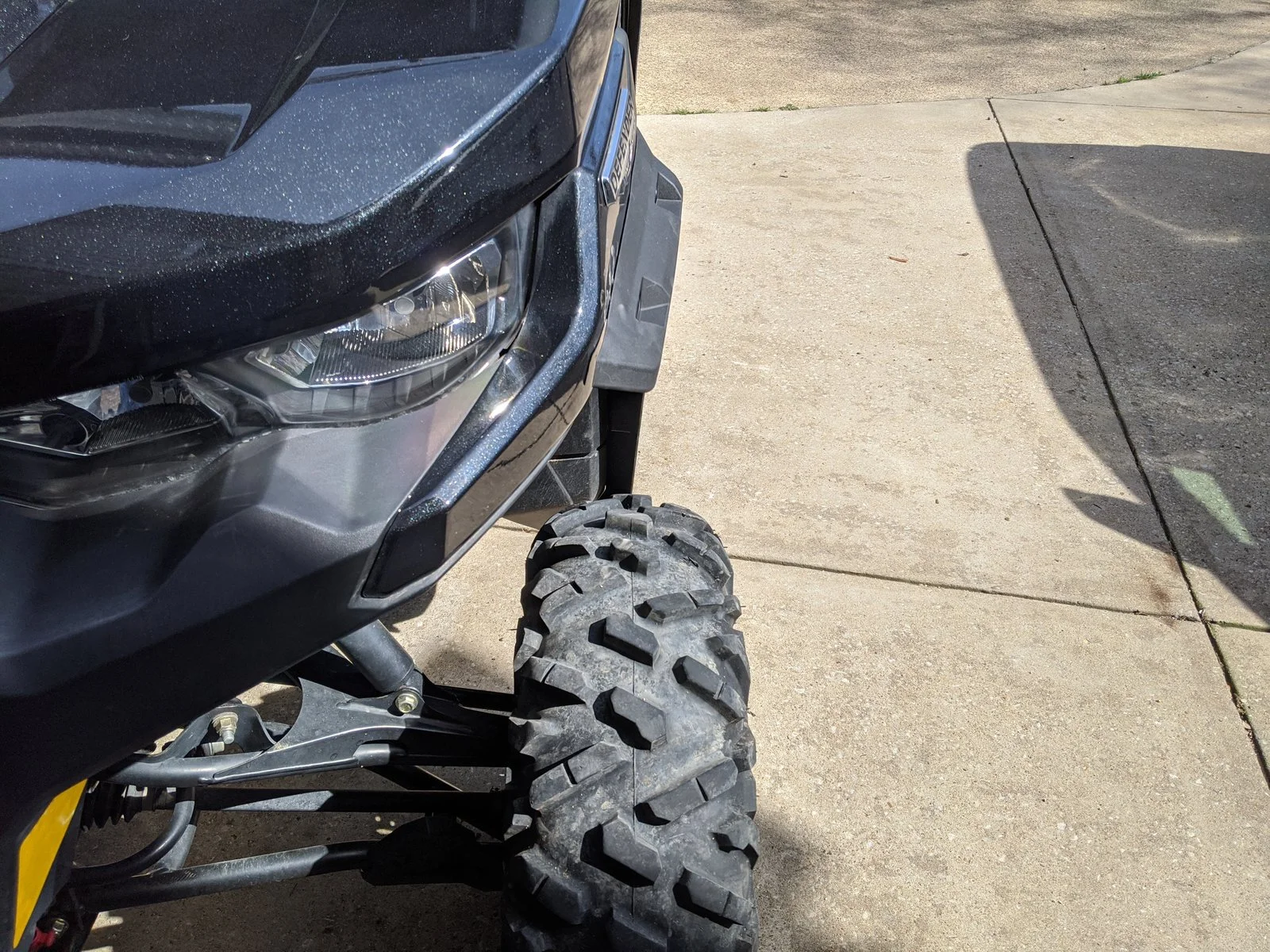

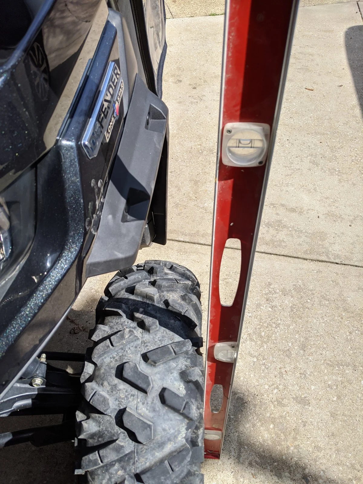

I’ve done exactly that and it looks good. The wider front flares helped the mud some but still throwing way too much in the side of cab. I now have some half doors on order.

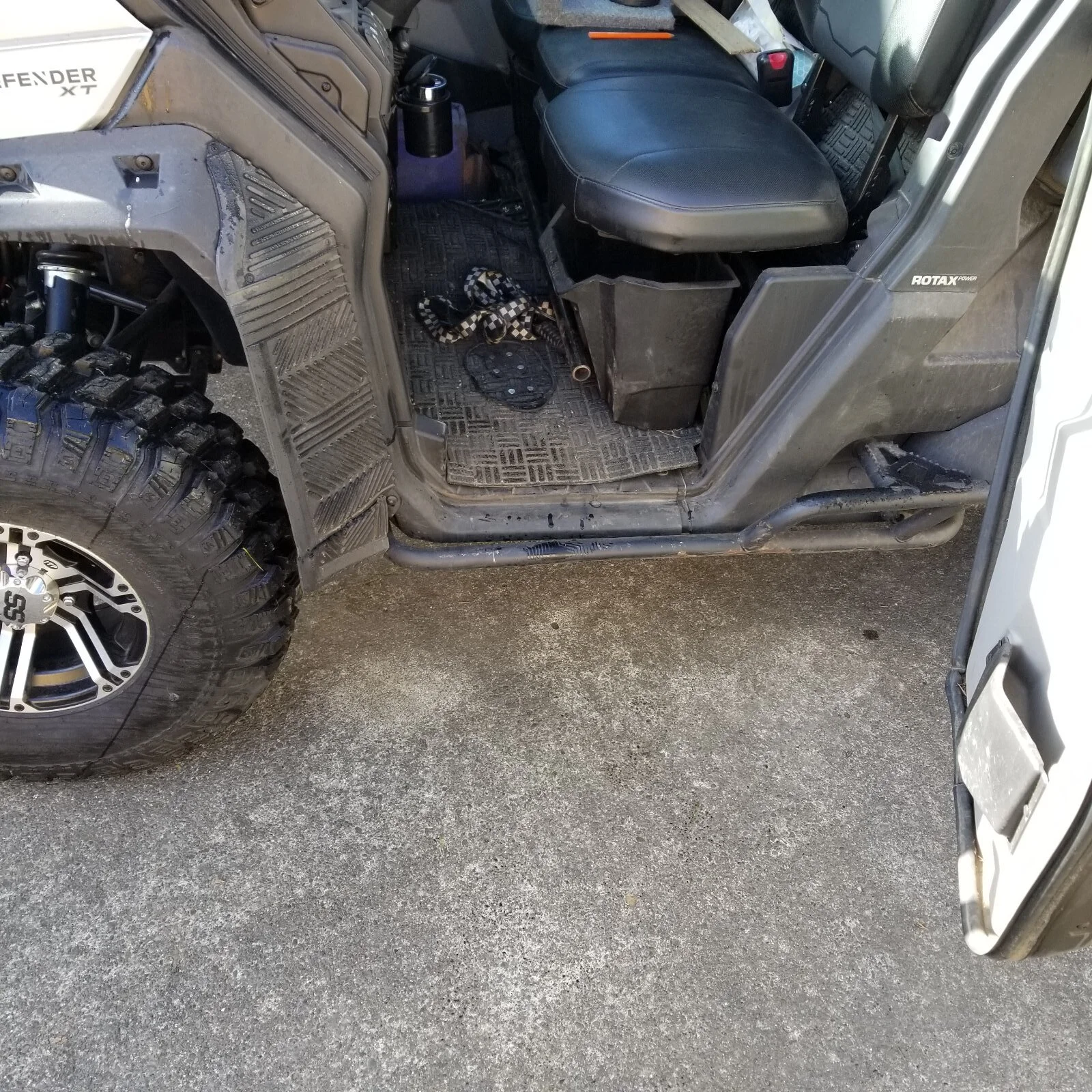

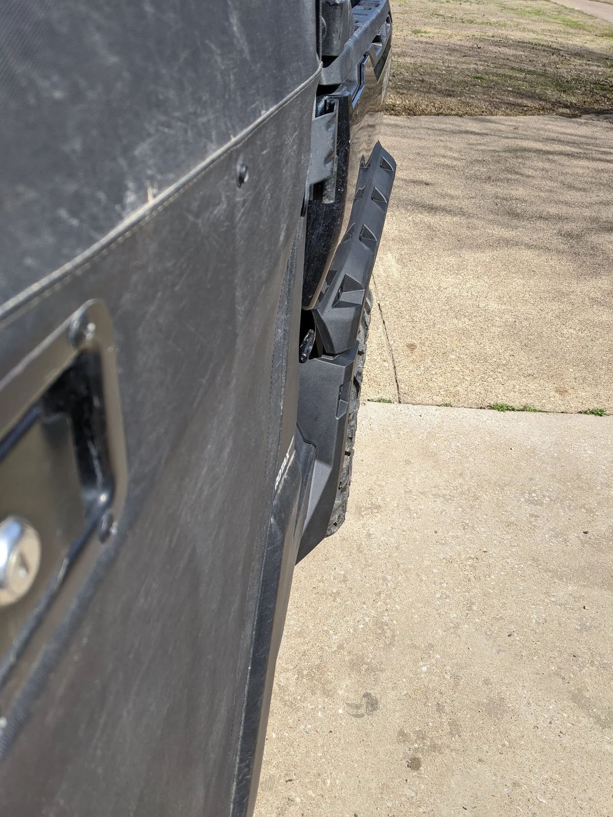

I have actually added extension flaps on my fronts... Plan was a semi flap for them but couldn't find one at the time... so a minivan rear carpet cover was what I had to work with.... and it has done the job PERFECTLY!! I'm also running a 33"×10.5 so he throws a bit of mud when he's diggin'. They have stayed flexible, not cracked, and were CHEAP!! I had a bit left over that I added a 2"or so flap that hung below bear attached with zip ties.
My plan was to replace them... but they've worked perfect.... and kinda grown on me.... so they stay until they need replaced.....
Good luck all!!
Edit... since this picture I've also modified my sidebars by adding thicker tubing and widening to the width of the front wheelbase. Which helps keep some of the spray below the doors...
