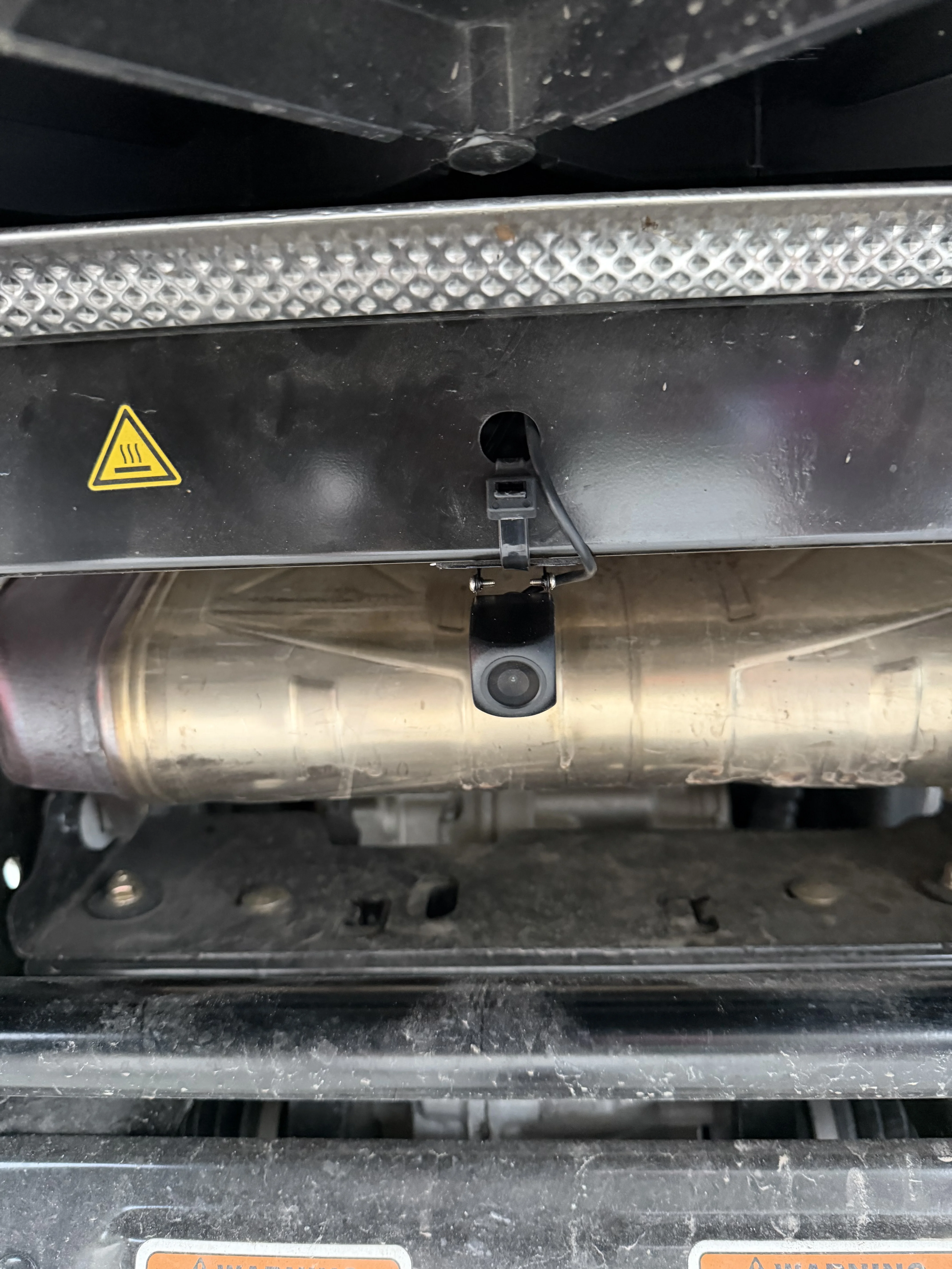

I have a 2026 HD10. Wanted to throw a cheap CarPlay into it so I picked one up from Amazon.
It came with a reverse camera. Reverse camera has a video cord and one small red wire. The red wire trips the camera to automatically display on the screen. Like a vehicle. The HD10 does not have a reverse wire.
I installed a $6 limit switch. Wire the black to the 12v positive and the blue to the red camera wire. Leave the red out.
I cut out a small hole, to the right of the shifter, in the dash and hot glued it in.
Works great.
