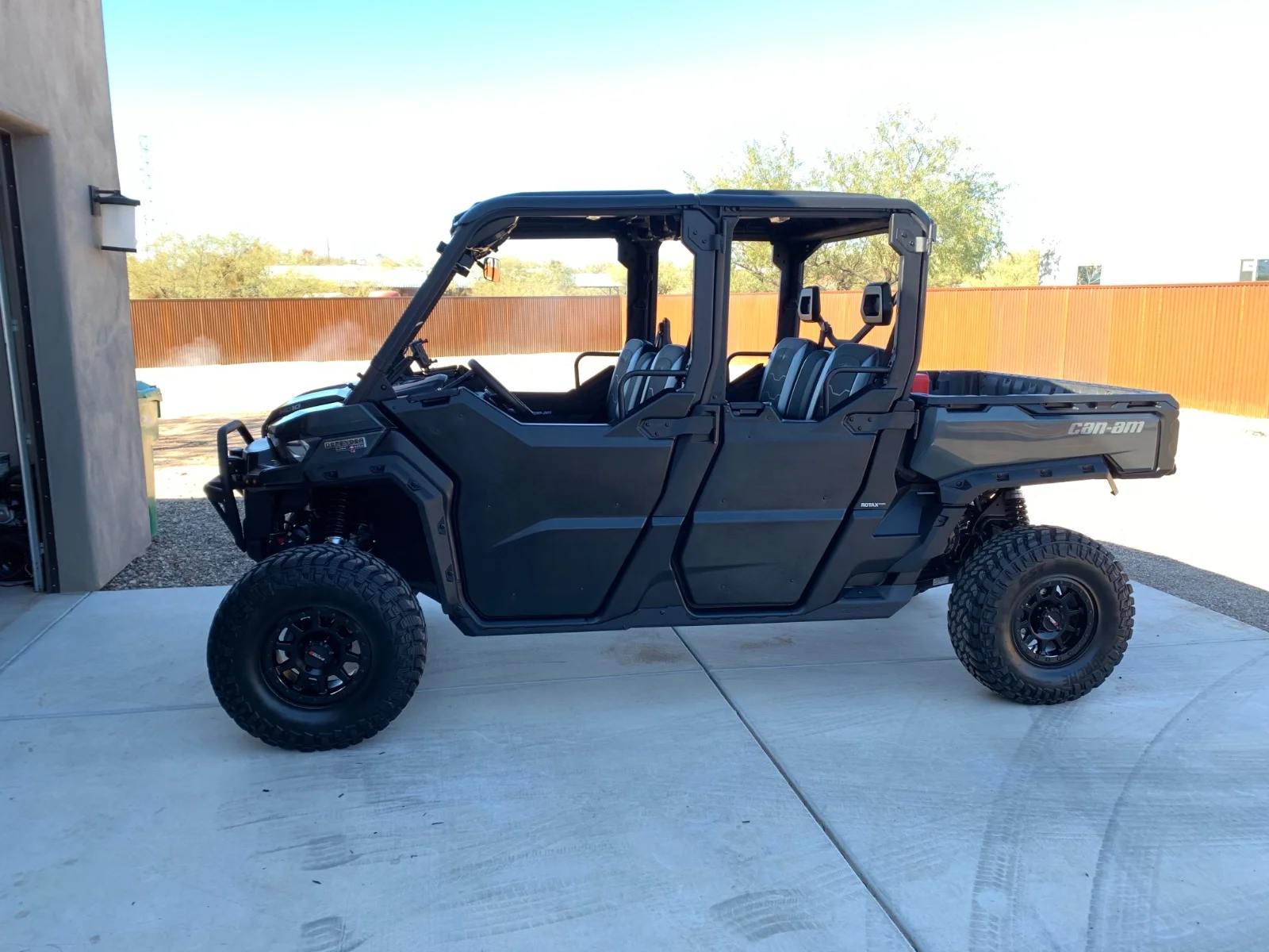

Quick build update!
Added the factory half doors this weekend. What a royal pain in the a$$ this was. Haha. Granted, my first door job ever. Still had trouble getting everything to line up correctly and gap/seal right. I know there was a part number update to these doors for the 2020 model year. Both front doors went on fairly smooth. Everything lined up good. The rear doors, not so much. This door kit has an metal piece that runs up the rear of each door and has a hinge up high that mounts to the top of the cage. On the rear doors, if the door was square in the opening, the metal bracket wasn’t. If I squared up the metal bracket with the cage, the door wasn’t square in the opening. Took a little extra “engineering” and tweaking, but it’s all done!

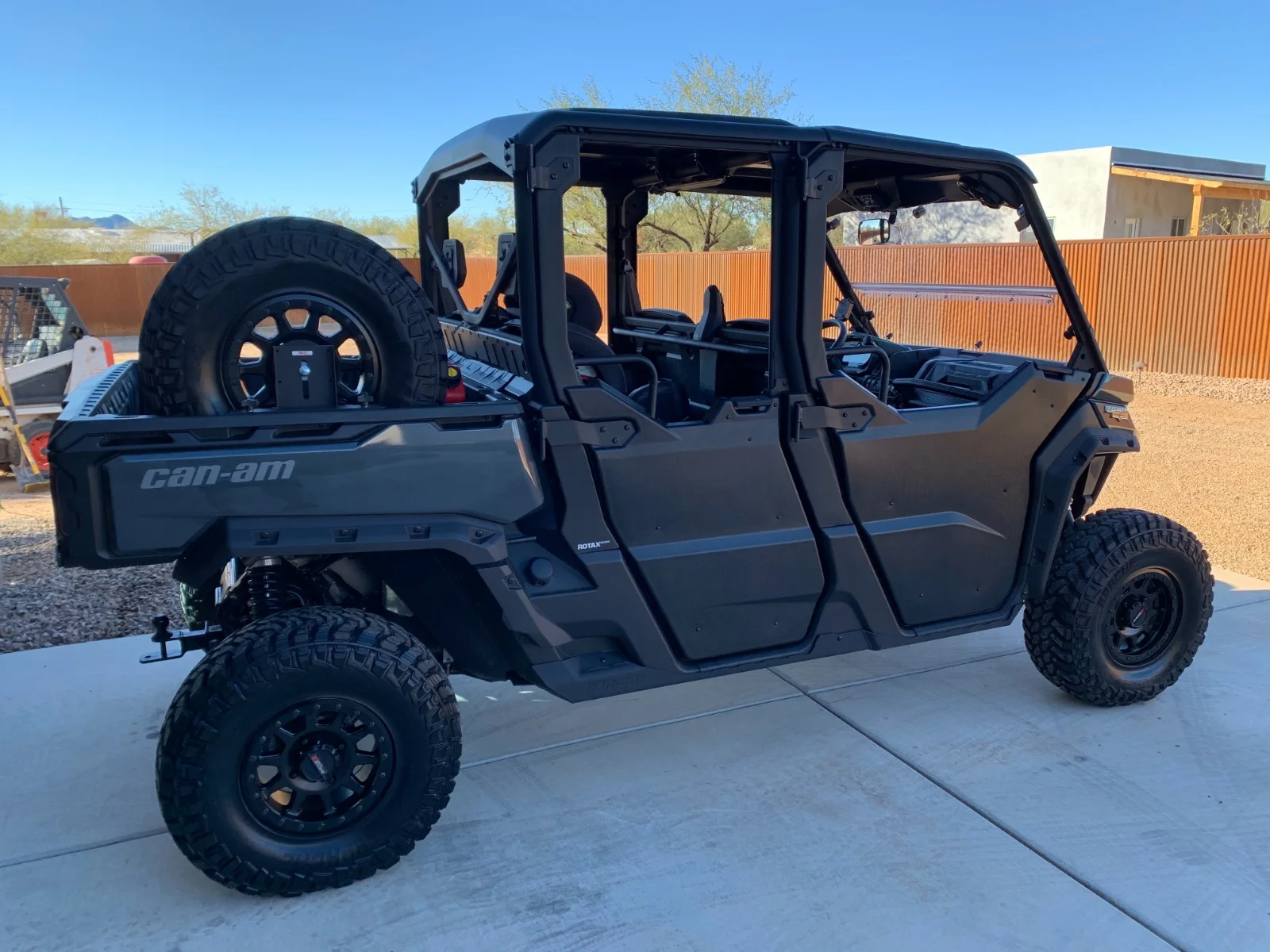

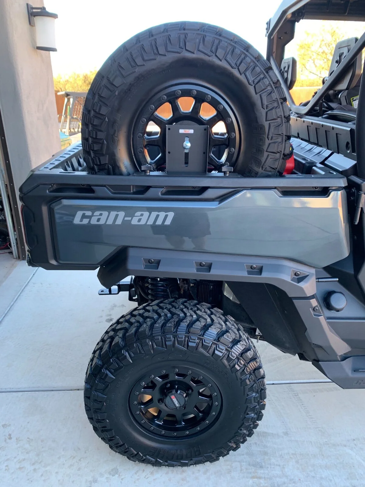

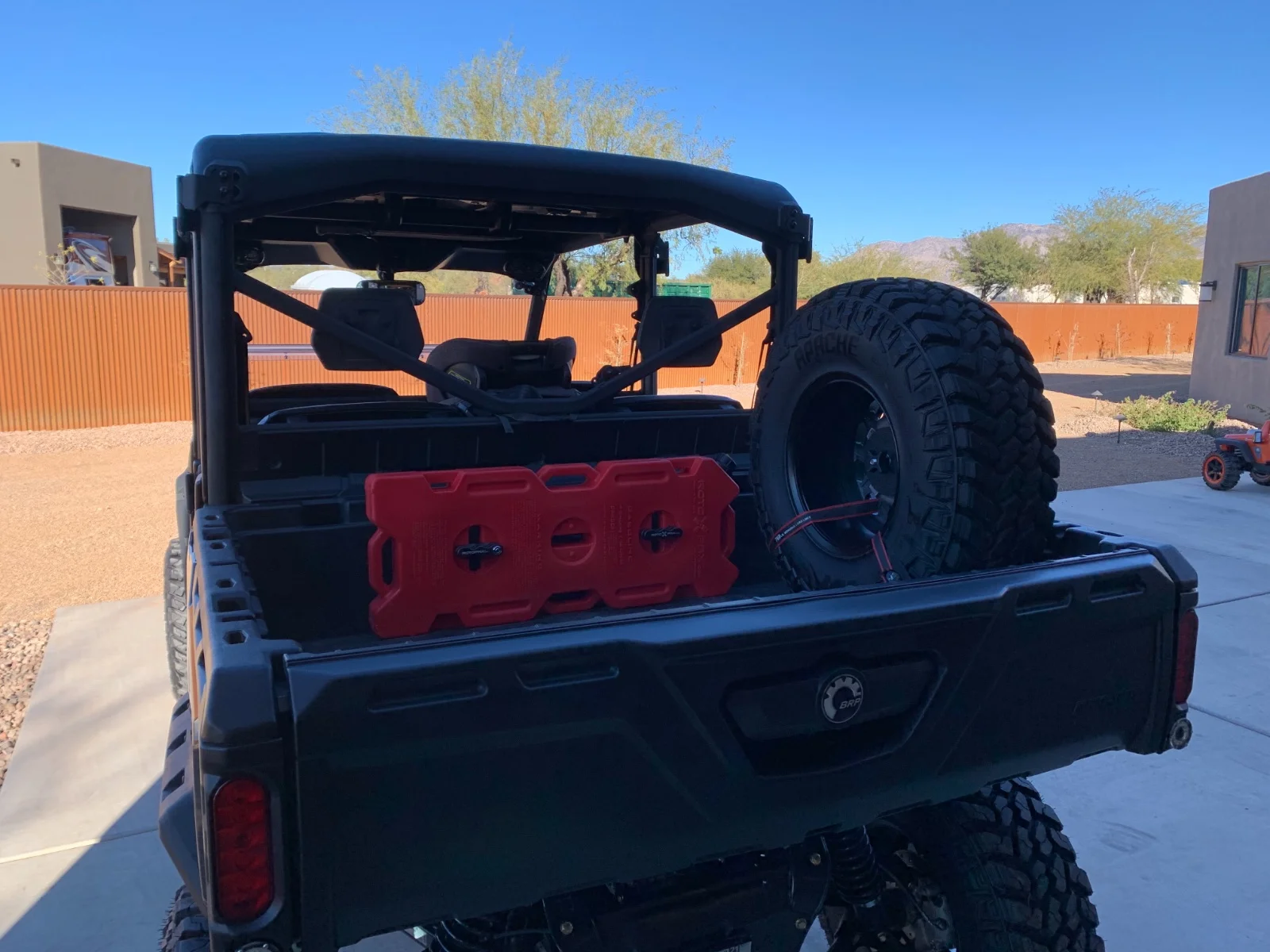

Added a full size spare. I went with the Hornet mount and it’s pretty solid! Added a strap on the bottom to add some stability to the setup.
Thank you! Been a while since I have been on here. Yes, the tires clear with no rubbing at all.  Let me know if you have any other questions!

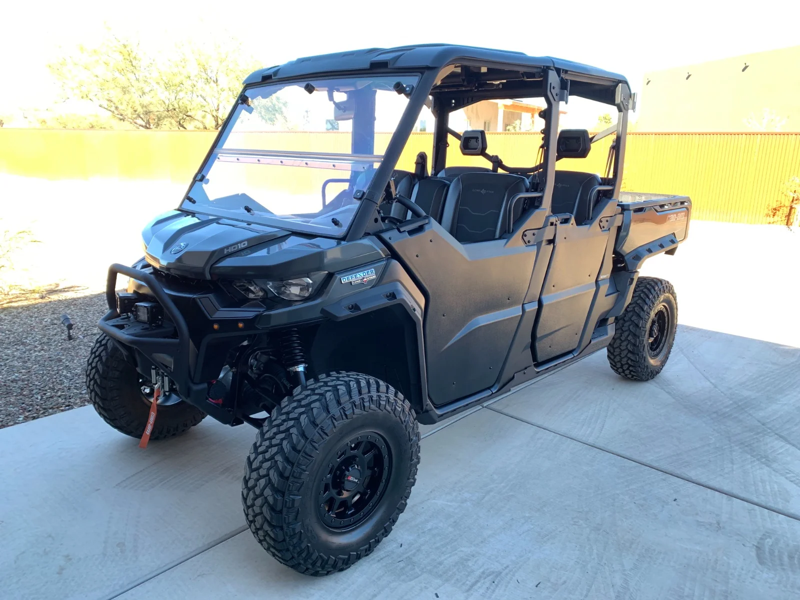

Yeah this is great content. Sweet setup by the way- hands down best one I’ve come across. I have a Lonestar on order and should be here in March. I am looking to do pretty much same tire and wheel set up. Haha the only thing I’m nervous about is ensuring that the rear wheels/tires align with the front wheels/fires. I’m guessing the 1” spacer is the solution?
Thanks Jason! It’s been a lot of fun building it to this point. Wheel and tire setup I’m running have been very impressive. I would recommend this combo to anyone. I run them at 8psi. Yes, the 1” rear spacer got my wheels as close as possible to the same width.

Yeah your exactly right! Sold my commander back in September knowing we needed a rig with more seats... it’s been a lonely 6 months. Haha with the 5-2 offset, what’s the total width? We’ve got a few trails here in Utah with posts buried in the ground to limit wide vehicles like trucks and jeeps.
Just measured it... 68” front and rear. Maybe add an inch or so to both sides for tire sidewall bulge. I would say no more than 70” true overall width.

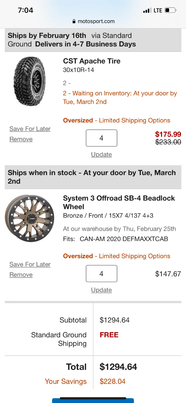

I was considering the System 3 RT320 tires or the CST Apache on the System 3 SB4 bronze wheels with 4-3 offset. Haven’t seen them in a 5-2. Did you pick up OEM spacers for the rear?
Did you run the Corbin lights yourself or have a dealership do it? I’d like to learn, and save some money, but don’t wanna screw it up.
Good looking combo you have picked out!

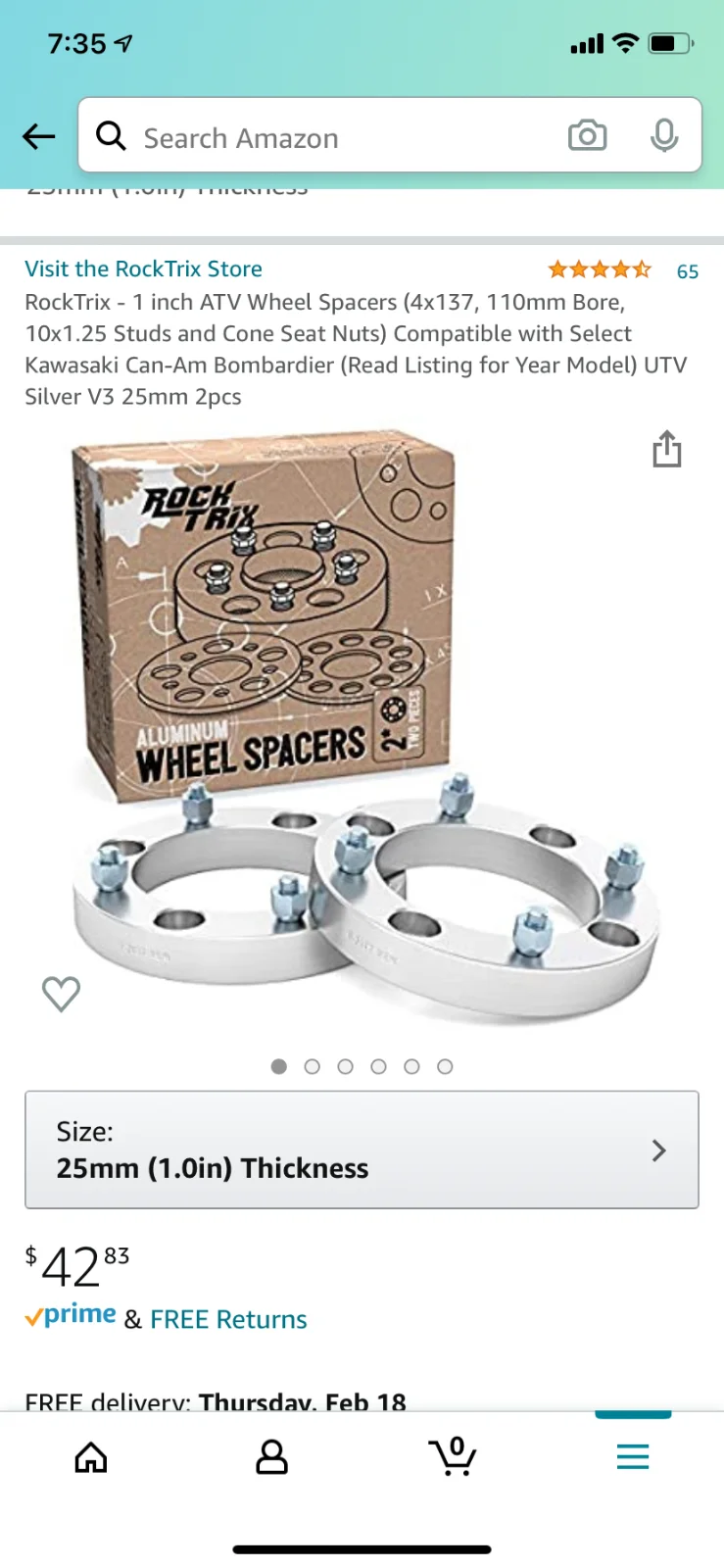

I didn’t know can am had factory spacers. I used the rocktrix brand. Found them on Amazon.

Awesome. Any specific spacer recommendation? I think you had a 5-2 wheel offset but the 4-3 should require the same spacer I’d image.
It should use the same 1” in the rear for yours to even it out. Your machine might end up in the 70-72” range with the 4+3 offset. I posted a picture in an upper post of the spacer I used. I don’t know if you saw it or not. Keep us posted as you get everything put together. I’m excited to see it!!
