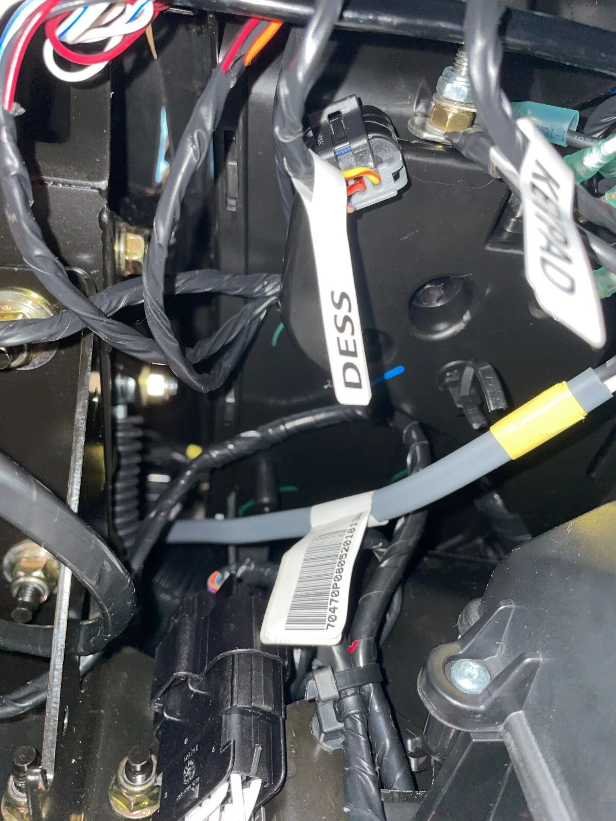

Dealer said there is no security on it but there is a harness with a DESS tag on it that is under dash.  There is no ball and socket locations for one to go though.  It just looks like a standard key.  These are pics of under dash.
Did you have any issues with the voltage sense not working?  Have to change any setting other than crank?
I just unplugged the DESS plug and it goes into a empty socket so it must just be there as a option.

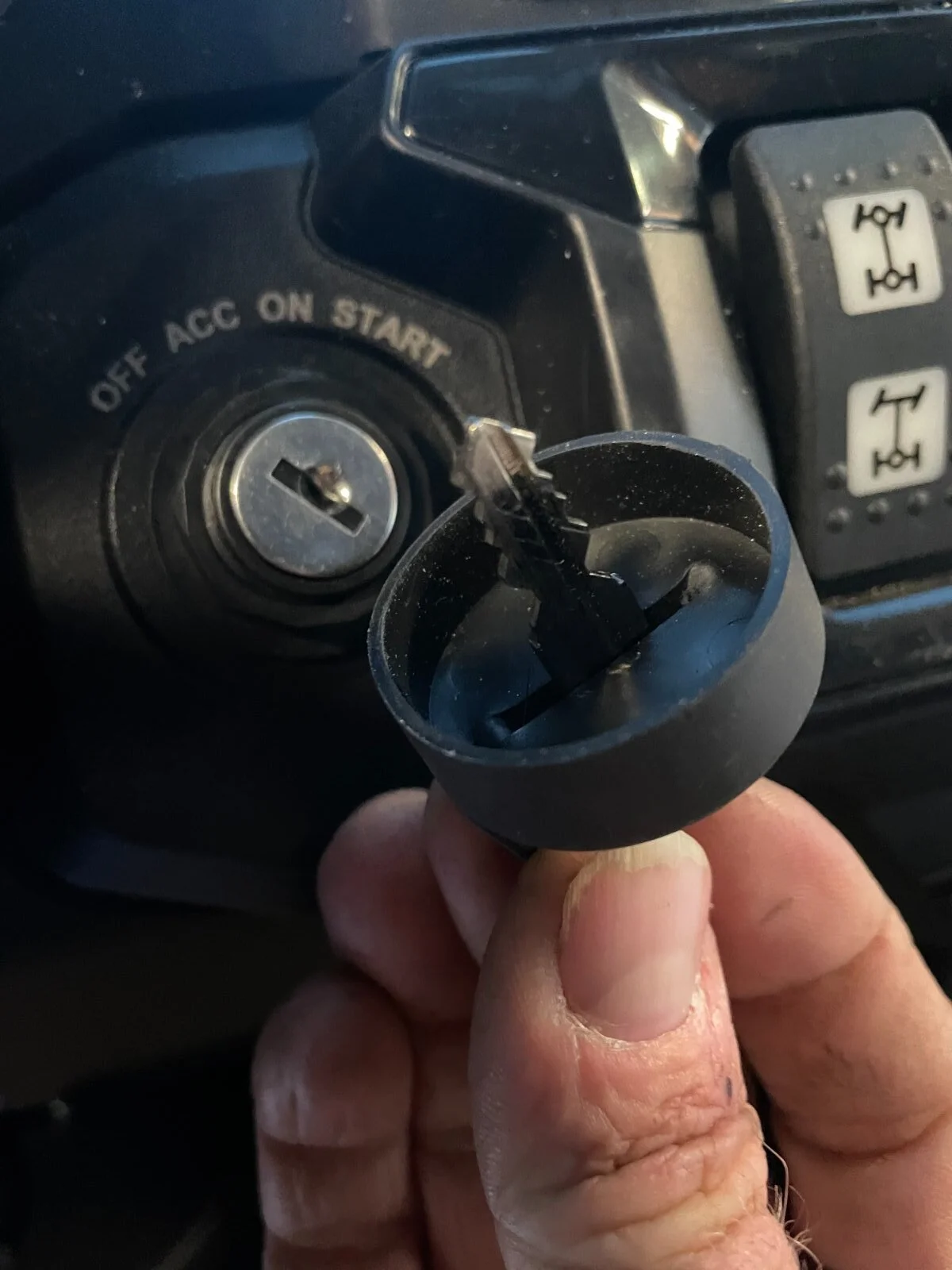

In all my years of remote starts in vehicles I have always found if it is a transponder key issue it will not even crank.  Not for sure what to do till I get my hands on another OP500 to try some different options.  If I could find a tach wire I could try to program it without waiting for a programmer.  Thanks for your help though.

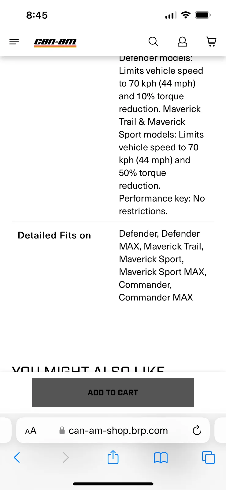

Looks like they sell it now.
