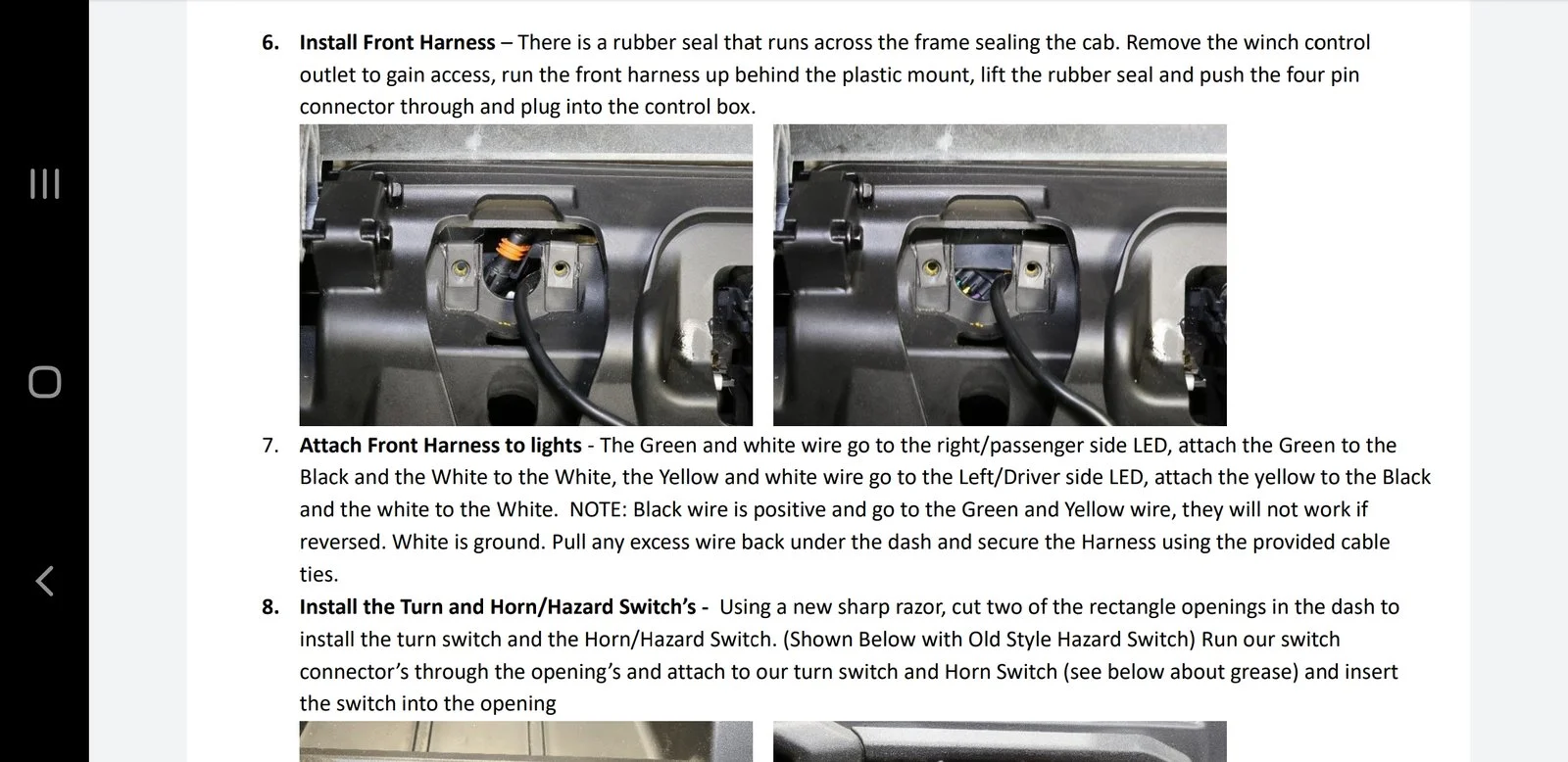

N Nekelneh New member Joined Aug 16, 2019 Messages 28 Reaction score 2 Apr 13, 2020 #5 Ok, i figured that one out! Now im searching for the winch control outlet referenced in this pic. Any help?
