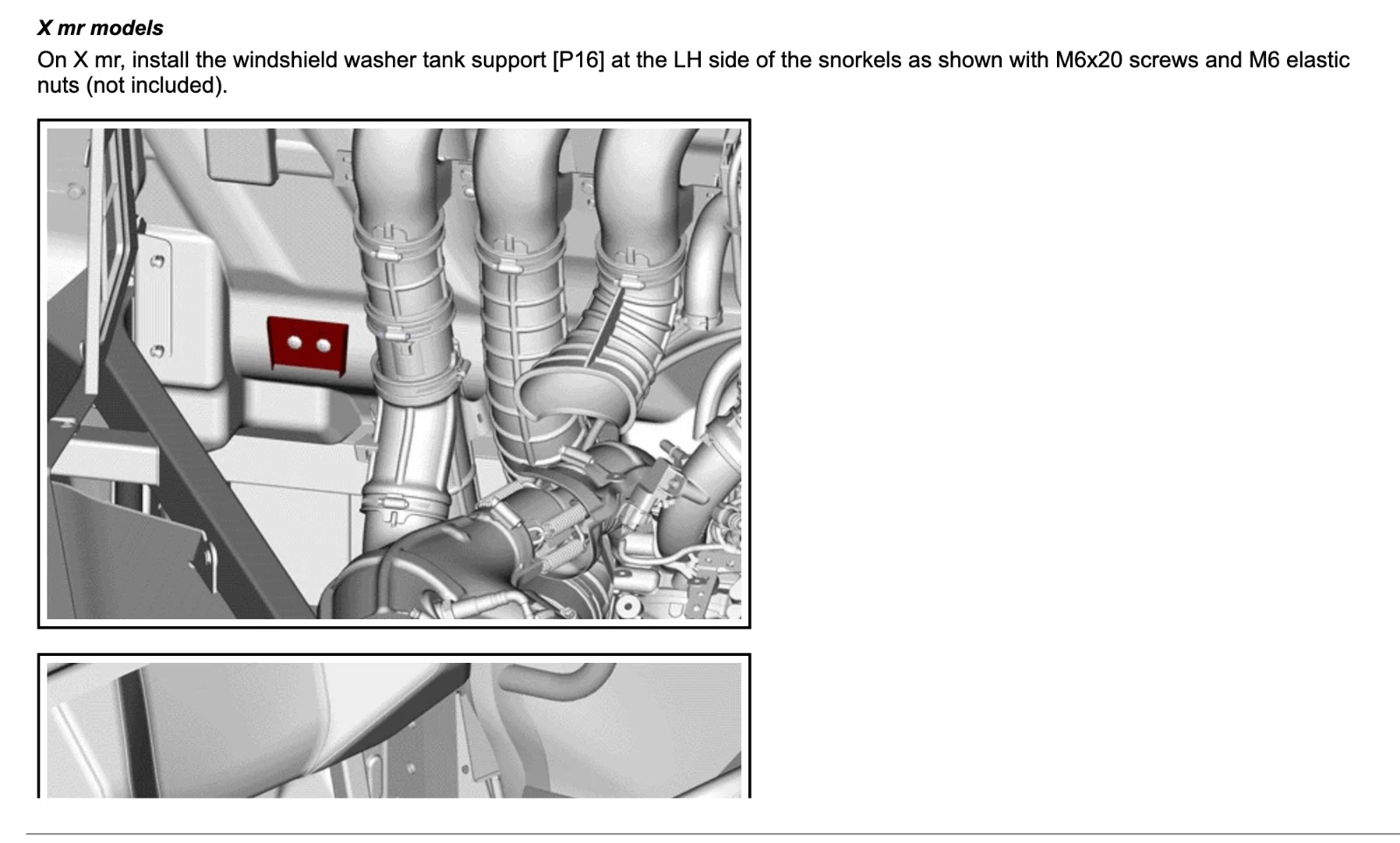

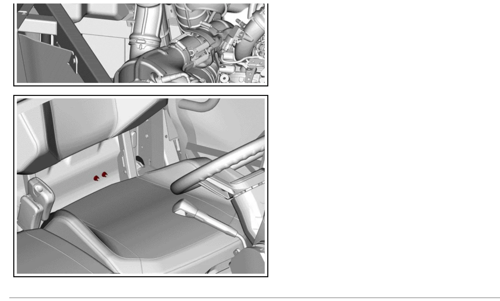

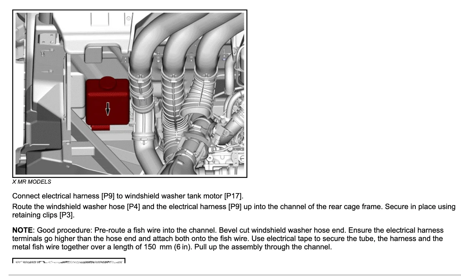

So, here I am trying to install a wiper kit on my Defender Xmr and came to a screeching halt when I went to mount the wiper fluid reservoir.  Apparently Xmr’s we’re not meant to have one because the snorkel kit could not be more in the way if they tried. Anyone have a solution and possibly some pics to go with their solution.  Thanks
I've install a few Cam am wiper kits on XMR's and you have to mount the reservoir in a different location to the far left of the snorkels. If your defender is 2020 and up and you have tracks with the CVT air intake relocation kit that enters the rear of the cab it usually makes the reservoir install tighter fit.

Perfect!  Thank you for the fast response. Much appreciated
