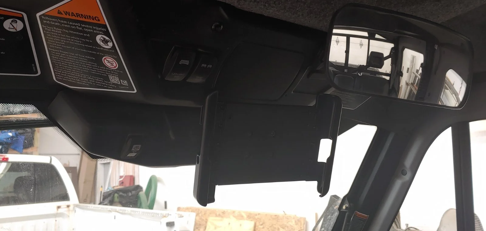

OEM Wiper module pictured, it sits on the glass and is below the header where the stereo would mount (this is from before I installed my Infinity radio in the factory location).
I went with an Infinity Marine radio with matching 6.5" Infinity Marine Speakers (4pcs), and got a set of rear speaker support plates from a guy on facebook. All said, about $500 total and it sounds decent.

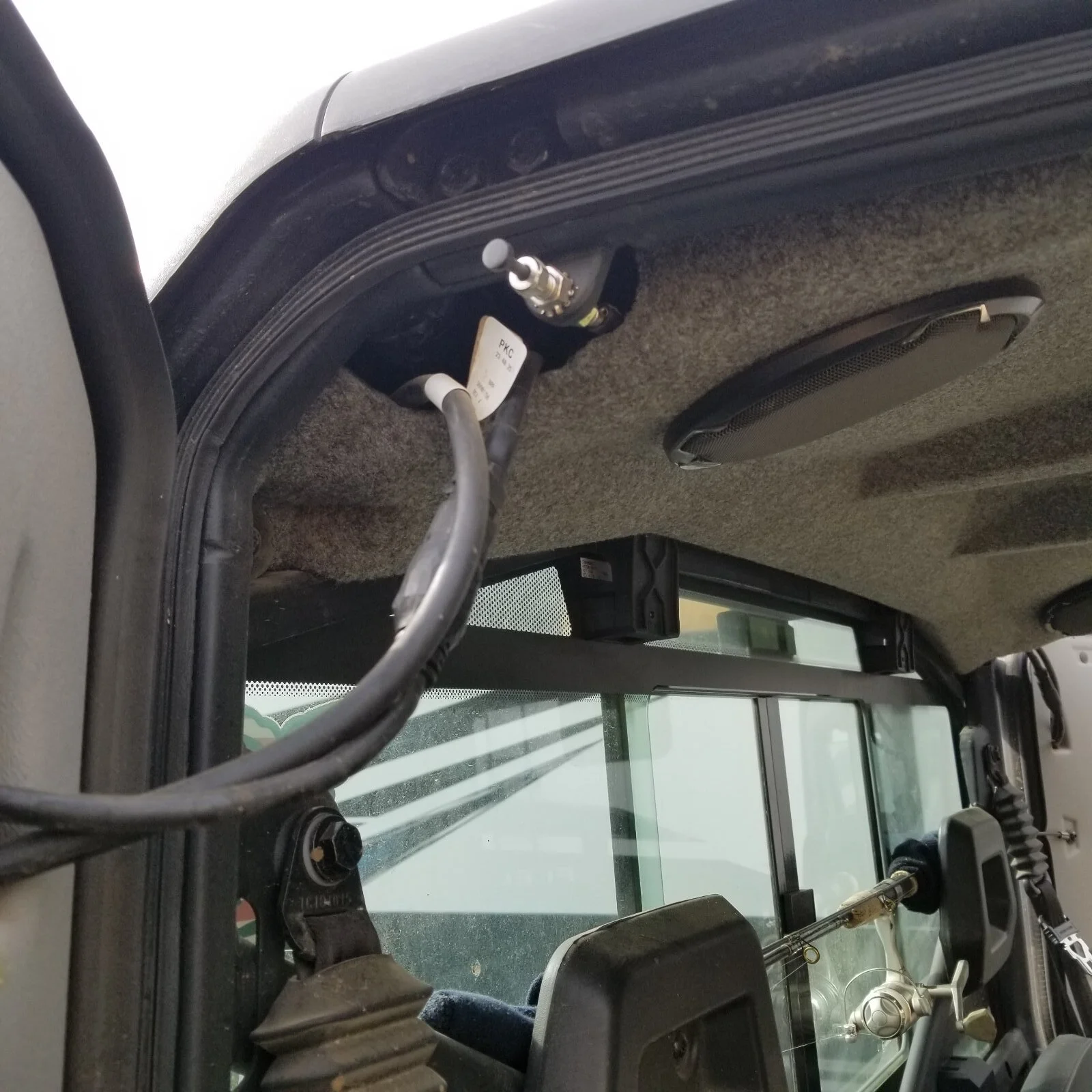

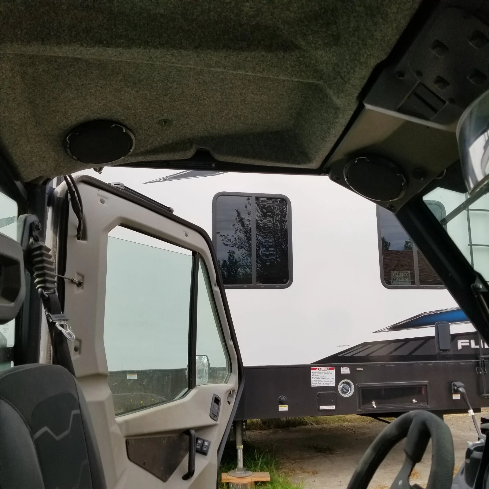

Wiper for sure!! Especially here in the PNW... I actually went with a SIRIUS XM stereo.. added some tweets to the front speakers and mounted my rears straight to the headliner.... (no supports other than a screw and fender washer into the roof) haven't had any issues with over 2000 miles on Bear.
Steelslinger did you have to cut a bigger hole in the front liner for the 6.5" speakers. Mine came with 5.25"  trying to see if I'll need to cut it later.
Are you using the front plastic headliner? If so, yes, I had to cut slightly outside the pre-marked circle for 6.5" speakers.

Here you can see the one screw and washer that holds up the liner from sagging... in the lower shot you see the door switch that operates my dome light...
