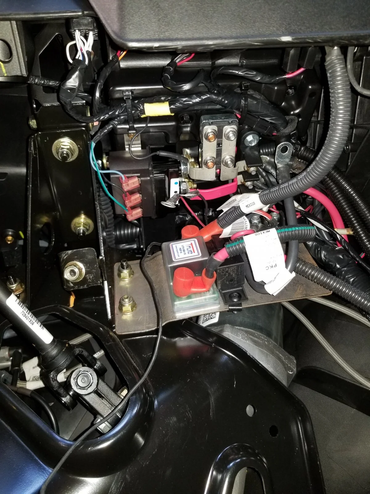

Well... not going onto a max... but I went with the SuperATV deluxe plug and play. Just got it after a backorder and my hunting trip TO HELL....

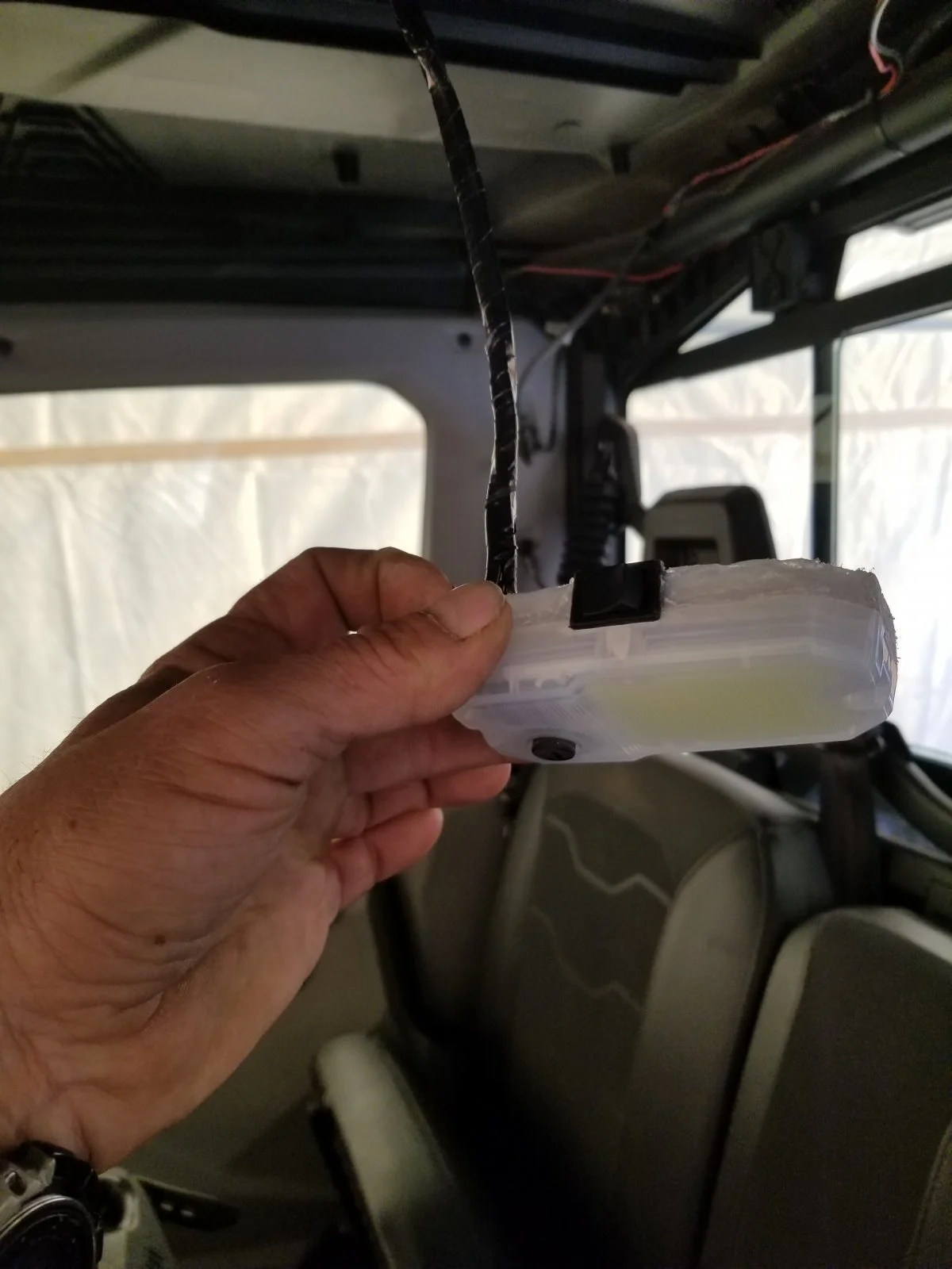

Hoping to get it installed next week. Trying to get things in order here at home first. But during a quick examination of the installation instructions it is powered via the under dash power block. Unfortunately in my case.... with the heated cab all that is pretty BURIED!!! Thankfully I thought of these type of things when I added another power block that I can access. And the brain? It is supposed to mount under the middle seat... Umm... I have a cubby there.... guess that's gonna need some attention too....

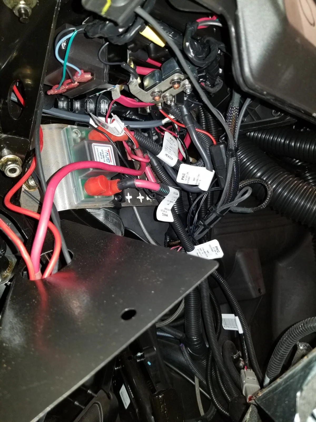

Well..... I made it.... a couple different options really. I just took a buss bar and made it live... I'll see if i have some pictures. My bar is CONSTANT LIVE.... Not switched like the OEM bar is. But I've gone WAY BEYOND the realm of easy... door switches, lighting, stereo, gps, more lights..... I also had to reconfigure the battery isolator system as well. Which is actually why I added the extra buss bar.

I have the new Can Am defender XTP HD10 (2020) and I am stuck where to send the front harness through the firewall. I watched the videos on you tube but they skip over that or different year cause there’s nothing easy about that lol.. any tricks out there to help out a fellow diy’er...
live tried to look for the hole the rest of the wires are going through but I loose them behind the plastic that seems to be held down with the fuse block and very little give to try and snake anything behind it.

There is a hole plugged with foam just in front of the door latch post. Behind the front fender... that was where I ran mine... let me see if i have a picture... No picture on file... if you need, I can possibly take one later.
