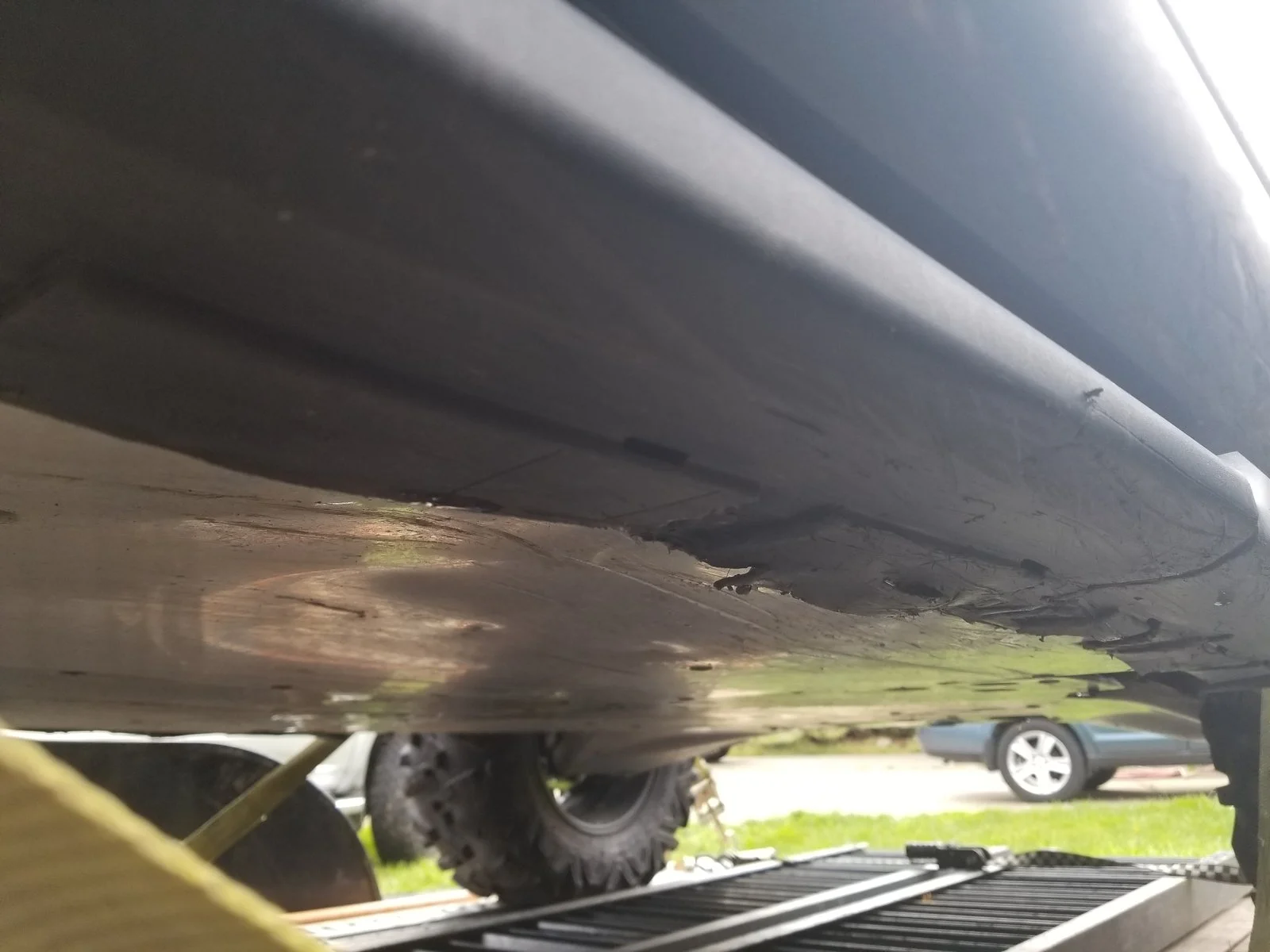

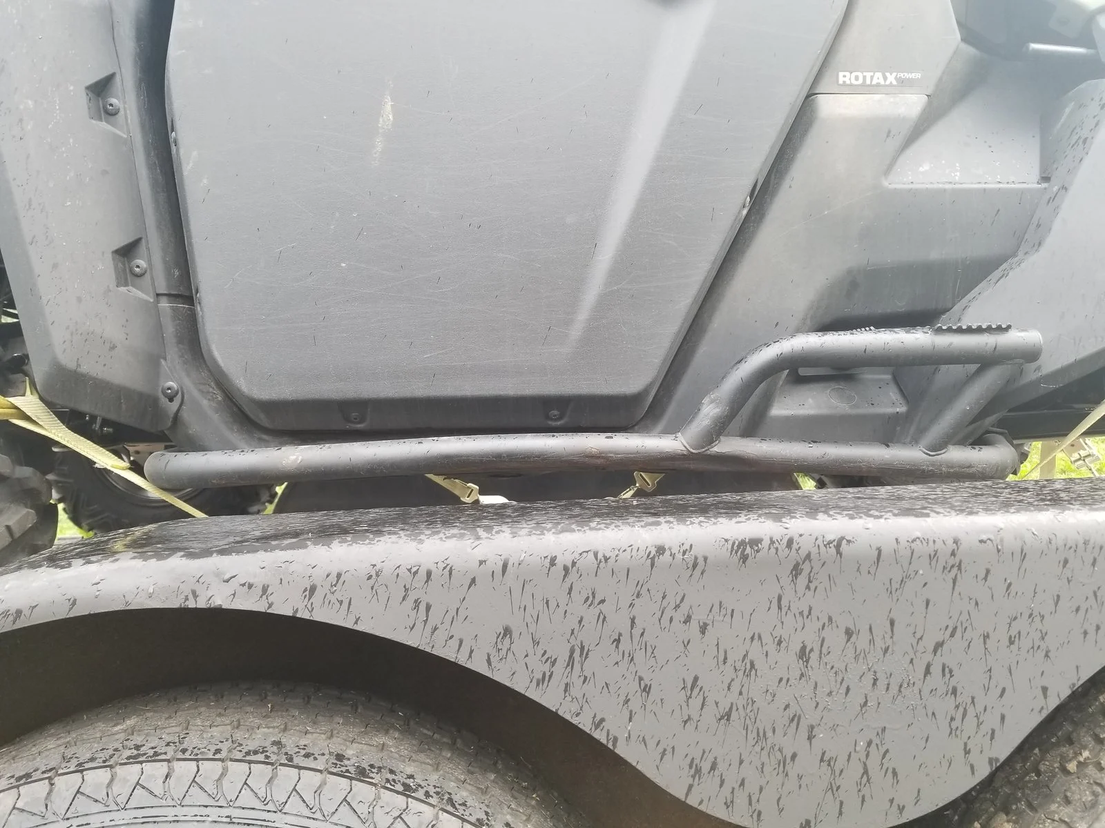

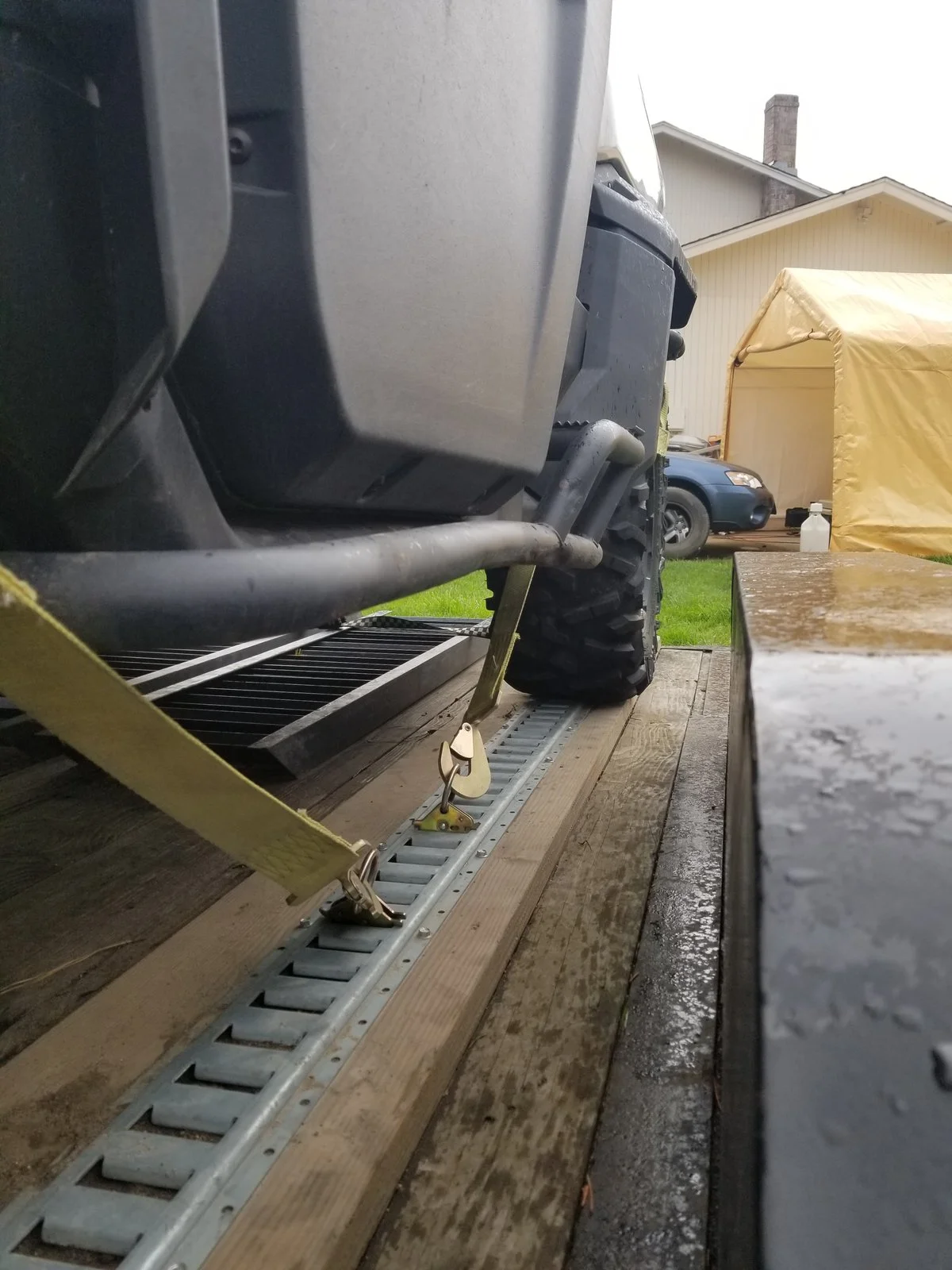

So here ya go.... lets just say, from here on out rule #1 is ALWAYS CHECK THE HUMPTY BUMP!!!  One other thing.... JUST THINK HAD THEY NOT BEEN THERE AT ALL..... 😢 😢 😢YIKES!!!! The fourth picture is hard to see, but the tube is ABOVE the bottom of the rig.....
I’d say the sliders spared you some other damage but those aren’t new anymore.
Most of the damage was busting trails in the snow. Rolling over humpty bumps and coming down on BOULDERS!!! Like I said, rule #1: PRE CHECK ALL HUMPTIES!!! The one divot on the drivers side nearly made it to the floor.
