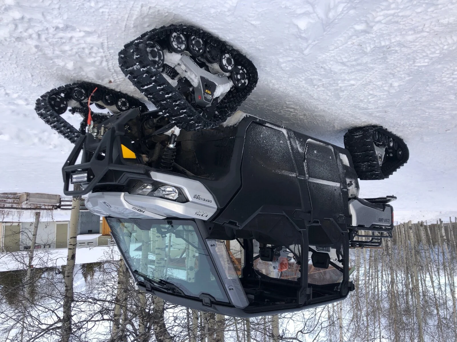

I have the 360 LT tracks, and they have been pretty solid.  The shop I dealt with had both types of Can Am tracks  in stock, but he said that for my area of use, I would be better off with the 360s.  So far, I have yet to find any issue with them.
You will lose about 50% of your cruising speed, 40 KM/hr is about the max... but for me, the ability to take 4-6 people out into an area they likely would never see, in the middle of winter, is worth it.
you want the air intake relocation kit, and the belt cooling relocation kit, as well as the speed module, and either flares or full doors... the back seat passengers get dusted in snow when its powdery...dont know why the pic is upside down, I'm not from Australia...
