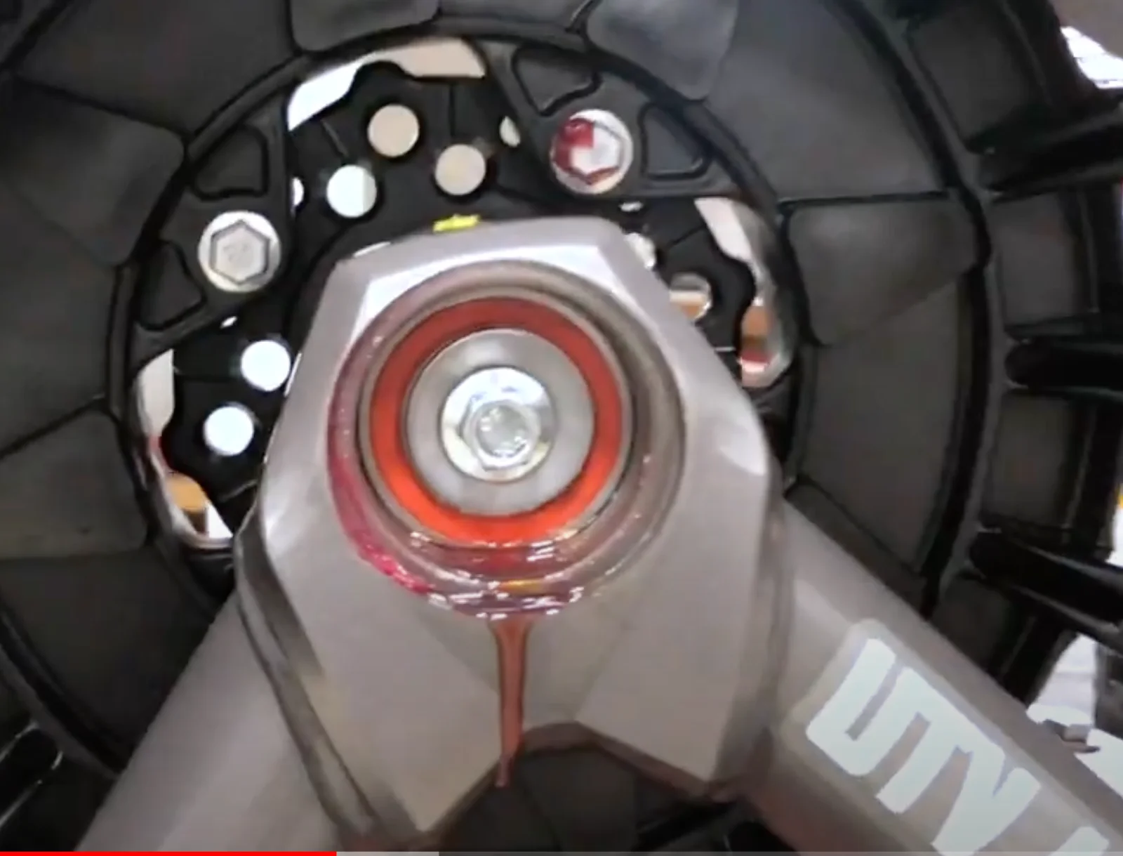

I will say if I was going to buy a new machine and set of tracks I would go with the Camso based on two main things:
1. Ability to maintain/grease the bearings. The new design allows you to grease all the boggie wheel bearings and the main hub bearing. The can-am this is not possible.  Check out the video here.
2. Three bearing main shaft that does not require any special tools to maintain/replace on the camso. If you plan on full time running tracks you will probably see similar wear as my tracks running the majority of the year on them. The fact that the main shaft bearings are all the same size, and do not require a press or puller is a plus for me. Also the bolt and washer holding it together
vs the snap ring Can-am uses.
My 2cents, but after working on my Apaches Camso seem like the better option.
