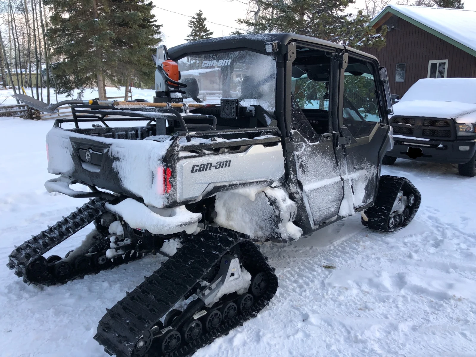

Ended up getting the 360LT Tracks.
Dealer recommended them unless I was trailering to snow line.  Backcountry LT need more snow to function, without destroying sliders.
So I saved some $, and it will probably dump snow this year, and these will be put to the test!
Has a few parts from catalog added.
-Front hitch mount, Corbin Horn, 10” Rigid Light, wind deflectors, Windshield with wiper, half doors, saw mount rear bumper, cooler, gas can mount, numerous gadgets on bed  etc
going on this month:
track, heated seats, plow, roof liner and some more Rigid Lights, lol
“and then that’s it!”  Said no owner, ever
may go back to original plan of Backcountry LT  -   Waiting for dealer to confirm mounting kit availability.
I put 2500km on the 360 LT tracks that were on my defender hd10 xt cab last winter. It's amazing where they go in slush 3 or more feet of snow. Never had an issue and recommend them highly.

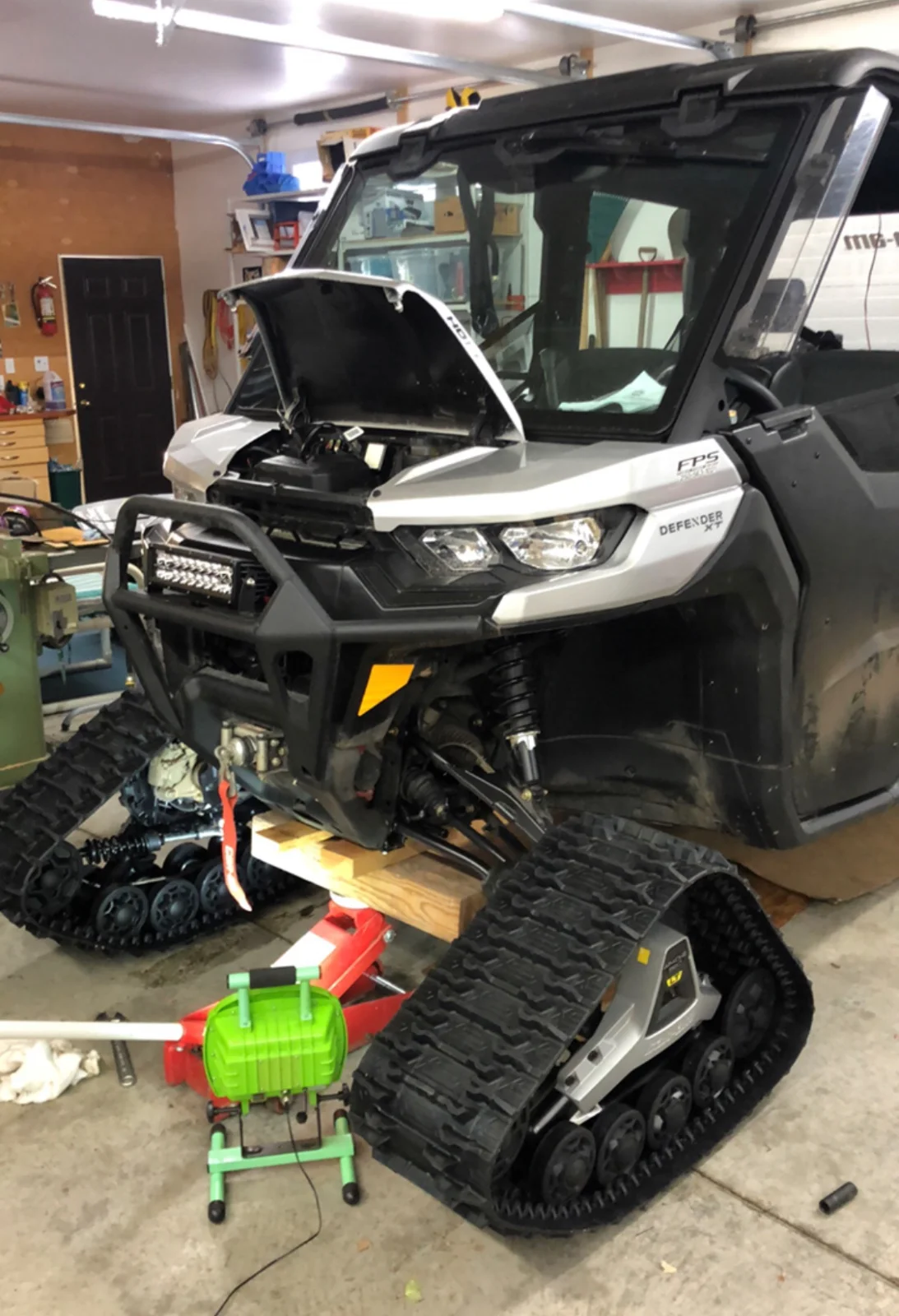

Installing tracks now...
the instructions leave out some key parts...
the way the anti rotation springs are to be mounted at the front.   No picture!
The users guide... lol
many body have a pic of the anti rotation spring set up?
thank you!
Bad Daddy
Can you post some pics showing the brackets and spring locations of the final install. I'm sure that I will have some questions myself later this week when I install my setup. The instructions suck...
Bad Daddy
I will see if I have photos.  Machine is not close by... I know that
there is an instruction sheet that you have to download, for the final adjustment of tracks.  If I had access to it when I did the install, it would have made more sense.
This might help: ATV SSV adjustment  instruction sheet 487802938.
Bad Daddy
There is another instruction sheet you need to download to set up the anti rotation arms.  I do t have part number but if you read the mounting instructions it will tell you the sheet number

These tracks are quite good in the trails.
We were in a foot of wind blown snow on the lake, then riding through a narrow trail that had been cleared.  And by cleared I mean the logs and trees were in the middle of the trail.   Went over the logs no problem... like a Sherman tank!
