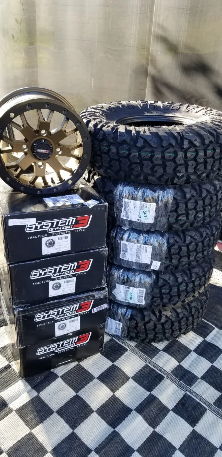

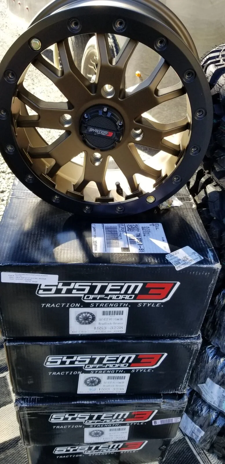

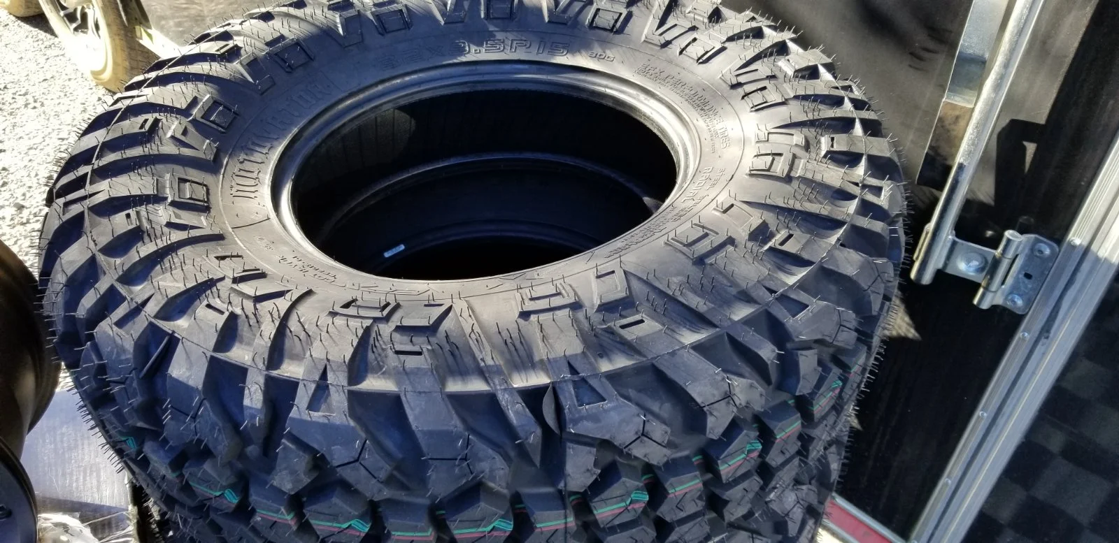

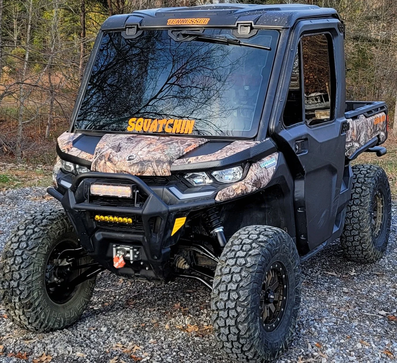

First thing I want was bigger tires and rims. So I went the S3 Beadlock rims. Fronts right 15x7 with a 6/1 offset. Rears are 15x7 with a 4/3 offset since the rear so 1.5 narrower than the front on each side.  15x32 EFX Motovator

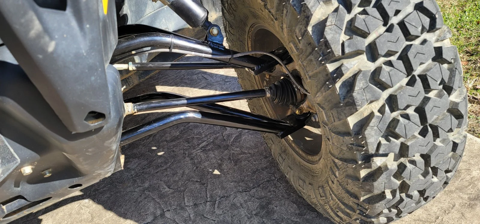

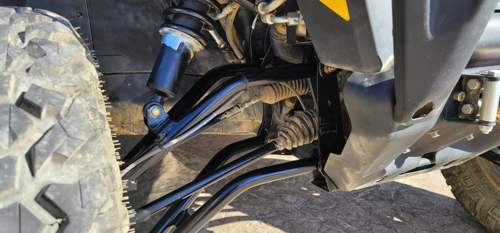

I put them on and the fronts were rubbing on the front fenders on full turn. So I bought the JAKE MOREHEAD 2inch forward A-Arms and that took care of the rubbing.

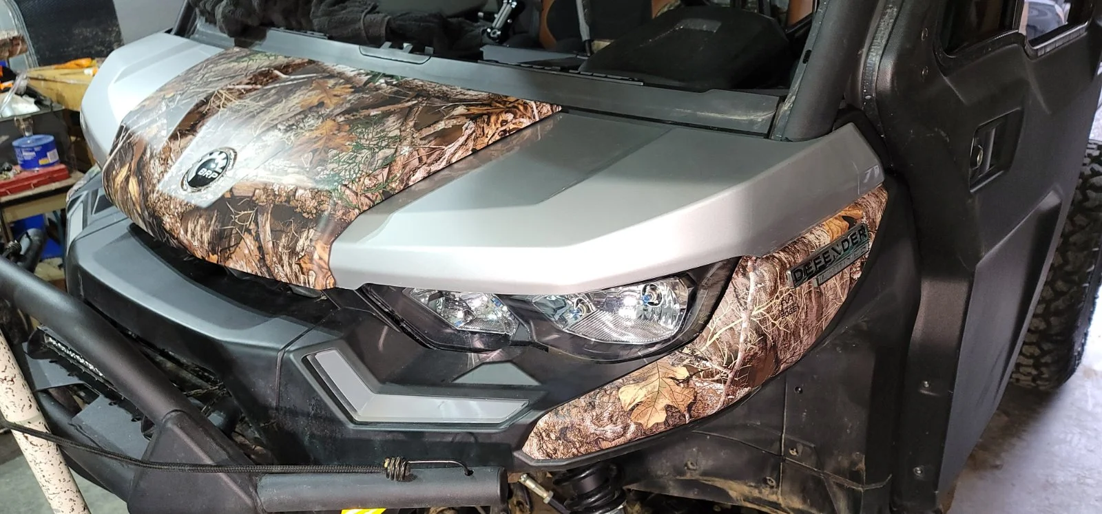

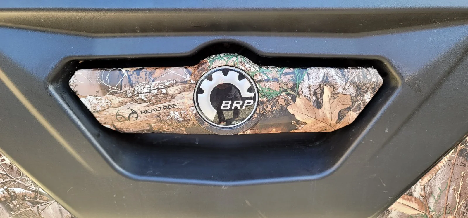

I was not feeling the silver panel with the black and brown seat. Plus I bought the bronze/black S3 rims. So I had to buy some REALTREE CAMO WRAP

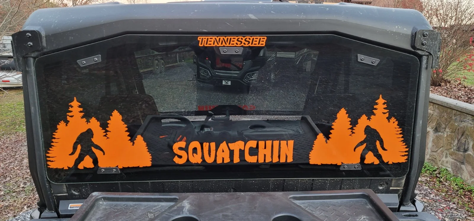

Then a painted the rest of the silver with black bed line spray. Had a friend of my make me so orange graphics

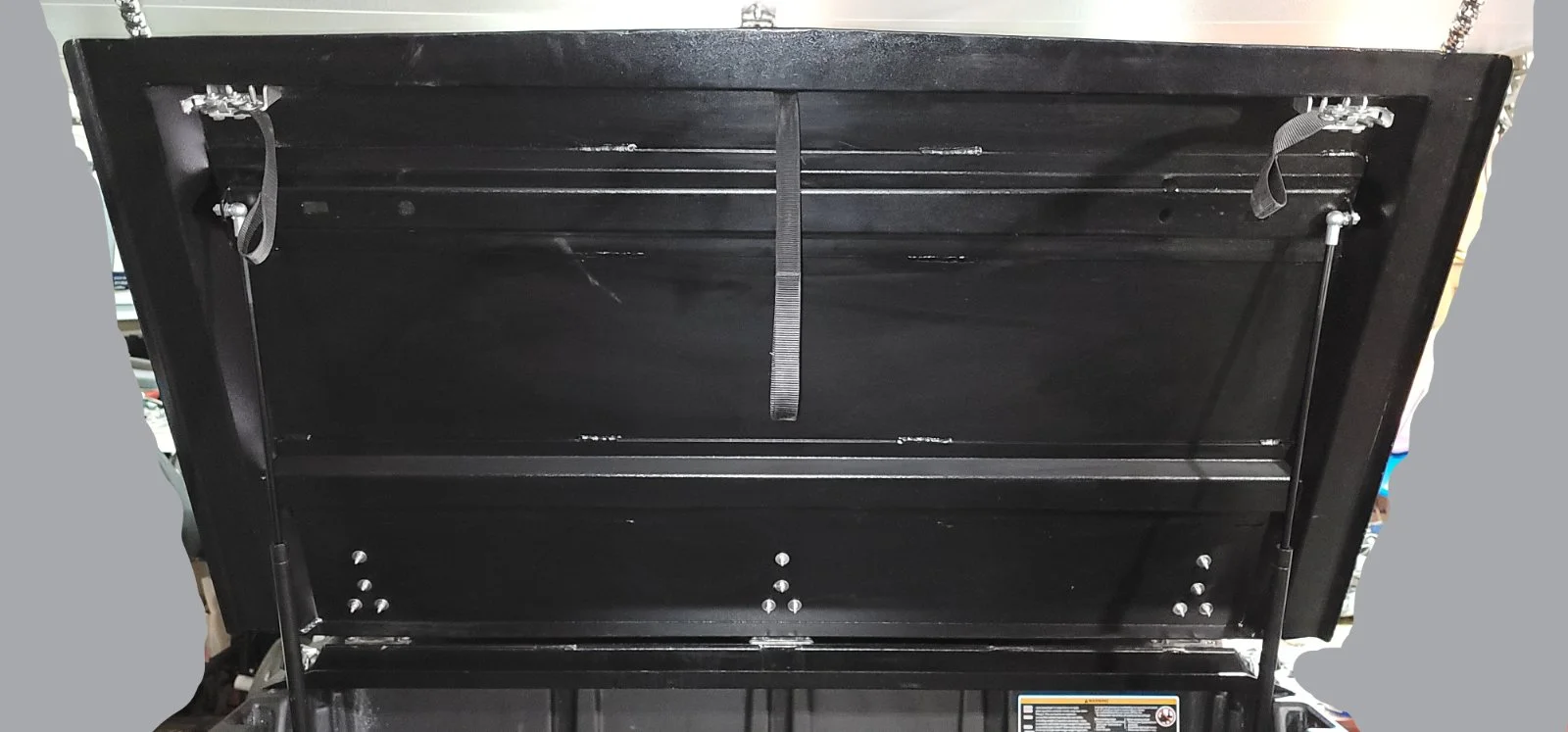

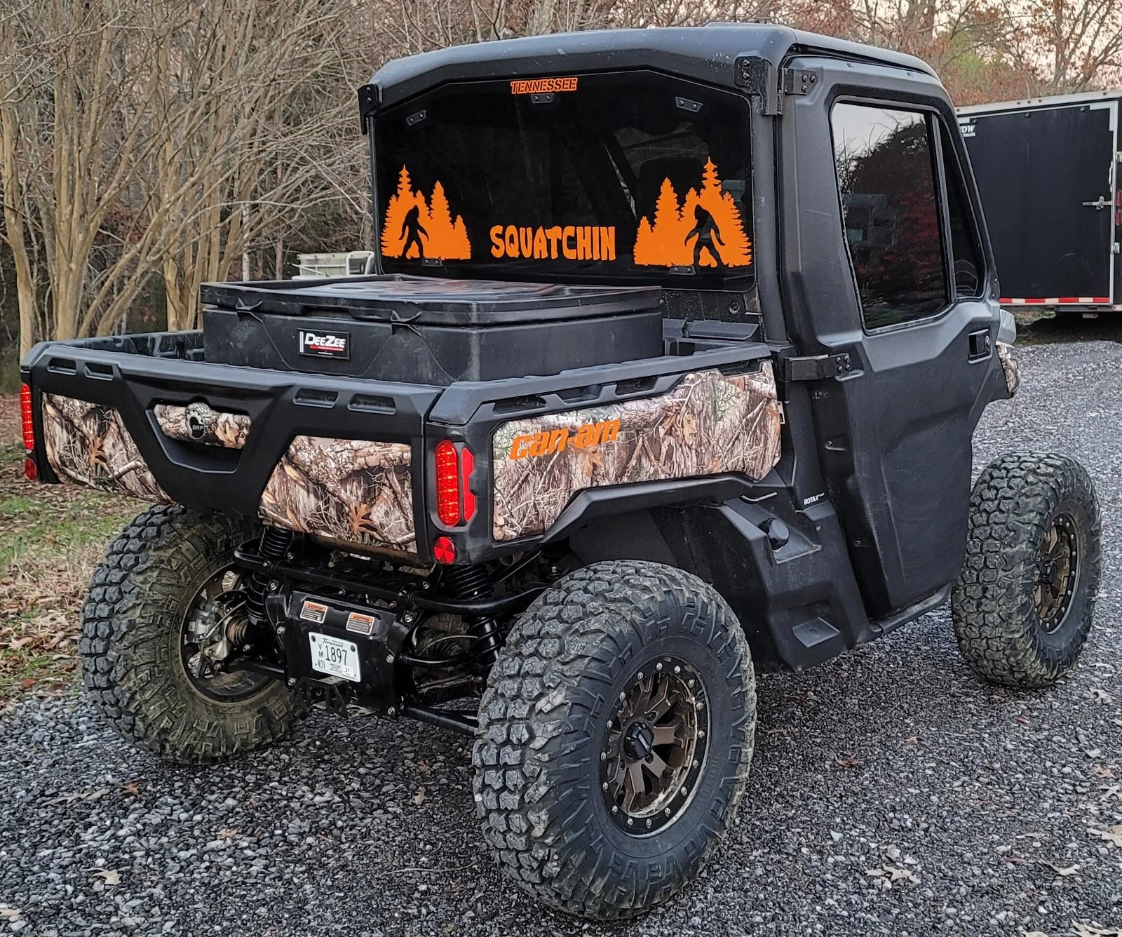

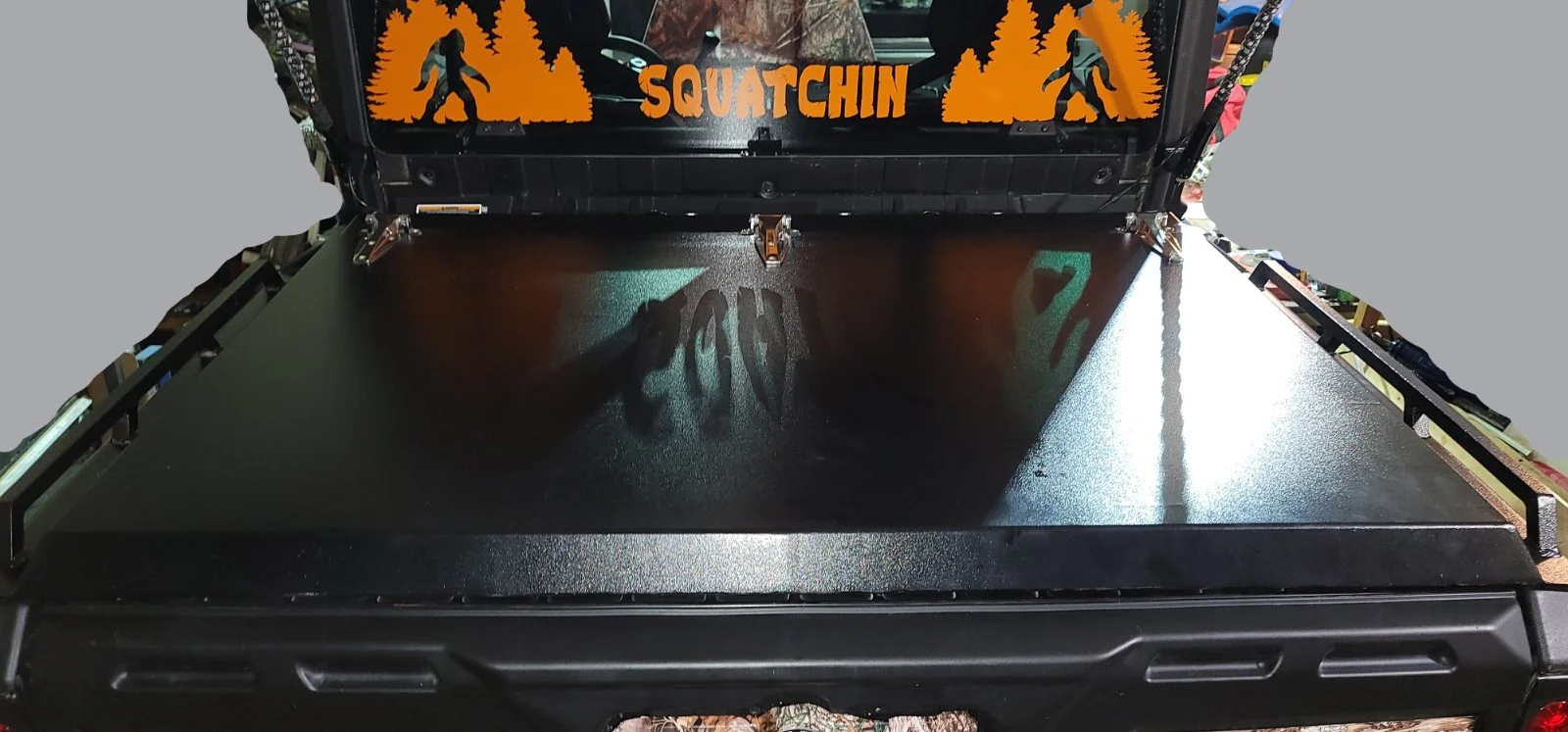

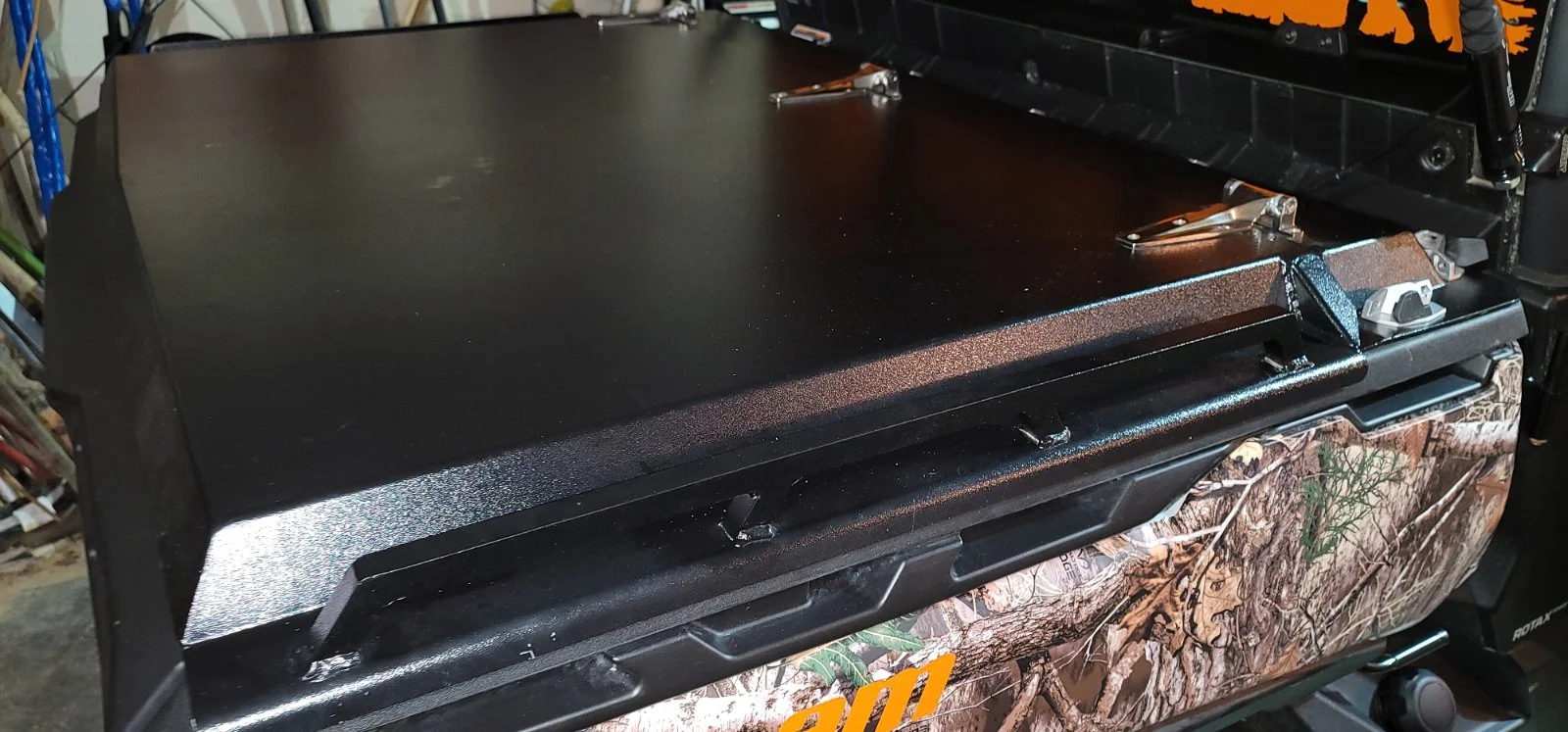

Then in the picture above I had a cheap plastic box the bed for coolers and tools. When you ride in real muddy conditions mud just fills the bed full of mud. So I bought a bed cover from  Westlock Powersports & Marine in Canada. This cover is AWESOME!!!!!!

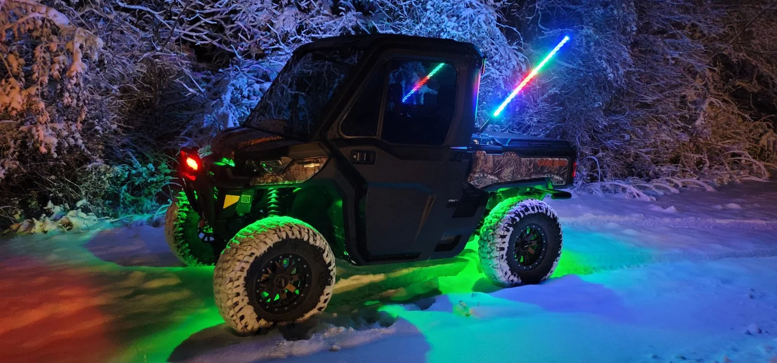

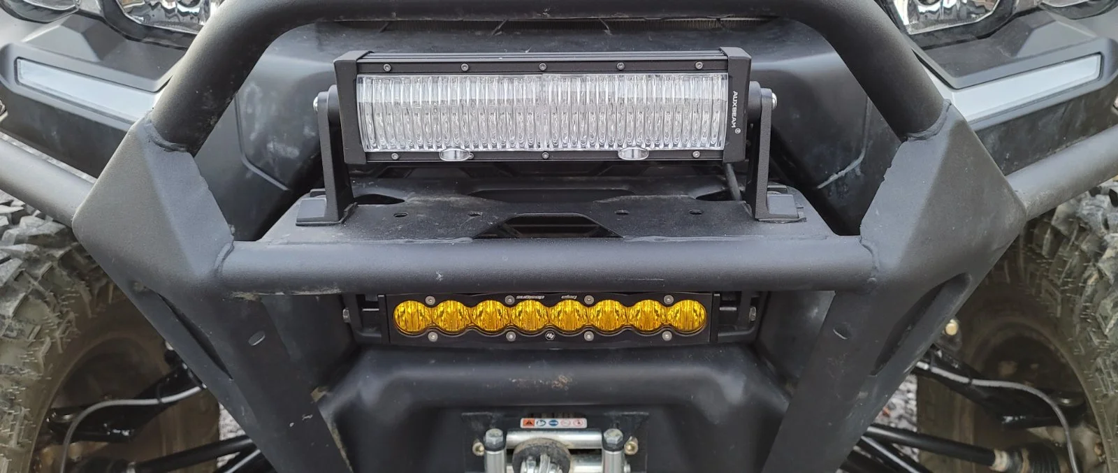

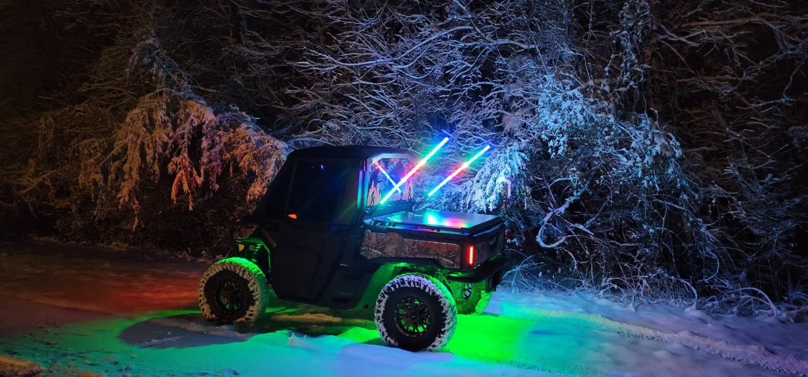

And then there is the LED lights.

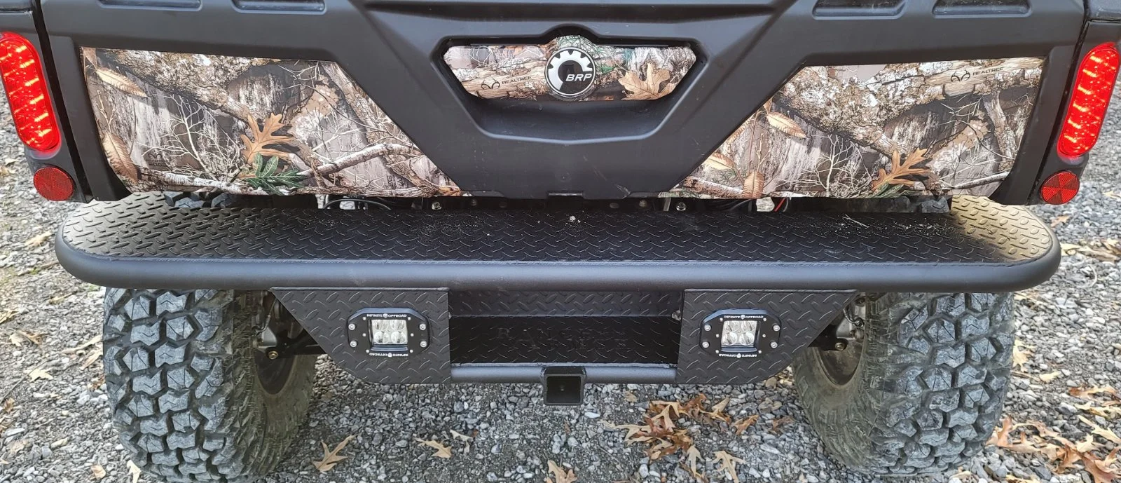

My wife bought me a great bumper for it with led back up light in it.
