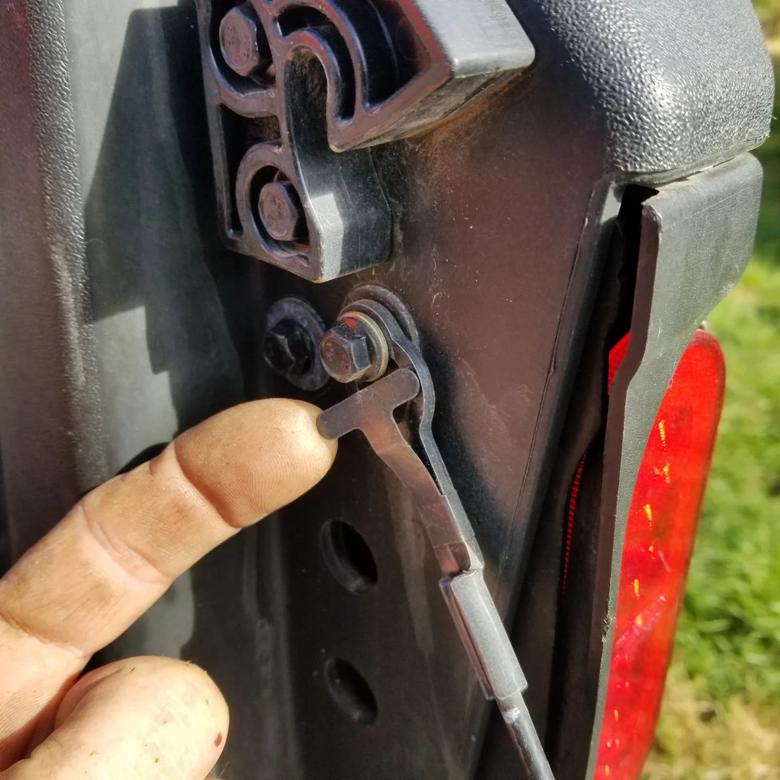

Yup, AH2R is correct. The cables have retention tabS that flex so they can be removed off the studs without tools.

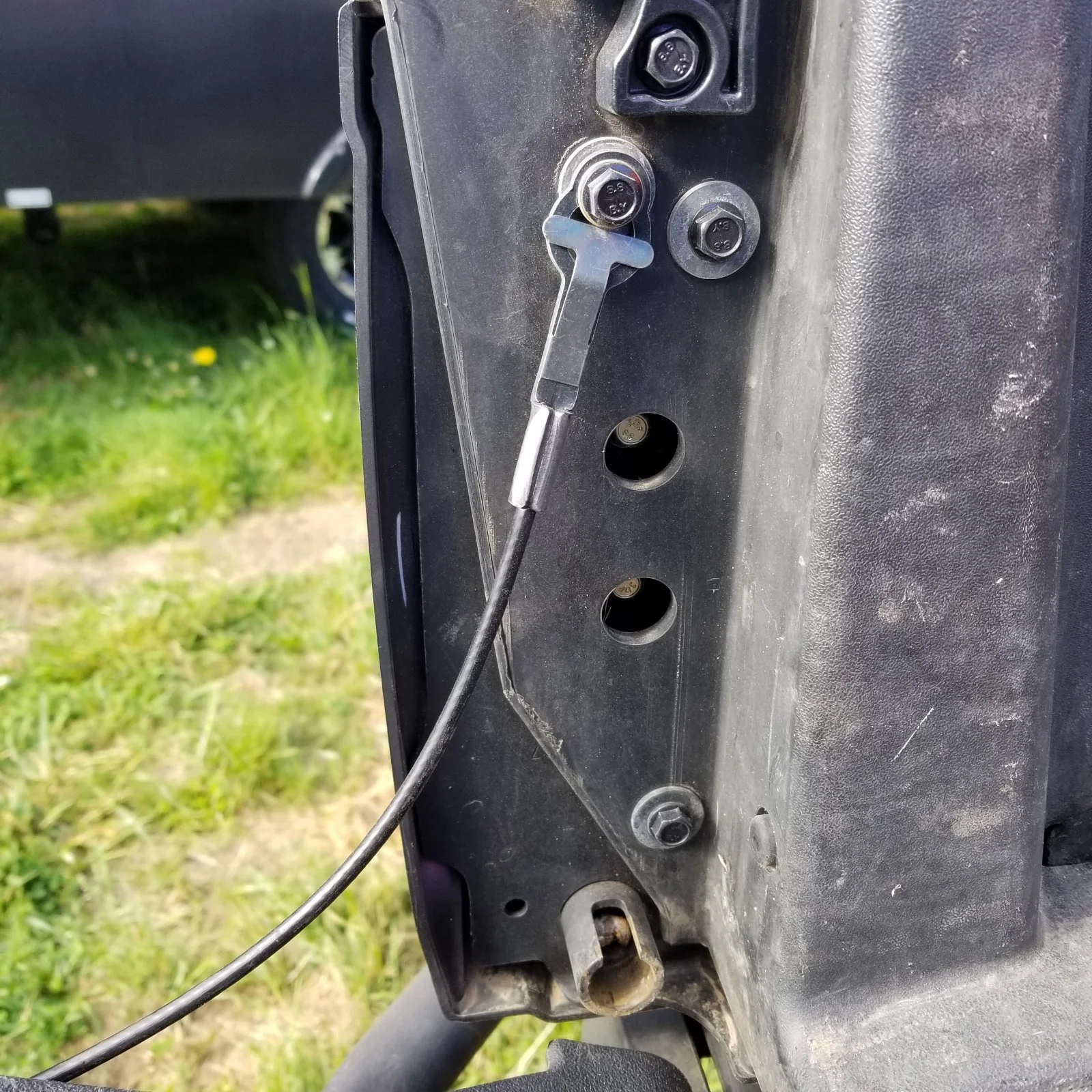

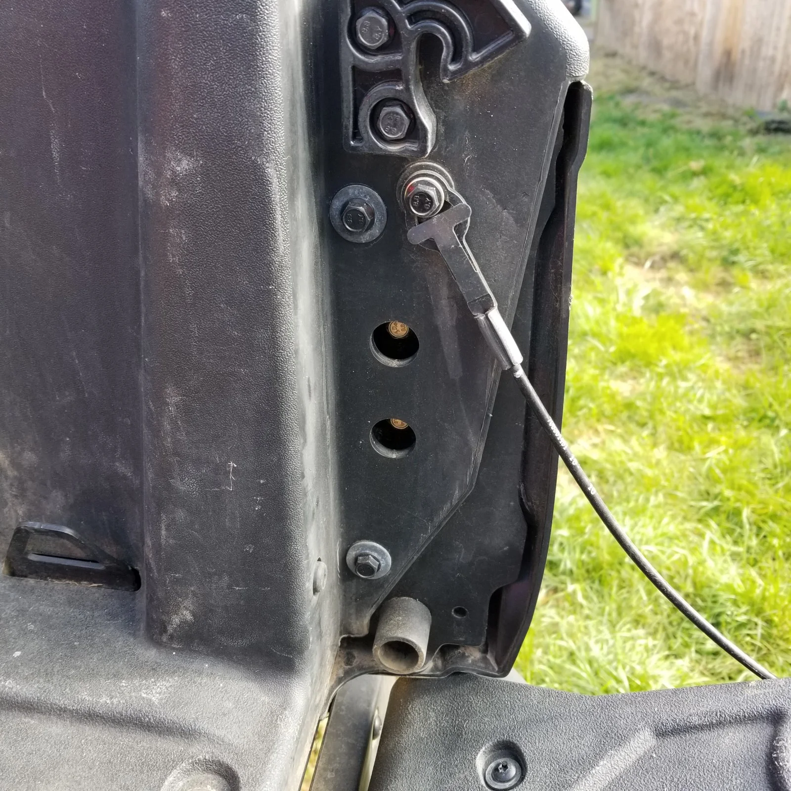

Here are the cables and a couple of the hinge pivots.... Hope this helps... Can't think you'd need to pull the tailgate apart to remove it....
I do have the retention tabs. So much easier if I would have figured this out before doing it the hard way. Thanks for bringing me up to speed.
