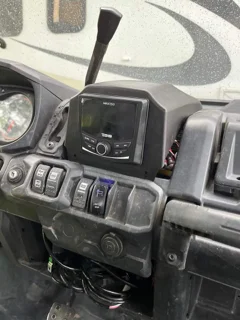

I have a 2020 Defender Max HD10DPS. I've added a light bar, whips, rock lights, 4 x DS18 8" coaxials in the roof with a kicker 4 channel amp running those, and 2 x 12" DS18 subs in the bed with a Skar Audio 1000 watt amp pushing them. I'm running a DS18 MRX150 for the head unit. After riding for a while the coaxials will cut out but the subs continue to work. If its drawing too much power I would have assumed the sub amp would cut out before the highs and mids do. If I turn the volume down they come back on almost immediately. Turn the volume back up and they go out again. The longer I ride the lower I have to put the volume to get them to work again. Any ideas?

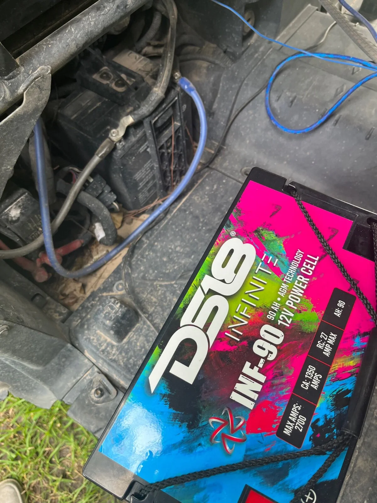

So I swapped in a DS18 battery and it helped a little but my mids and highs still shut down at higher volume. This was the largest capacity battery they make. Not sure where to go from here. A 2 farad capacitor maybe? The voltmeter on the head unit never dropped below 12.8 volts and was as high as 14.4 at times.
