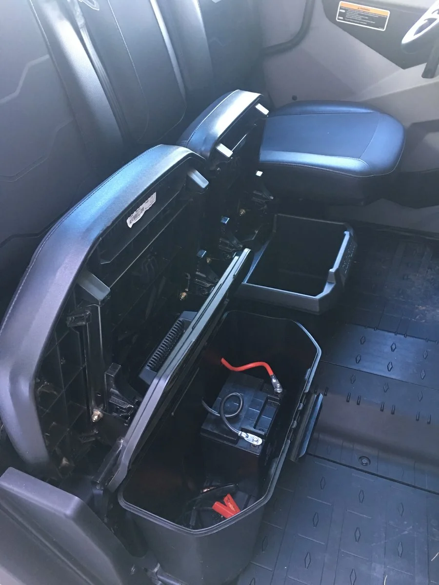

I put in a spare battery because I pull so much current in the wintertime.  Plow, heat, PS, lights, etc...  I just added a second 30A and wired it up pos/pos, neg/neg and it starts strong and the lights don’t go dim after hours of plowing.
