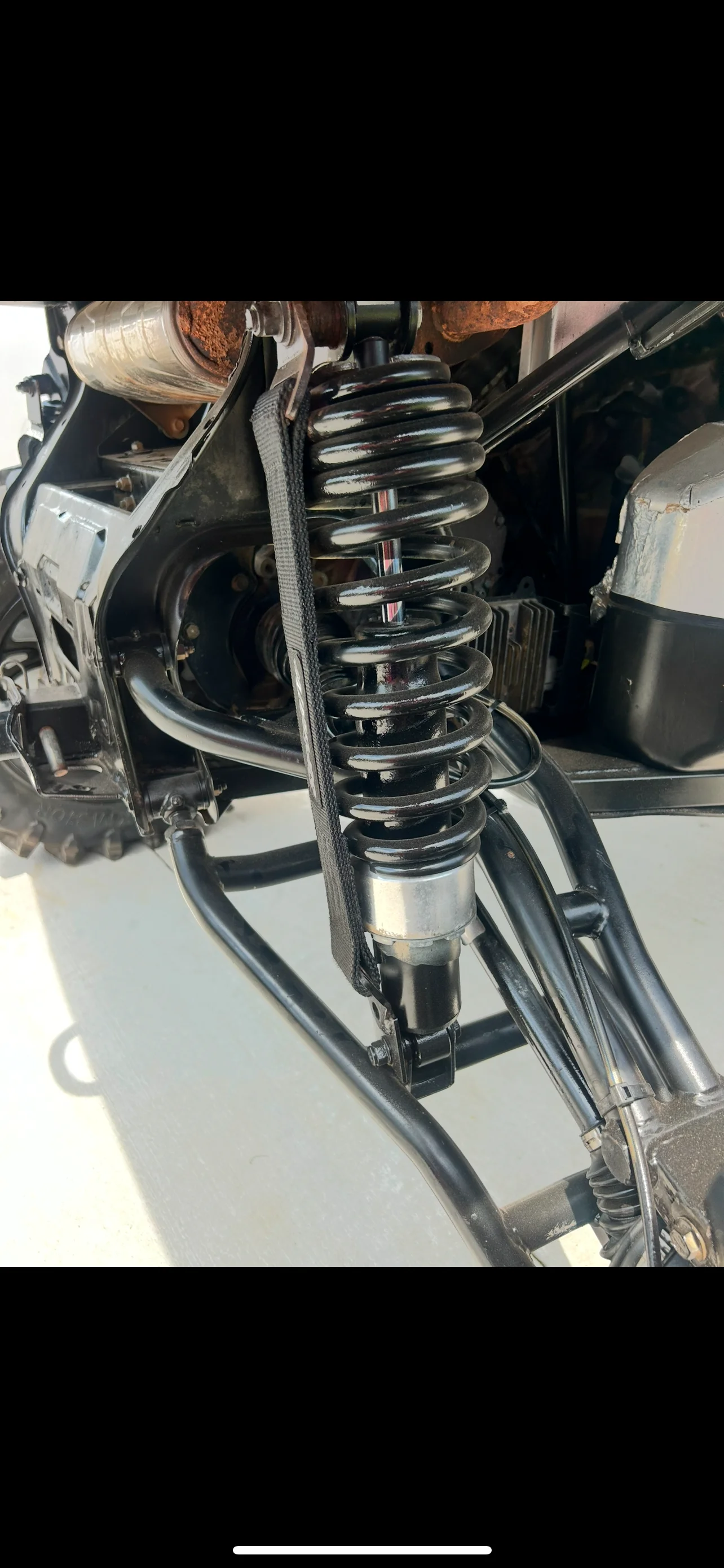

D dolenp New member Joined Oct 1, 2025 Messages 1 Reaction score 0 Location texas Wednesday at 3:06 PM #1 What happens if I take this space off ? New to Sxs stuff! Attachments IMG_4223.webp 222.4 KB · Views: 11
RossO Active member Joined Jan 28, 2020 Messages 128 Reaction score 30 Yesterday at 7:37 AM #2 You'll get the factory ride back, lose about 3 inches of ground clearance and the cv joints on your axles will thank you.
H honda400ex2003 Active member Joined Jul 8, 2022 Messages 206 Reaction score 41 Yesterday at 12:54 PM #3 that thing is probably super rough riding. it even has limiter straps on it, to help the axles from popping out, crazy stuff there. steve
