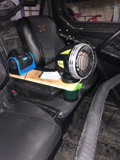

Another cheap option for a heater is the Mr. buddy golf cart heater... fits in the cup holder. Raised the temp in the cab from -15c to +5c pretty quickly. I do have to leave one of the door windows unzipped a little to prevent the windshield from fogging up.
Here is my set up for heat.  It is the Mr. Heater golf cart heater and a cheap fan from Amazon.  I drilled a hole in a sheet of plywood to slip the heater into and screwed the fan down behind it so it can blow towards the windshield.  Clears the windshield right up if it starts to fog.
The plywood basically just sits on the arm rest.  I screwed some pieces to the underside to wedge into the frame on the back wall that holds the back rests.
