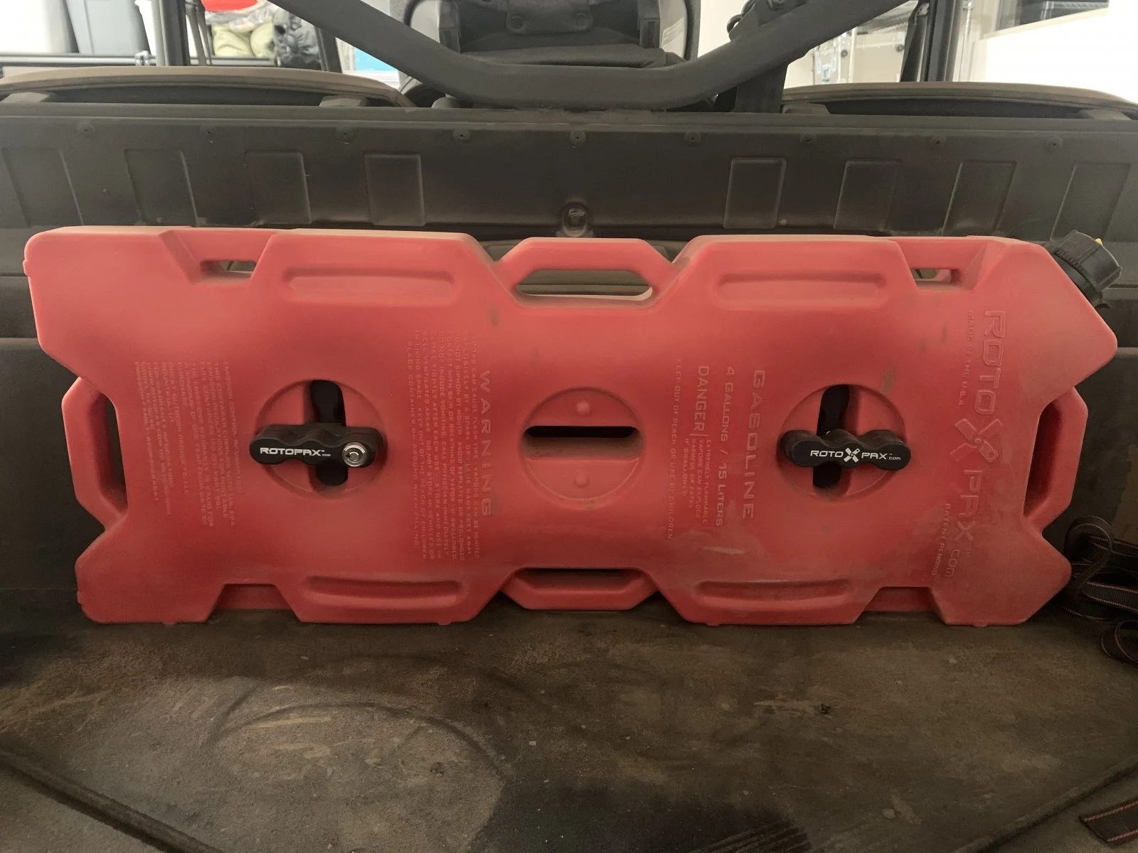

I have the 4 gallon rotopax mounted direct to the cab side of my bed. You can see the pictures in my build. I can get you some more pictures if that would be helpful. Pretty happy with how it turned out. Even full of fuel, the bed still tilts up and easily stays in the dump position. Not too much weight to make it collapse back down.

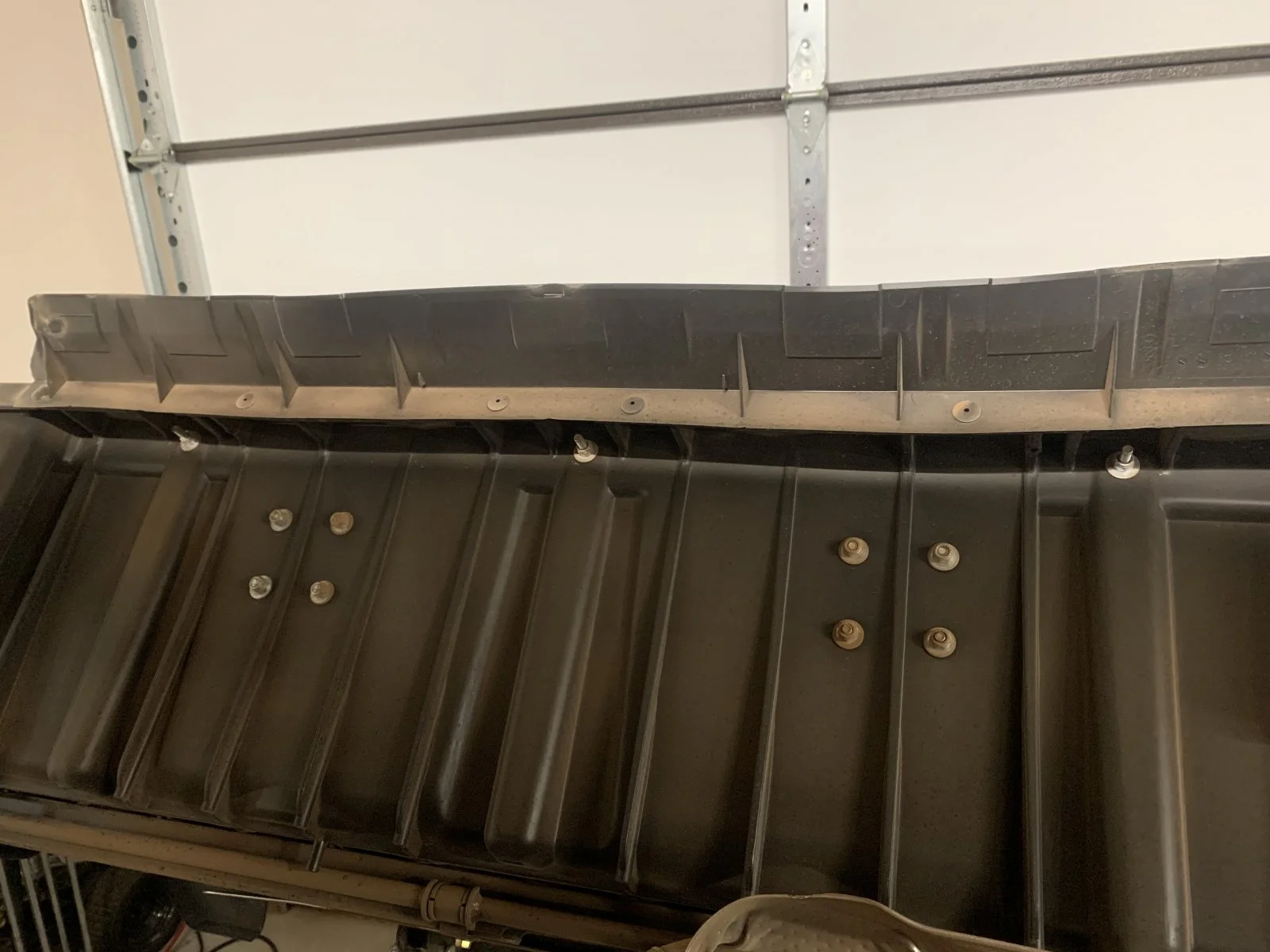

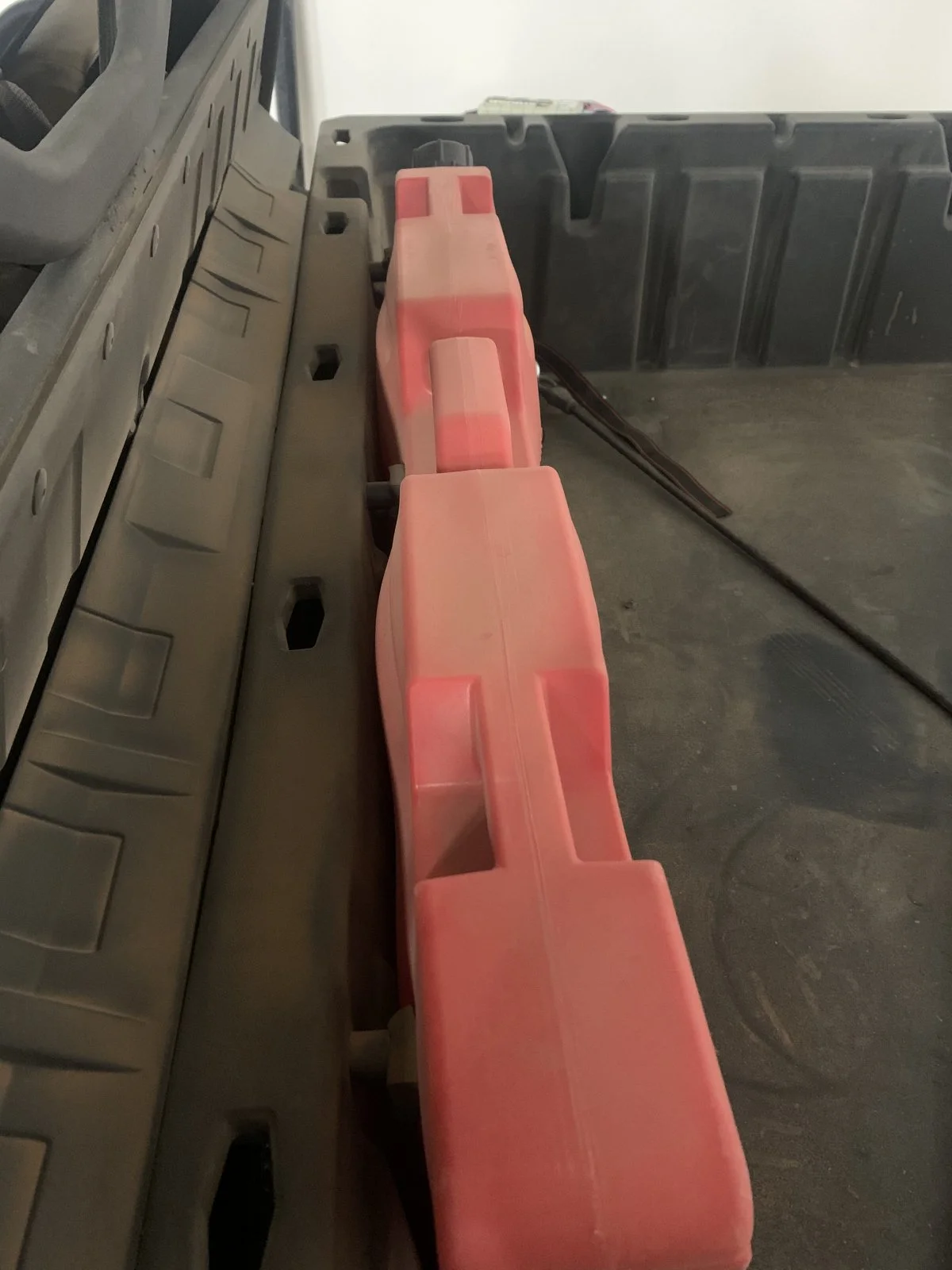

Yep, just layed the rotopax flat in the bed so the brackets are not actually carrying any weight, more just keeping it held upright. Marked it all out and started drilling the holes. I believe I made a run to ace hardware because the bolts that came with the kit were either too long or too short, I can’t remember. I also added 3 bolts on the top to keep the rotopax more stable. The bed rail towards the cab has a slight tilt to it and I wanted the rotopax at a 90 degree angle from the floor of the bed. Not necessary, but to achieve this, it requires shimming the flat part of the pack mounts up against the bed rail. I used some left over black nylon spacers from a tv mounting kit to get it right. Hopefully the pictures help! The rotopax is a little swollen. Only 111 degrees out here in Tucson today. Good luck!!
