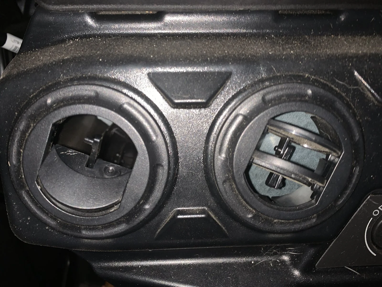

Anyone know where I can find a replacement louvre? Any help would be appreciated.
Thanks,
Mike
The first place to check is your local canam dealer, the online canam parts does not not show the heater option but the shop manual does show the louvres separately so they should be available.🤔

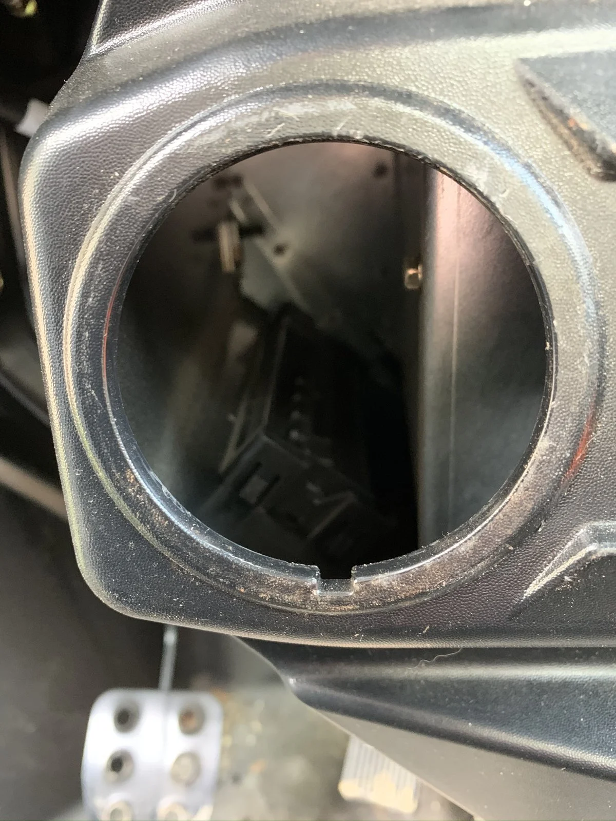

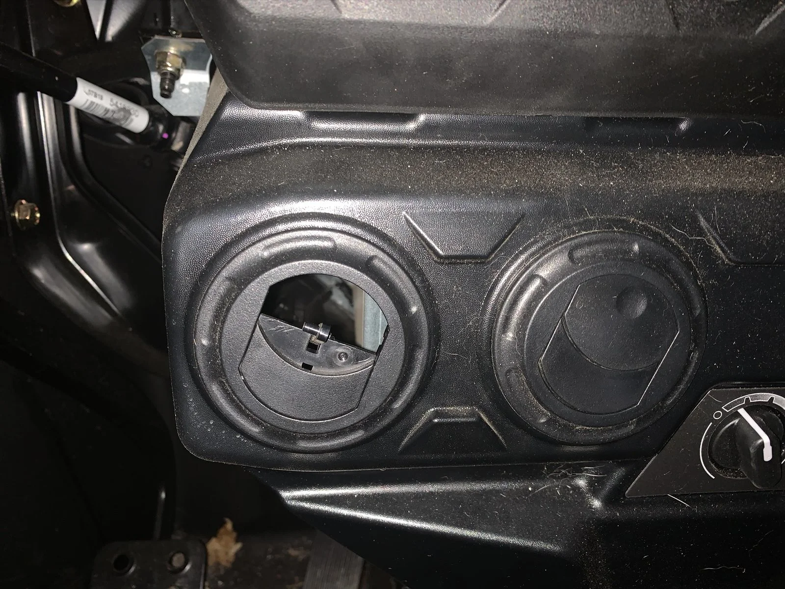

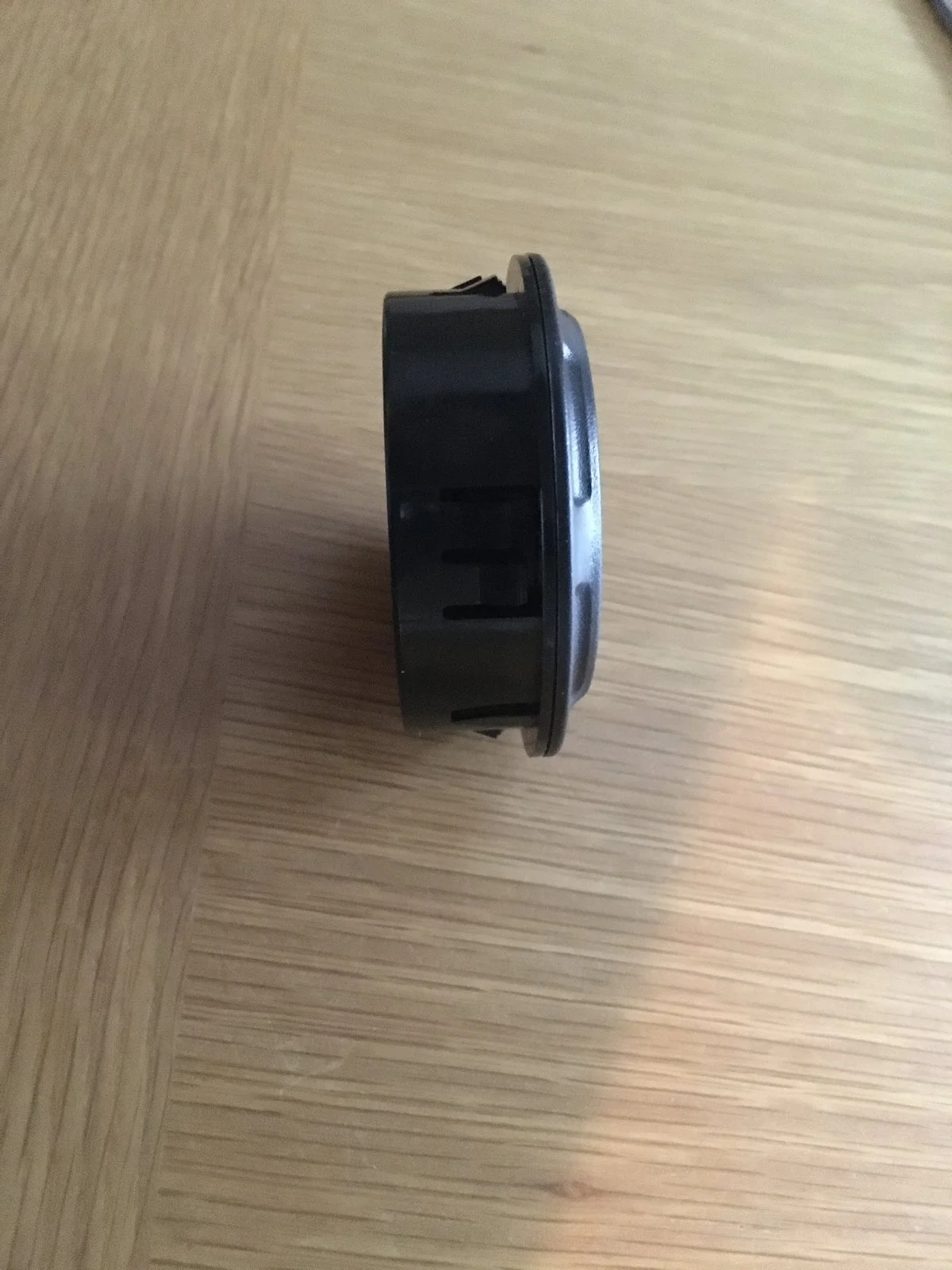

Received my replacement, question is what’s the trick to getting the old one out?
It looks like you have two tabs that have to pop out, try and pry gently with a small flat blade screw driverfrom the front of the panel first? It is also possible that they rotate to lock into or release from the locked position?🤔
Easy Peasy, used a painters tool (I thinks it’s a 5 way painters tool) anywayI was able to slip behind the rotating collar and kept it pry’d open with a small screw driver and rotated the painters under the flange and it basically popped out. That allowed access to the fixed collar where I sprung open the retention tabs with the small screw driver. The new one is “clocked” with a male alignment into the female slot at the 6:00 o’clock position. I didn’t think of it till after I installed the new one. The louvre is inside the unit.
