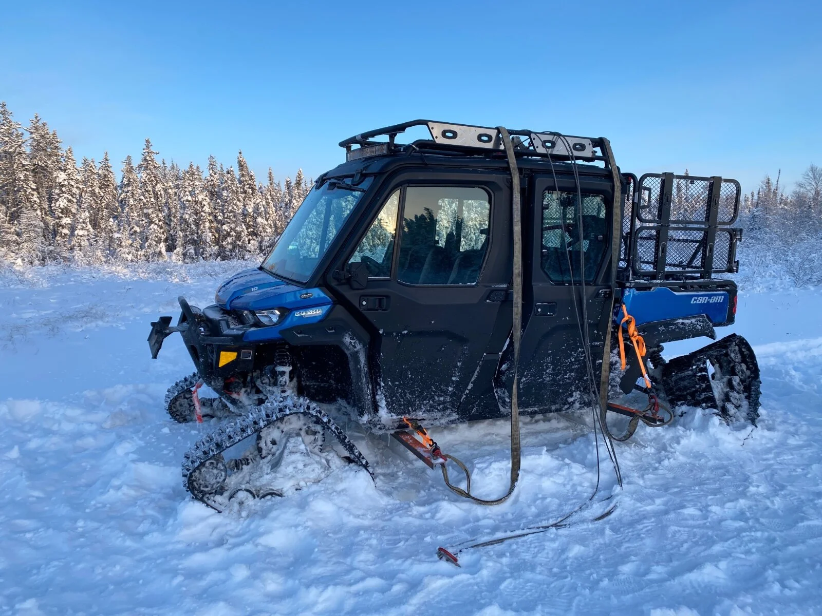

Has anyone else had a Rear Lower A Arm bolt shear ? 2021 Max Limited on Tracks, Left Hand lower a arm bolt (forward attach point) Sheared when some overflow/ice was encountered. This caused one of the holes on the frame to get bent/elongated. I made a doubler and welded it on so that i could replace the a arm. We were about 20KM from town and it was -38C O.A.T.
