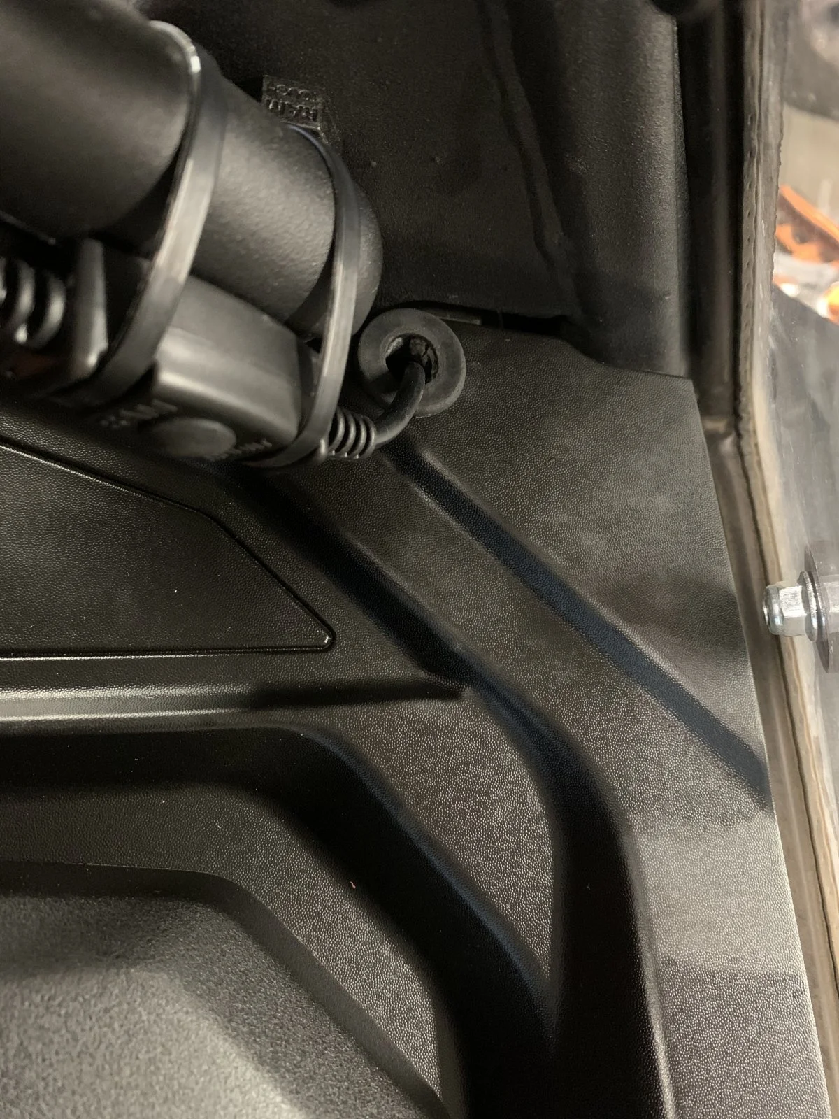

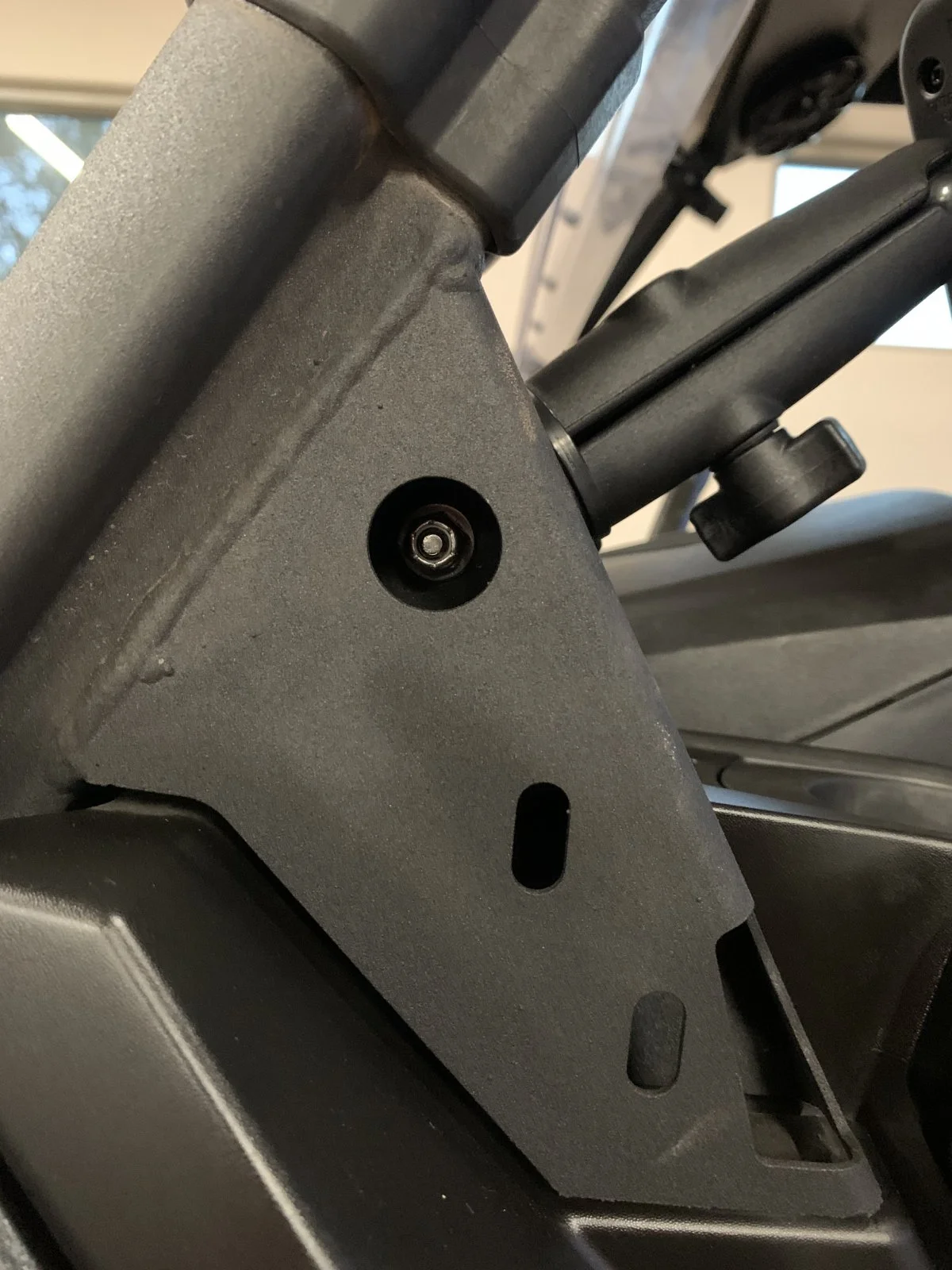

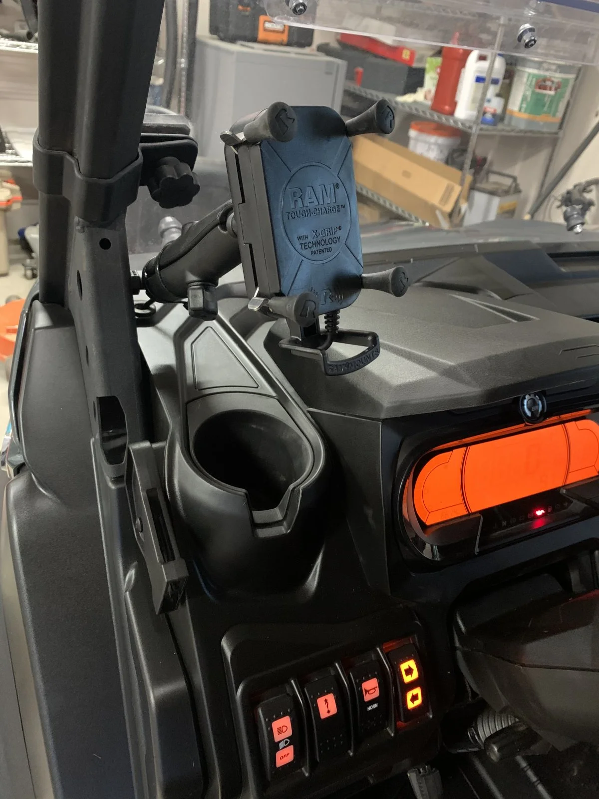

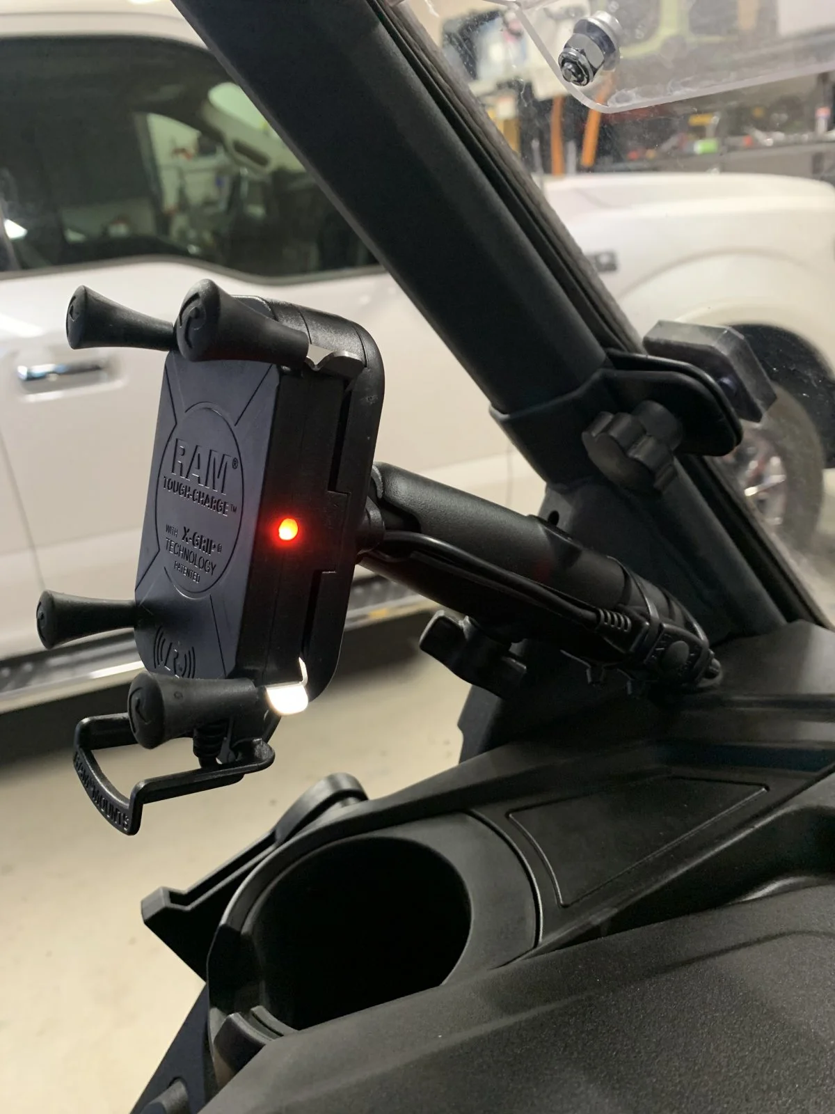

I wanted to add a charger so I could leave my phone screen on constantly when navigating trails with the app I use. Ram mounts just released this wireless, waterproof mount so I went for it. Figured this beats stopping at every trail intersection to figure out where we are headed next. Having a charged phone isn’t a bad thing either. I’ll  include screen shots of the parts I used. Pretty easy install, took about an hour start to finish. Ram has a million different mounting plates and arms so the options are endless here. I decided to use the factory drilled hole on the roll cage instead of going into the dash plastic just for a little extra strength. I think these mounting holes may be for the door kit, so it might not be an option for the guys with cab models.

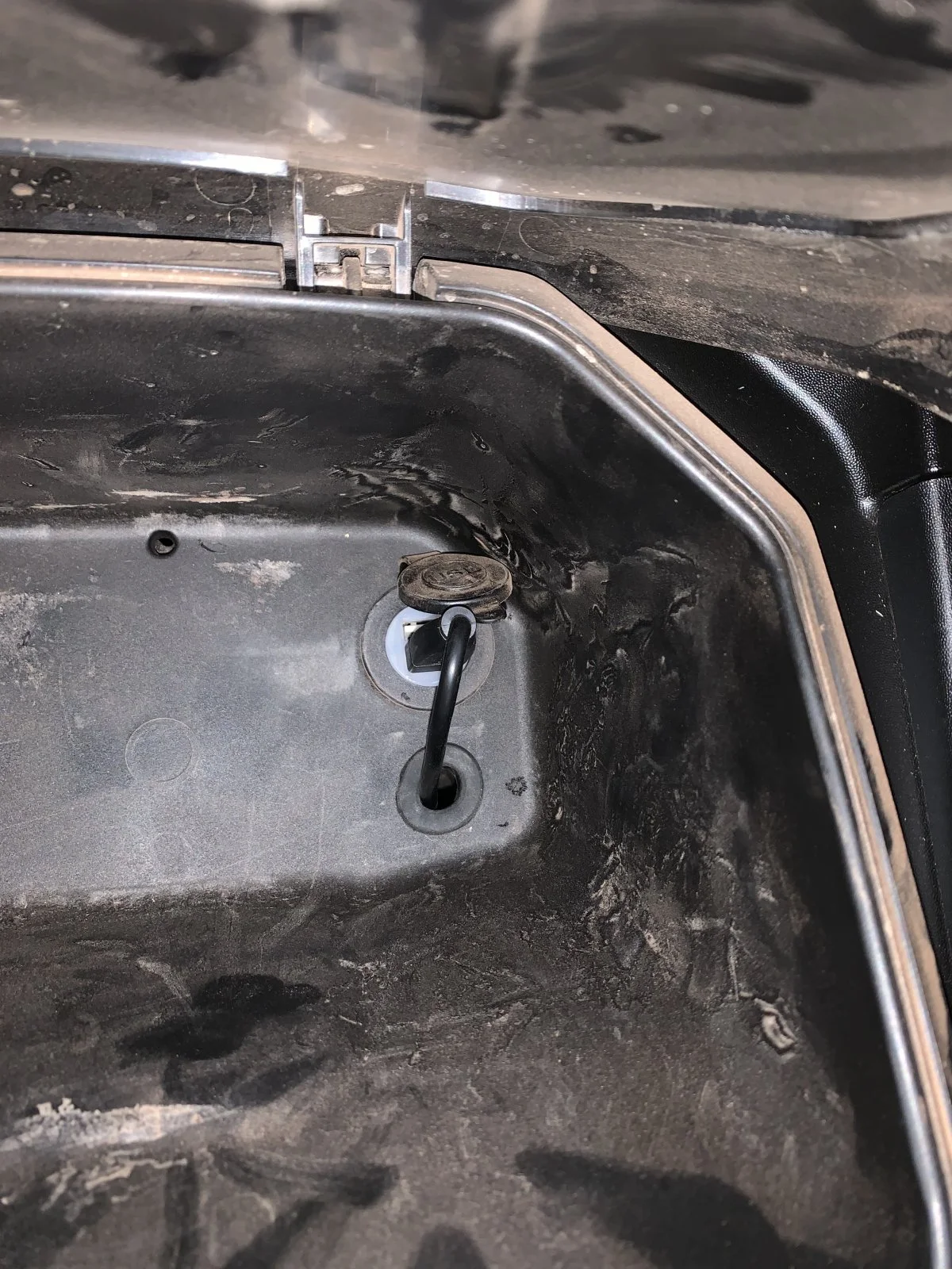

install was pretty straight forward. Drilled a hole in the storage compartment behind the dash, and drilled another hole right behind where the ball sticks out of the cage. Added 2 grommets for good measure and fished the wire through. Pulled the supplied 3’ usb extension cord into the usb charger in the compartment and it’s all done! There is a little push button switch that is tied into the wireless charger. This button is either always on or always off. It does not need to be pushed every time you start the machine up to turn the charger on.
The bottom support piece is adjustable for different phone heights and to avoid hitting power and volume buttons on your phone. The X Grip is pretty awesome, super sturdy and definitely won’t let your phone go. It’s spring loaded so you pinch one side and set your phone in. The little rubber grippers are tapered so it can’t fall out forward. Really cool design.
All finished with my comfort mods for now. Steering wheel and charger. Going to take a few week break (maybe, haha) so my wife doesn’t kill me.

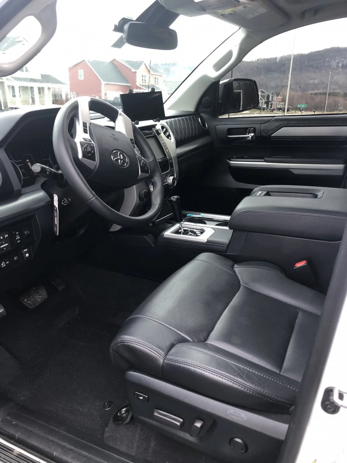

Looks great!!!. I have a RAM Mount in my Tundra to hold a Garmin GPS since the factory navigation isn't that great. Yes, there are endless possibilities with these mounts.

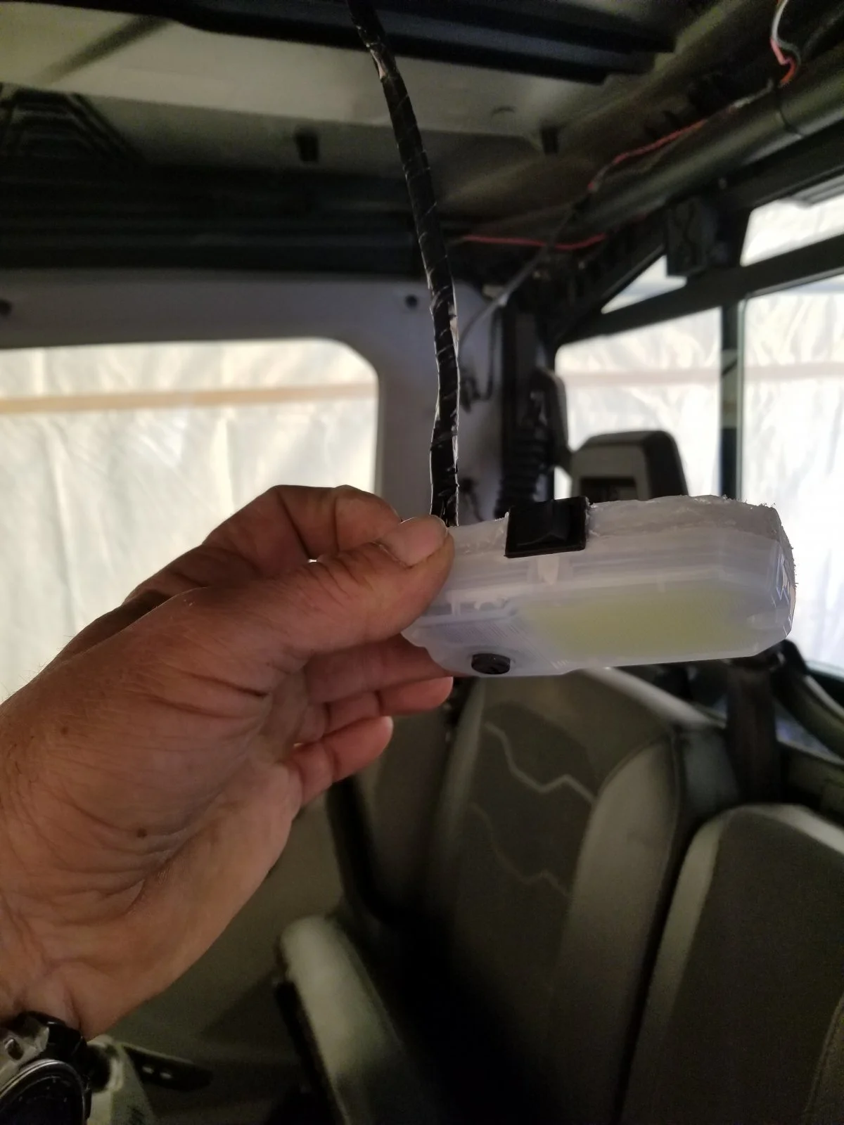

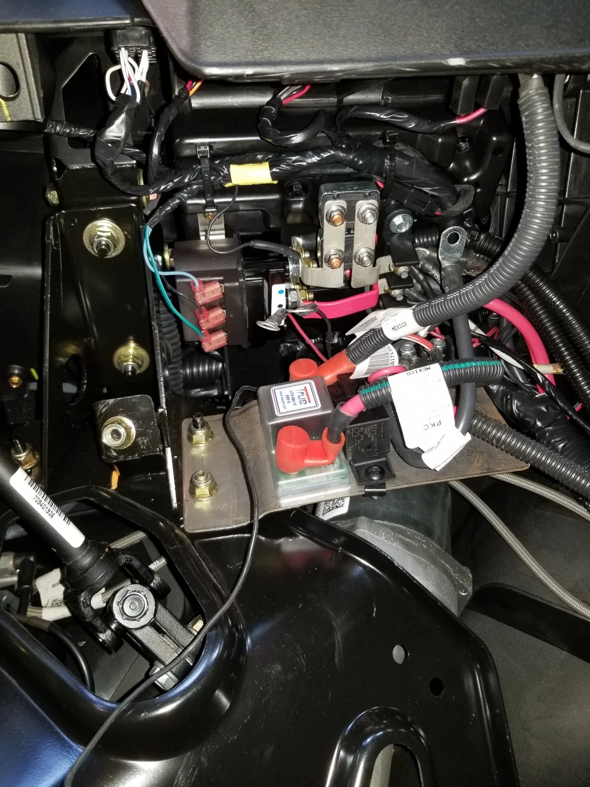

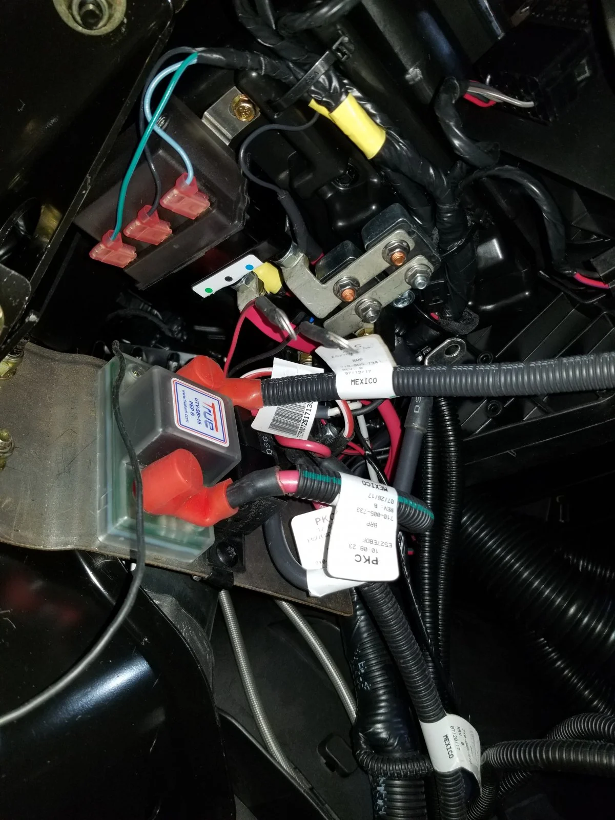

Oh I've got pictures. Here's a couple of the isolator mod.... that BRP said couldnt be installed in my heated cab.... UMMM... SORRY.... I did it.... as well as a host of other things.... Thinking one of the best was the door switches.... I hated not having the dome light come on when the doors open... That was EASY.... Making the light come on while the doors were closed was a little trickier.... BUT... A micro switch added to the light took care of that... 😉
