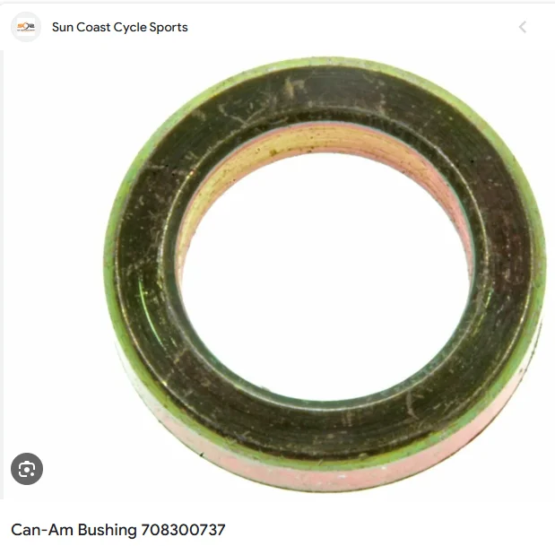

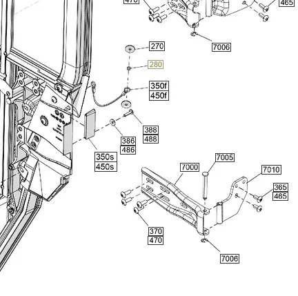

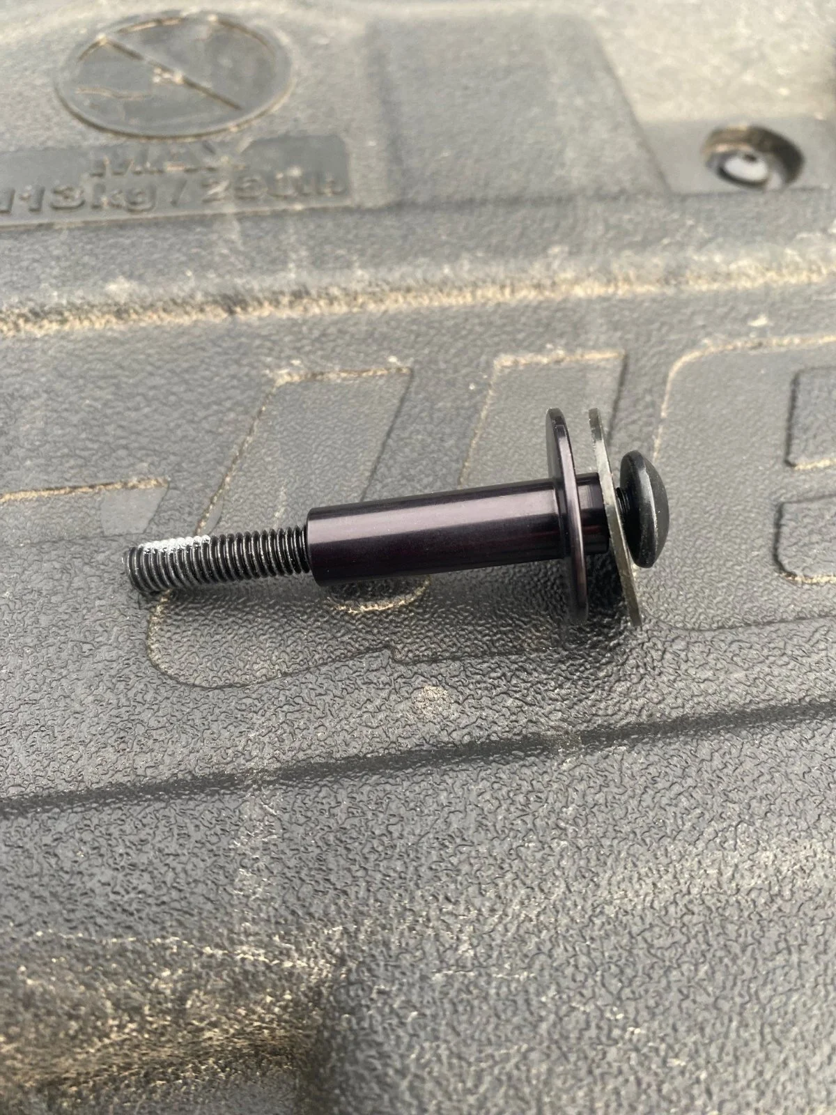

Slight problem where rear door opened while driving, hit a tree and popped out the bolt and cable.  I tested the bolt from the other door and thankfully the threads are still okay.  So I'm looking to order the 3 replacement parts in the pictures but having a problem identifying the ~1" sleeve the bolt passes through.  My dealer "thinks" the part number is 708300737; however, the image on Partzilla shows a small bushing.  I've looked at the parts diagram for the rear door and cannot find this part.  Hoping someone here can help me figure out which part to order.

id probably buy all of them and see.  its a $6 bushing from can am along with some other stuff.  id get 270, 280, 388, and see what happens but i det you still dont get the right stud.  that parts fiche is terrible for that area.
the 708300737 looks like it is in fact a bushing of some sort based on a general search.  something with rubber in it.  does the door have that in it usually?
250000807 is a bolt., which would be 388
sorry not much help, maybe they can get the can am oem service team involved and find it that way.  probably easier in the long run anyway to make sure you dont spend $20 on a bunch of spare washers and a bolt.
