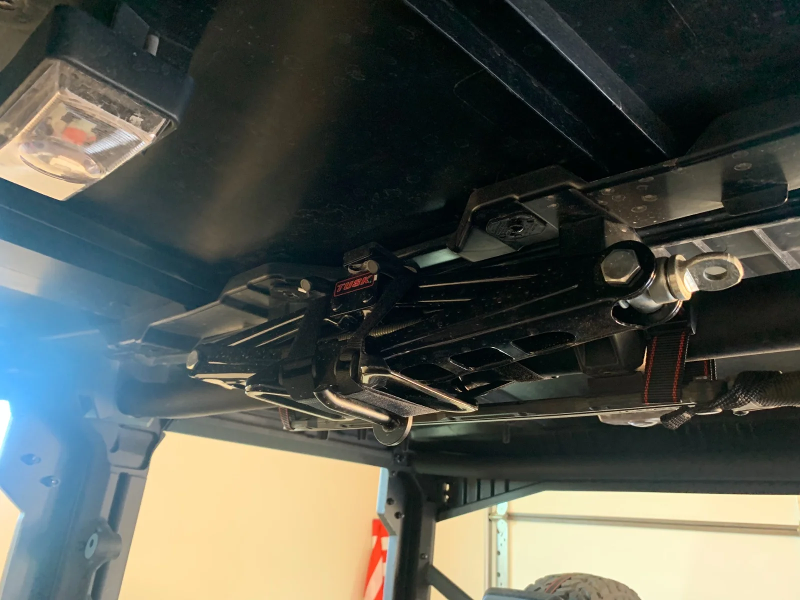

Lots of good options listed here so far. I got a scissor jack from rock mountain atv along with a tusk mount that clamps to the 2” cross bar of the roll cage inside the cab. Plenty of head room, doesn’t get in the way at all. Hope to never need it 🤞🏻. Just another option for you...

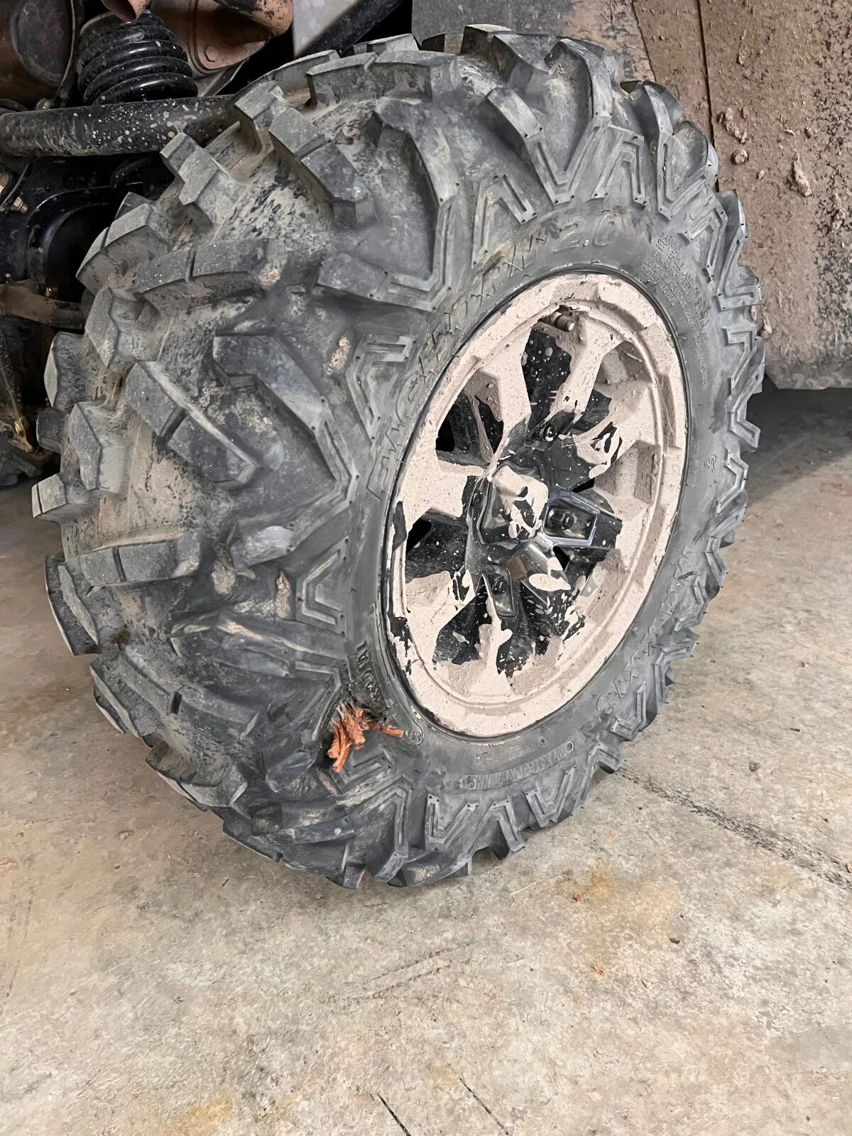

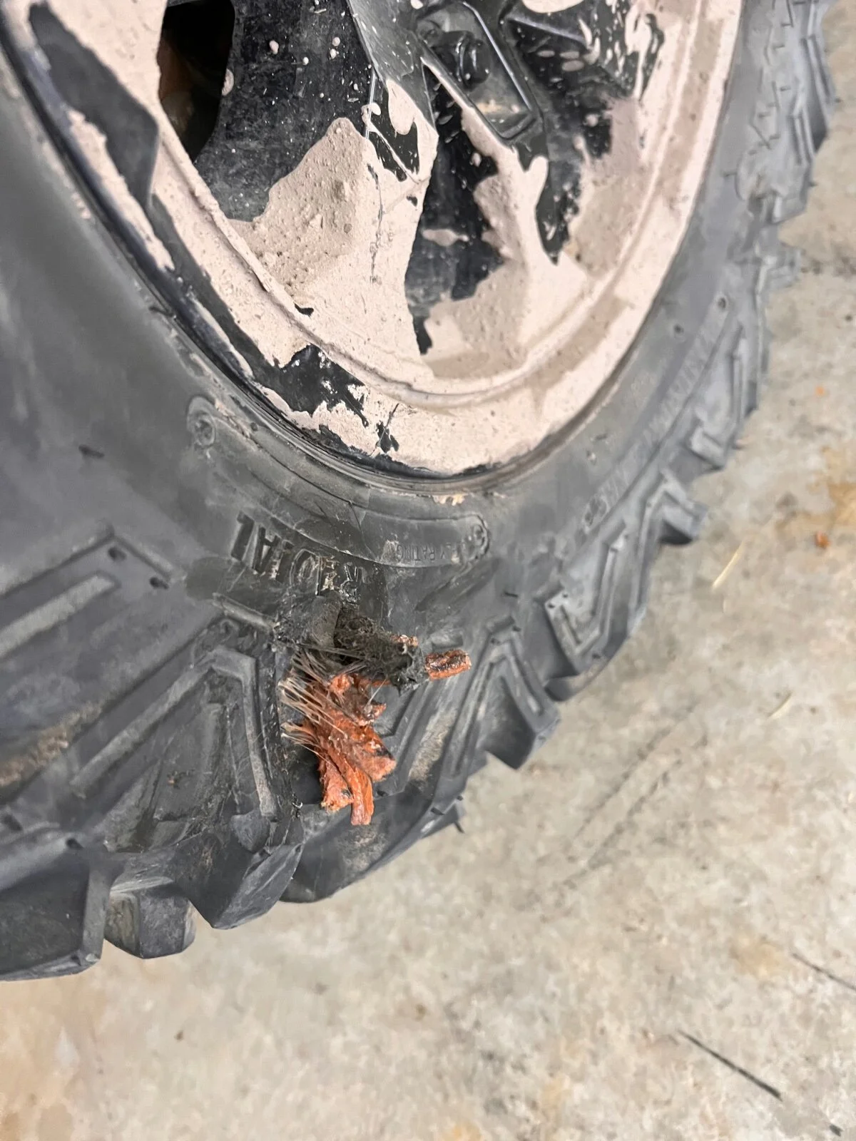

Well it happened- got a flat- tore a 1-1/2” gap in the sidewall of the rear tire.
We were headed over to a friends house, went through the trails 15km to get there and snagged a root or a rock.  Sssssssssss right as we got on the road.
7 homes away from my buddies house.
So after happy hour we jammed 4 or 5 bacon strips into the hole, let it sit, and an hour later aired it up.
Drove back to the cabin, 35 kms of road, this time, and as of this am, it’s still holding air!
We are now getting a spare, if it had happened in the backcountry we would have been screwed.
48 hours later, it’s still holding air.
I don’t think I would trust it for a venture out into the woods.

I really like the idea of the scissor jack secured up above inside the cab. Out of the way and it stays clean. However, you’d need a big scissor jack to lift high enough and may not have room to maneuver it under your machine out in the wild.

So ticked off that I wrecked that tire!  Only 500 km on it, grrr!  Maybe the tire shop will tell me otherwise.
I have ordered two more tires, and a rear wheel.
The new wheel will be a spare, and the two rears will get the new tires, and the spare will be the one good rear tire.  And I will keep the patched tire if its useable.
I doubt that they will patch a sidewall but you might be able to put a tube in it?🤔
Hey BD. That's genius! Have seen many items used for temp plug for a cut tire in back country, but never bacon.  I guess you have enlightened us all on a new required item for our tool kit - grill to cook bacon! -
