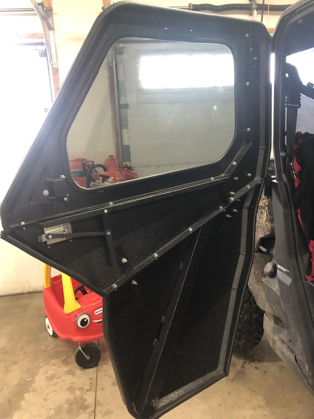

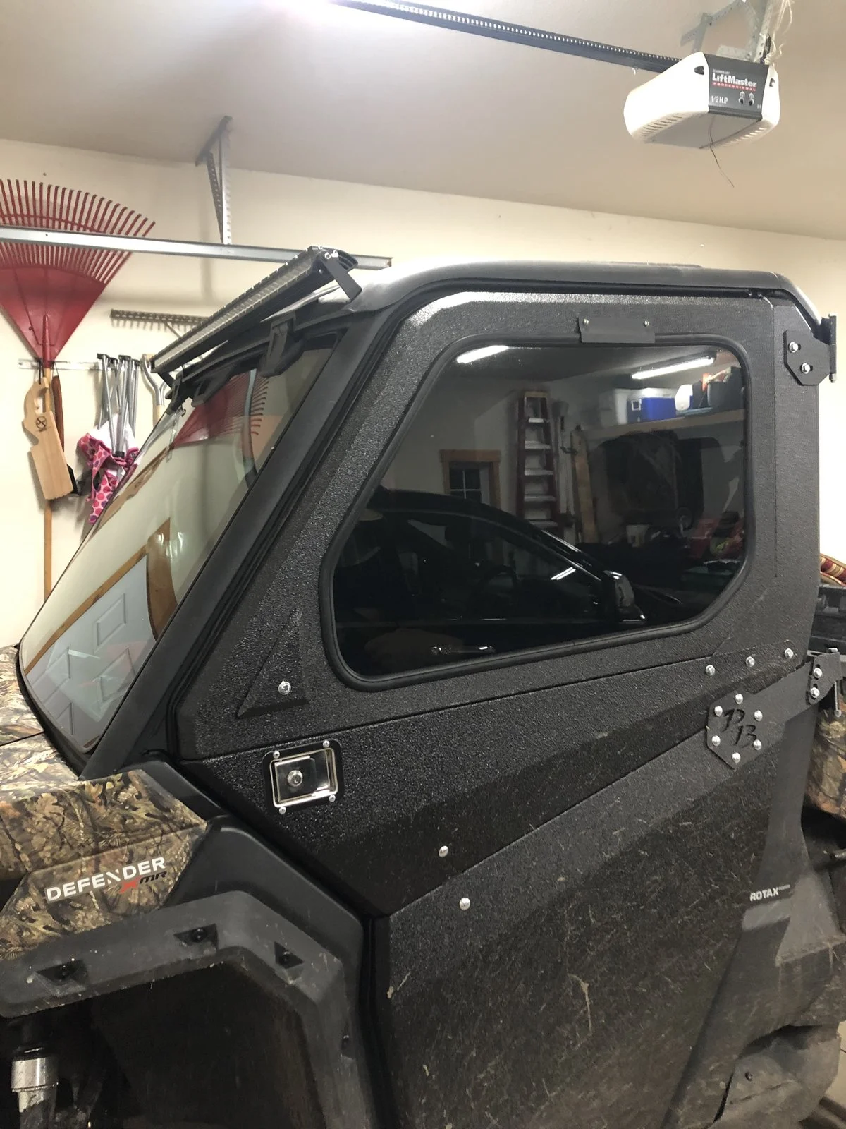

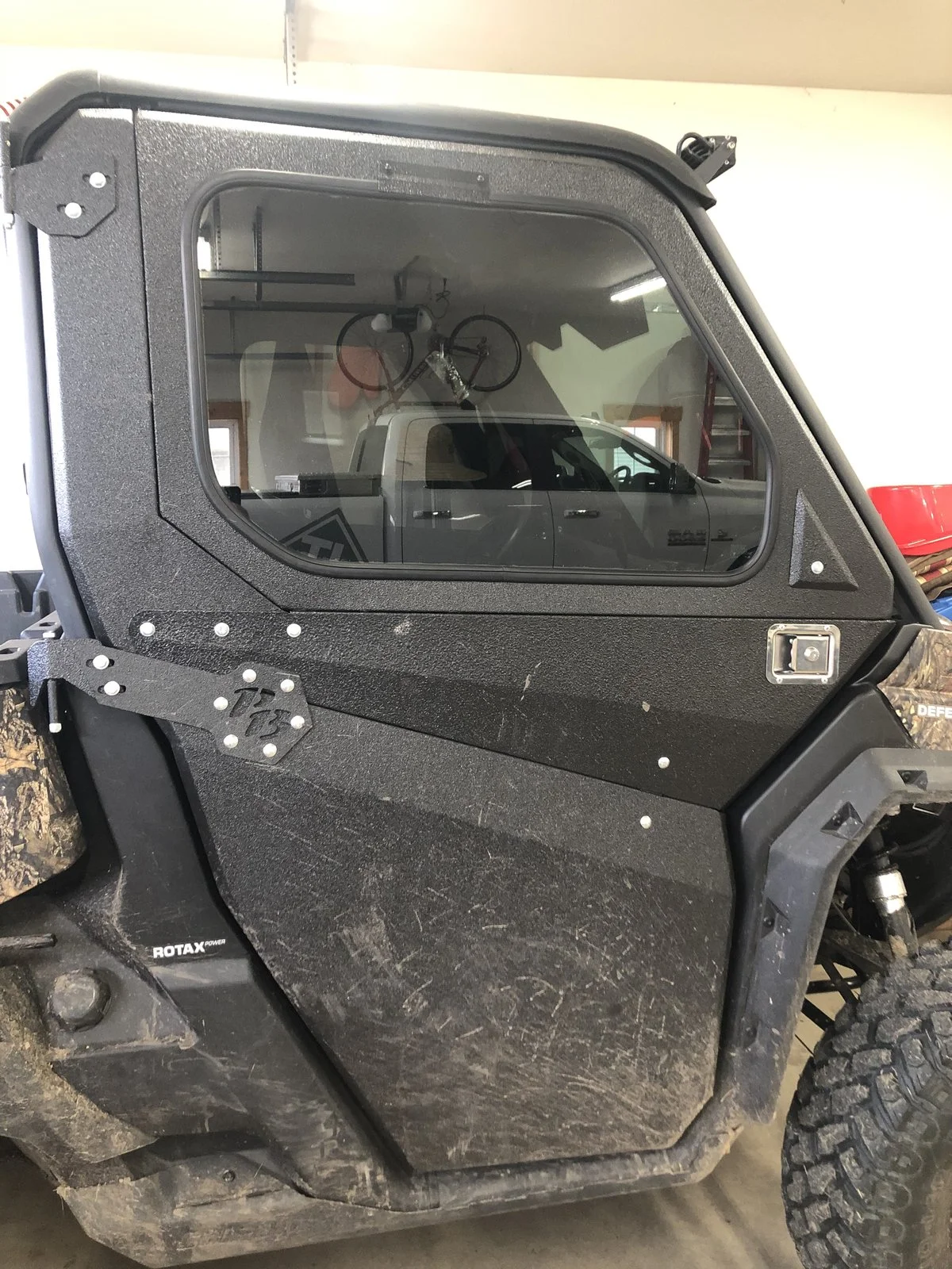

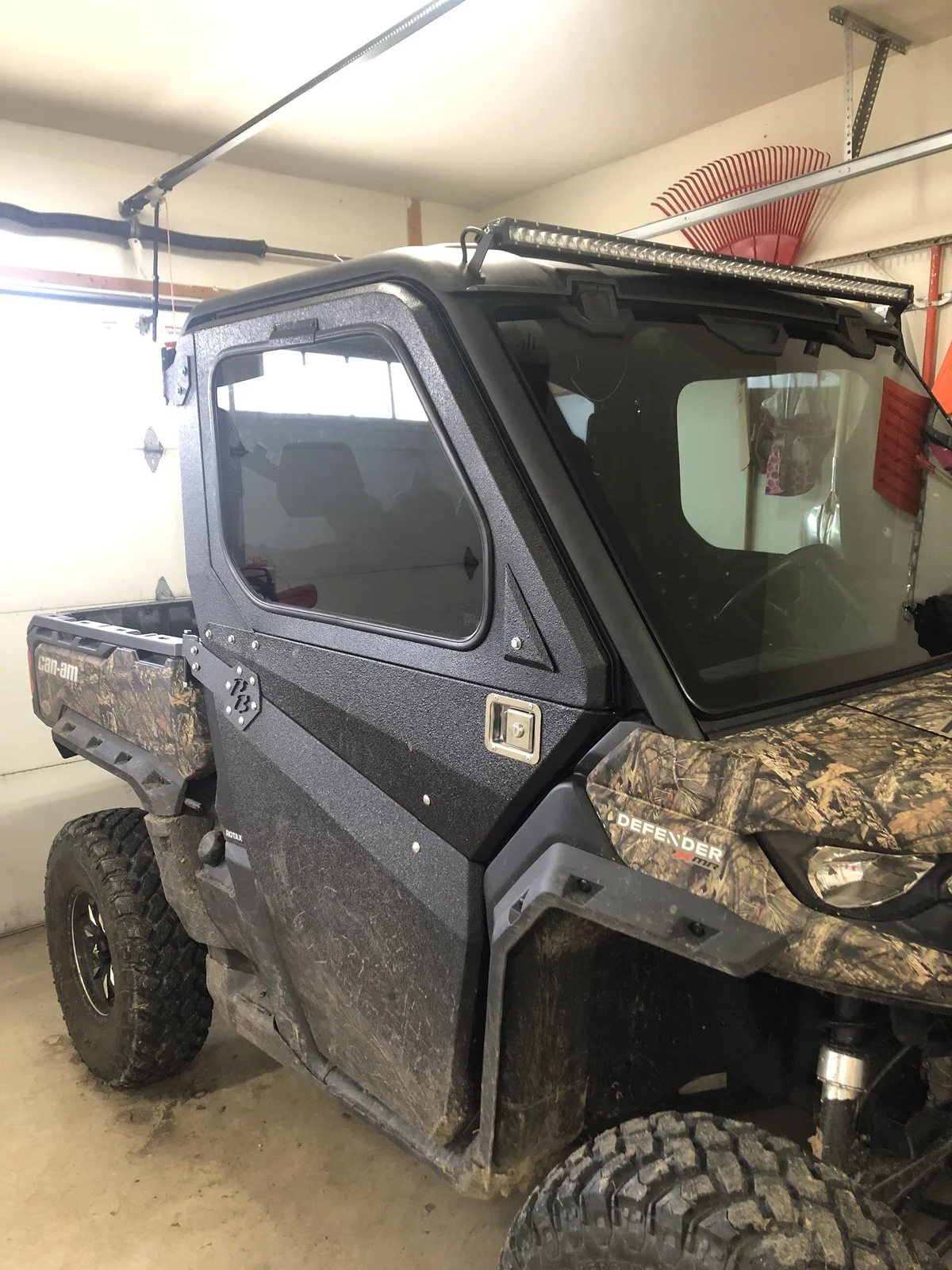

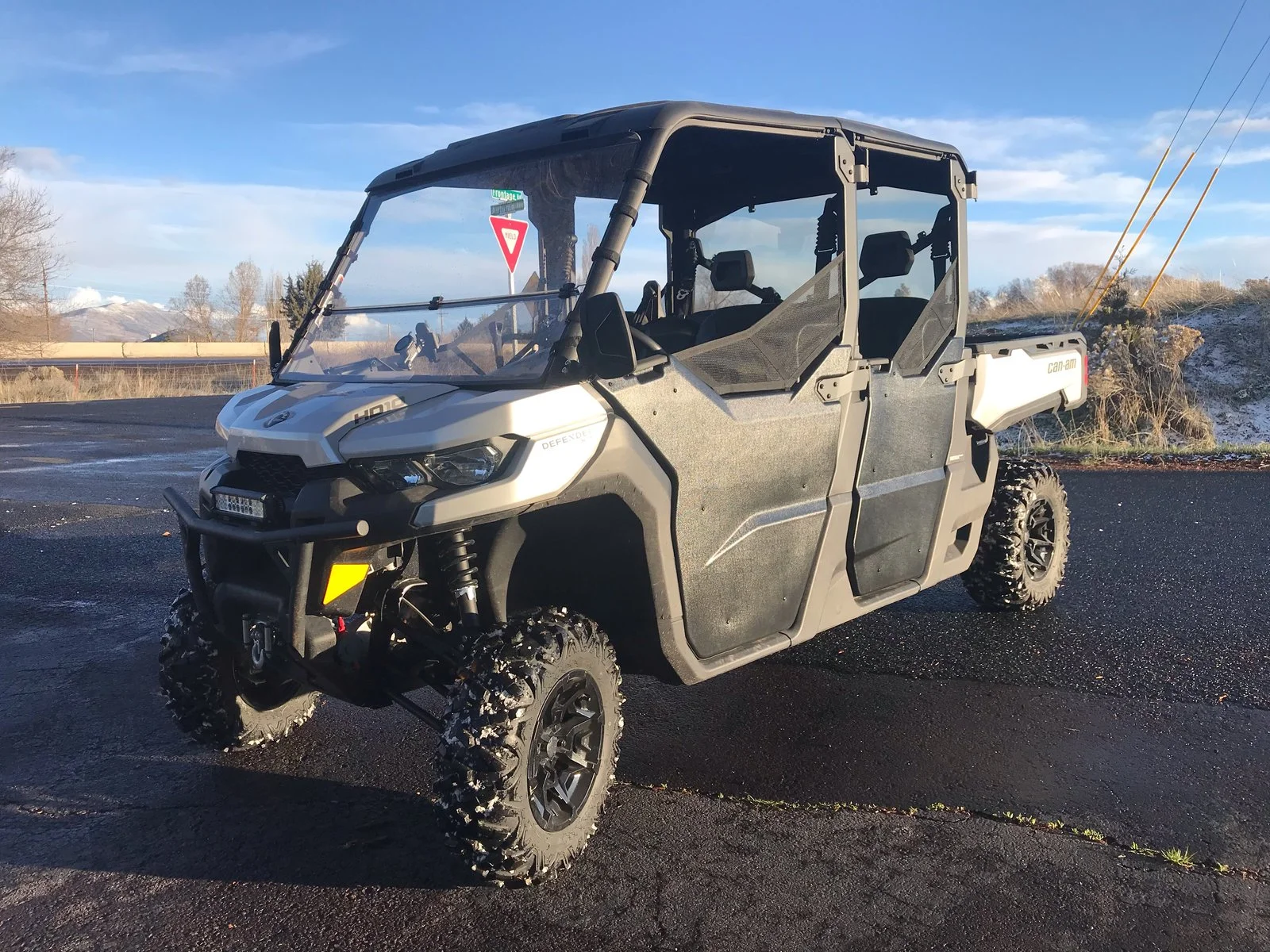

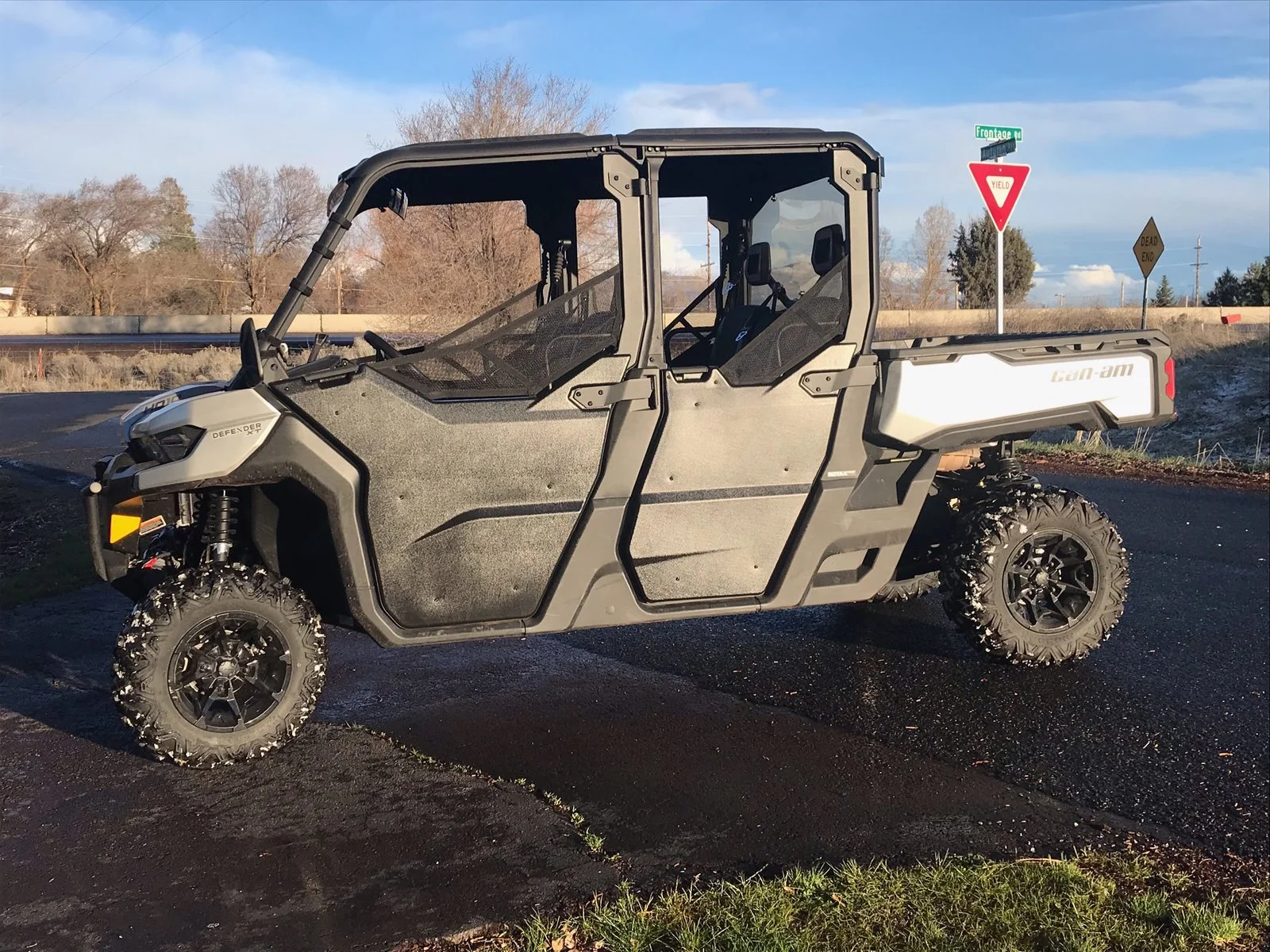

Finally received the window kit for my doors and just thought I’d share with everyone my thoughts and a few pics.
First off I thought the hinges were kind of a weak point, but after some fine tuning and minor adjustments they are working just fine. Originally I had the doors adjusted with too much pressure/stress on the hinges causing them to bend and pull apart.
Second, I thought the doors were defective because they had flown open while trailering. After a few more adjustments I think I have solved this issue. The striker plate was too far away from the striker. I had it set this way because it was easier too open for the kiddos. My bad.
Third, you are getting a full AND half hard door with a glass window for only $1,500 + shipping. The window is stationary.
After all is said and done, I would recommend this door if anyone else is looking for a good half door and full in the same door. That being said, I have zero experience with OEM doors so I can not say either way which door is better.

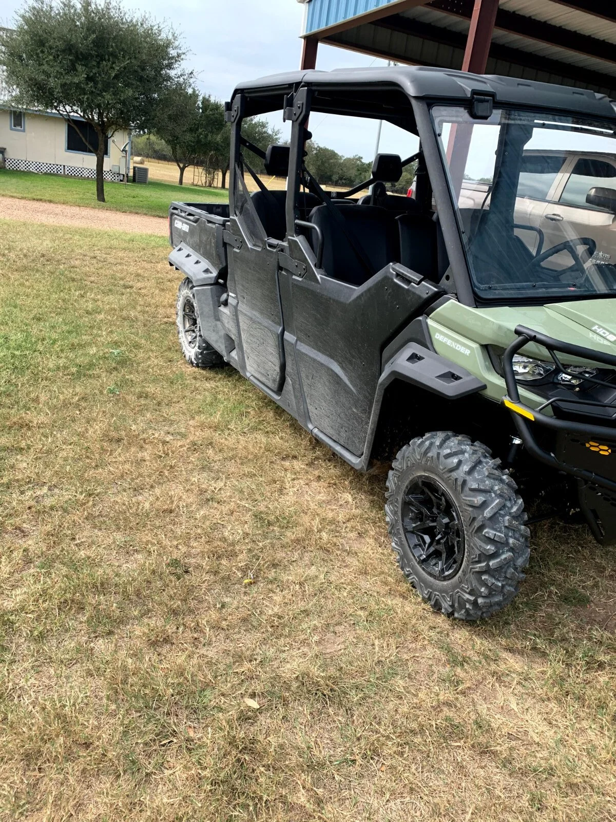

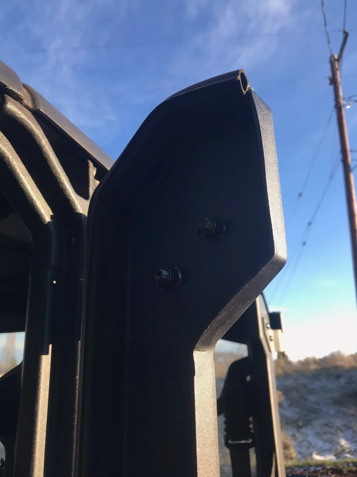

I ended up doing the can-am half doors. Just finished the install and they definitely make a difference with wind in the cab. Think it will help with dust too. I’m pretty sure I can fab a bolt on frame that I can put a plexiglass window into. If I get crazy enough to try it I’ll it it up. A few pics with the new doors. Last pic shows the weatherstripping I used to stop the rattling. Stole the idea off of YouTube, can’t remember the user but credit for the idea goes to him.

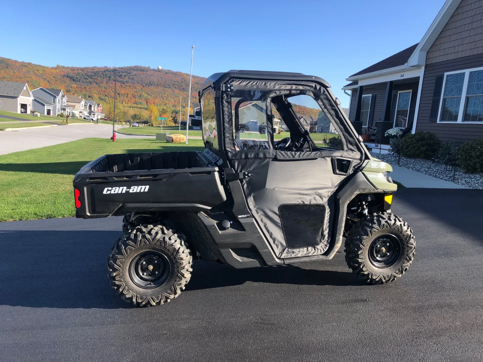

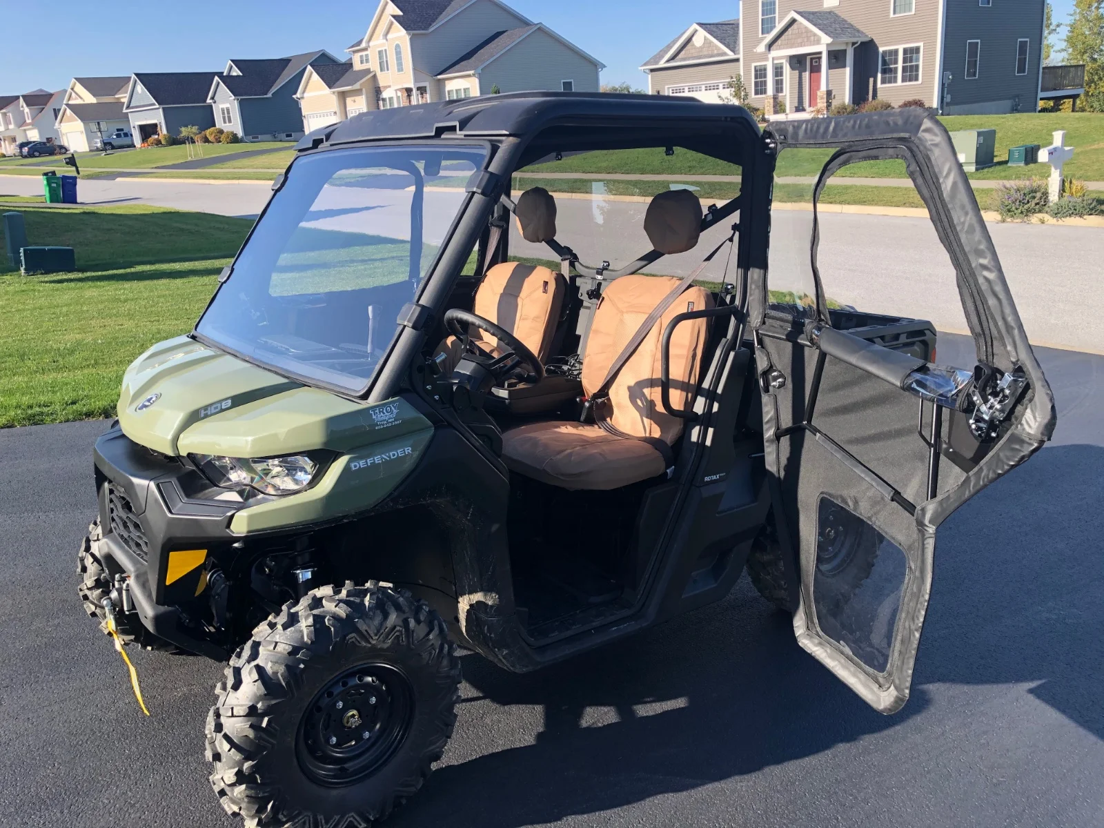

Have you considered the Seizmik soft doors? I found a lightly used set on Craigslist for $600. I think they retail for $1000 here in the USA. Lifetime warranty. I live in Vermont and they have been great for keeping out the worst of the cold while plowing snow. I'll be adding an Inferno heater for next winter which should help even more.
