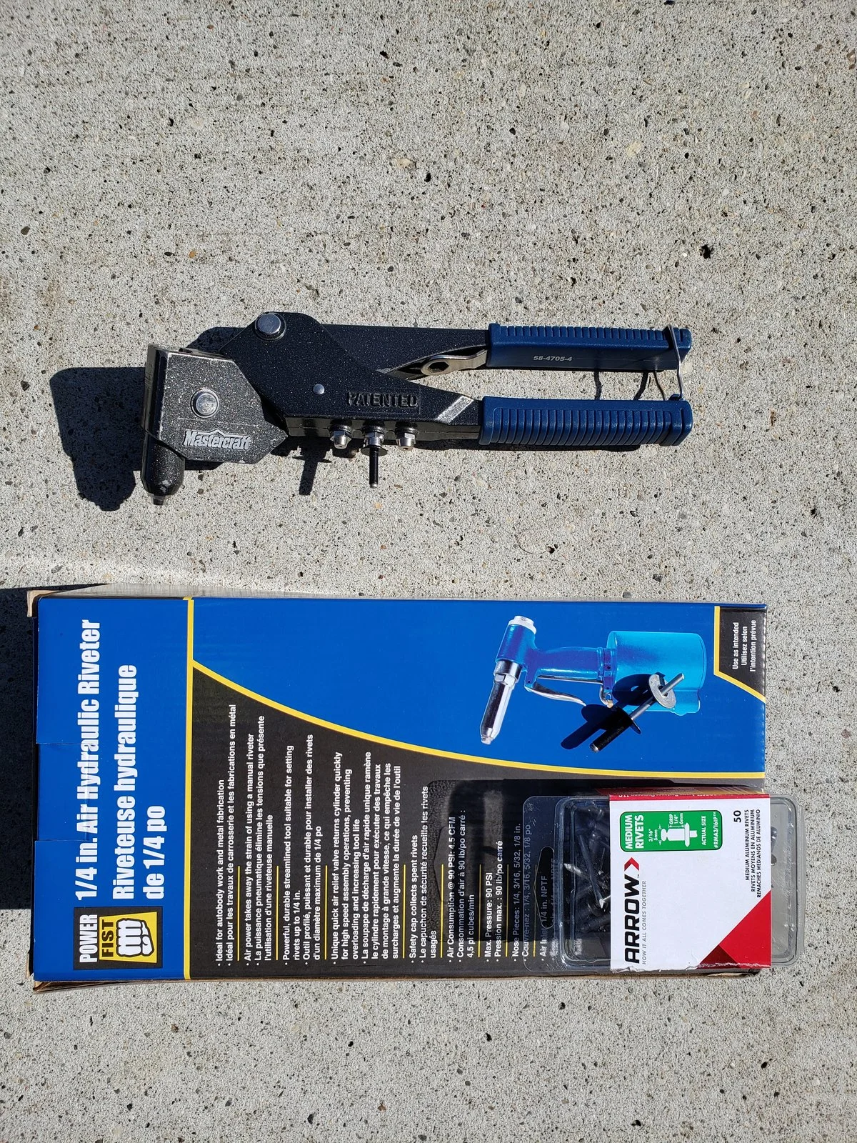

The attached picture shows a rivet in the hand held correct guide, a new rivet with the drilled off head on the shank on the box, a swivel type hand held riveting tool and a pneumatic one in the box. FYI
