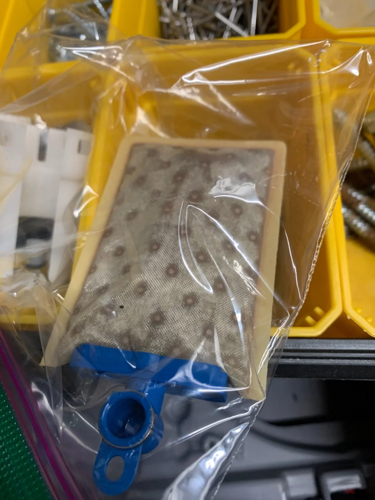

pulled the fuel pump out of the tank. Pump prefilter was a little brown. Very dusty conditions out here in the desert. Bought  some replacements just in case. I’ll change this piece out and post a picture of the old one. Hard to tell if mine is actually clogged or being restrictive to fuel flow. Maybe this was the culprit?

Thanks for your insight Andy! I may be wrong but I believe the quick trip gas station I fill up at out here in Arizona is “top tier” gasoline which is just an additive package when fuel is ordered, with a maximum of 10% ethanol. I’ll double check that next time I stop by. I would assume with our dry climate out here, the fuel should be less prone to moisture absorption? Maybe that theory is completely wrong, I have no idea.
 When I changed the prefilter on the pump, I didn’t notice any moisture or water in the tank. Keeping my fingers crossed this was just a fluke thing. Thanks again for your help!!
