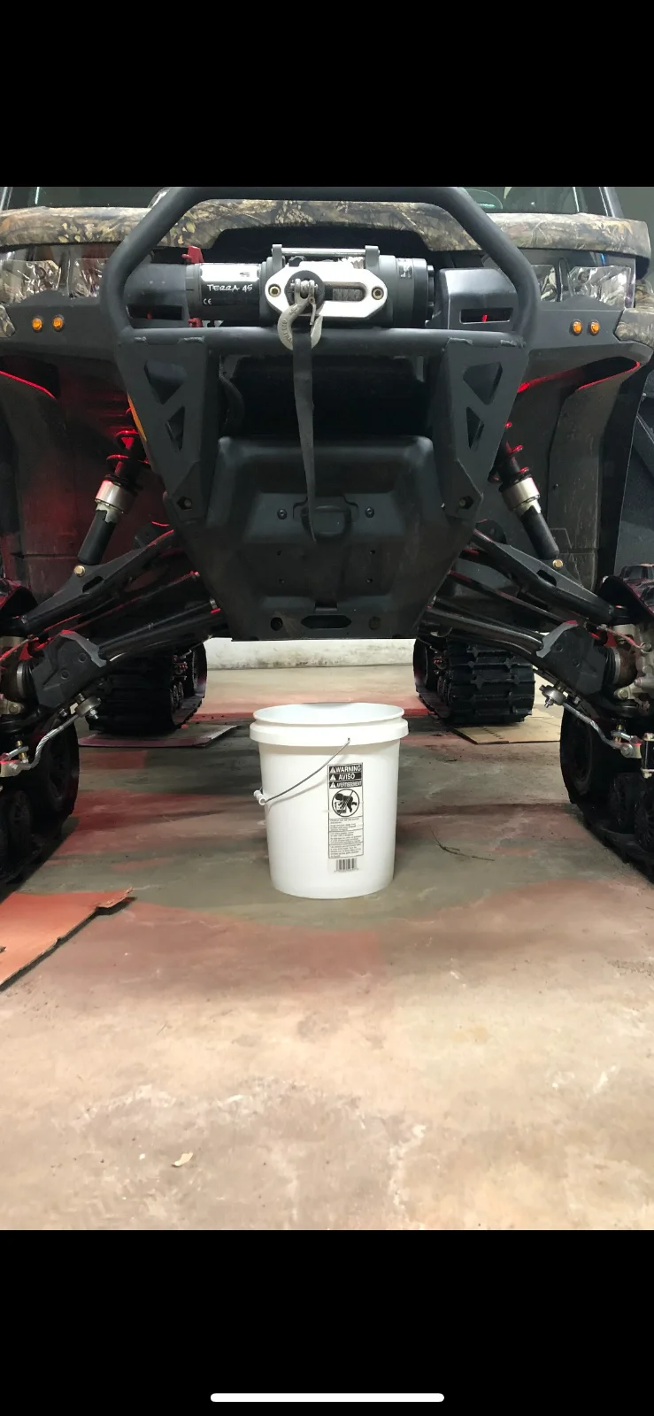

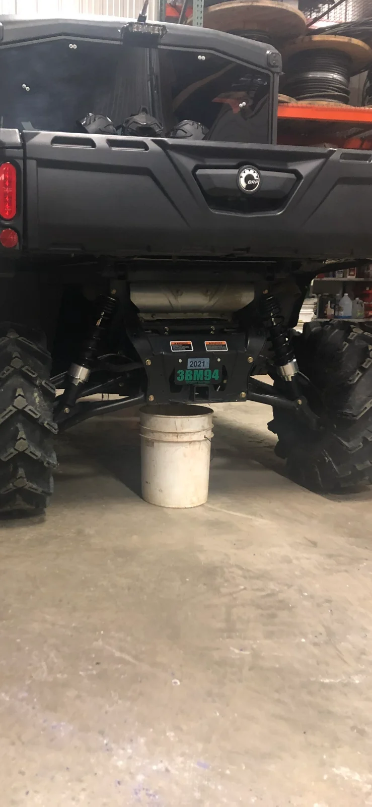

attached is a picture of the spacers installed with the OEM 30 inch cryptids standing over a 5 gallon bucket.
Total of 18 inches of clearance
Just for fun I also attached a pic of the clearance with camso tracks and the lift.
