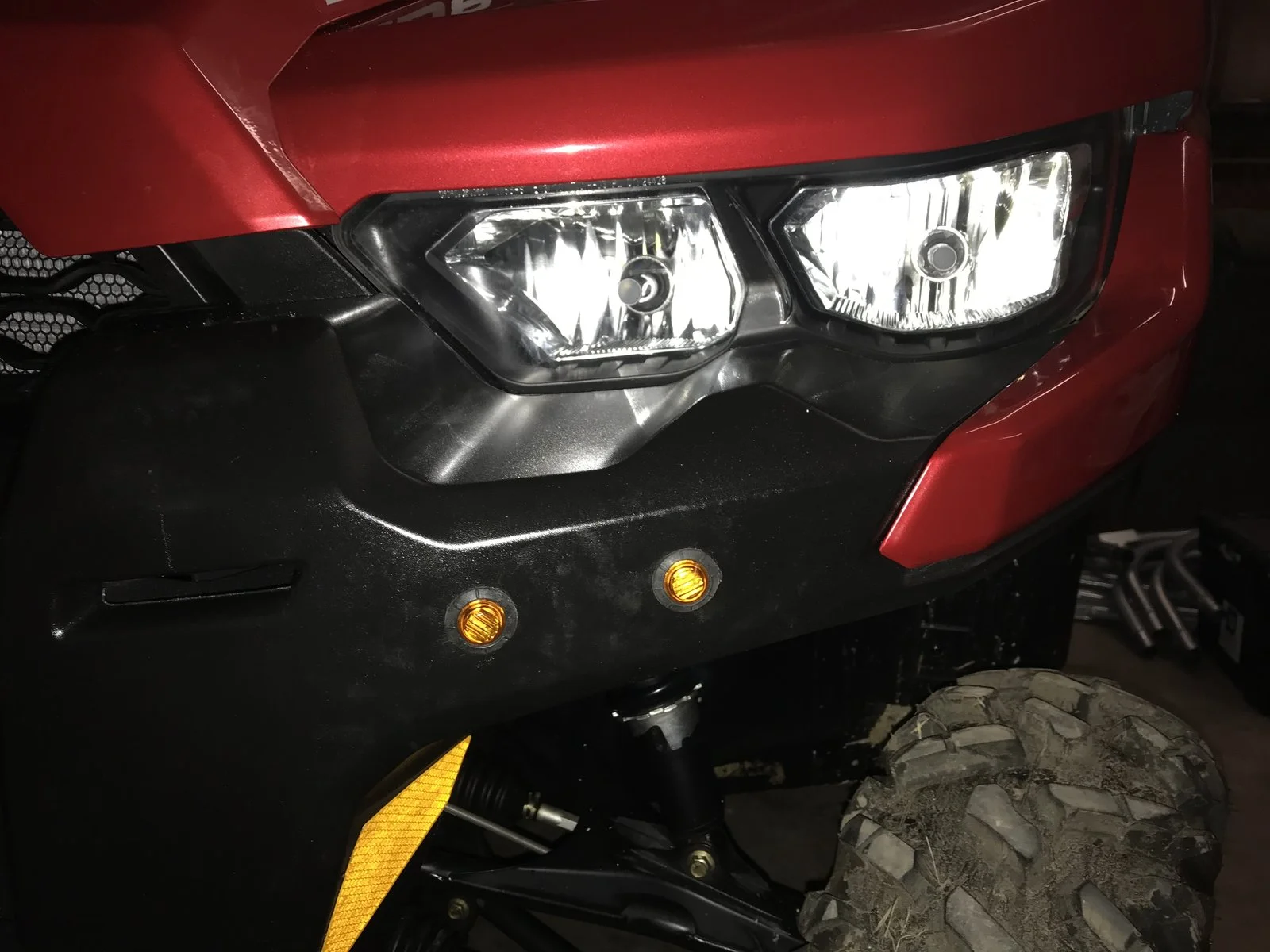

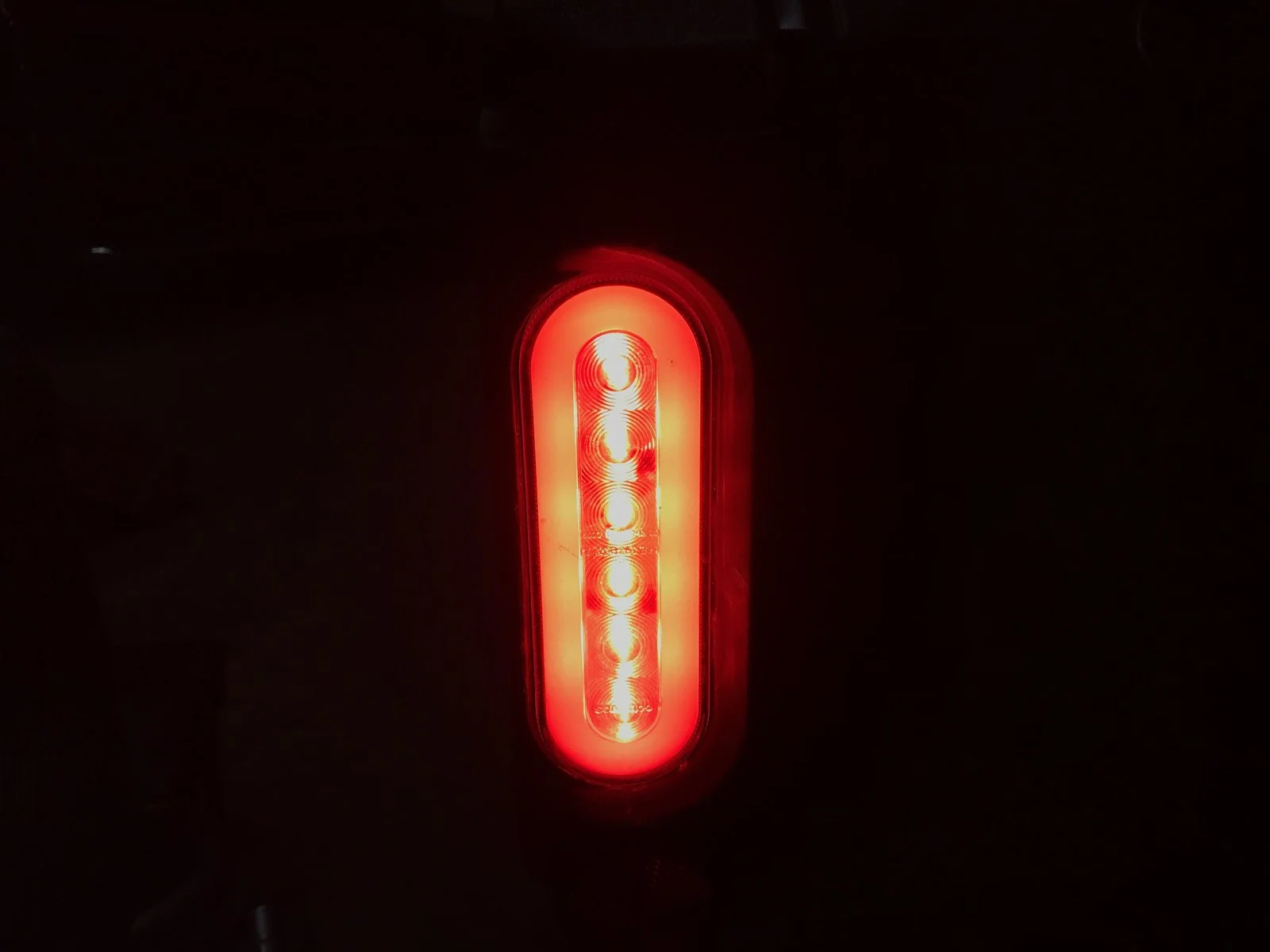

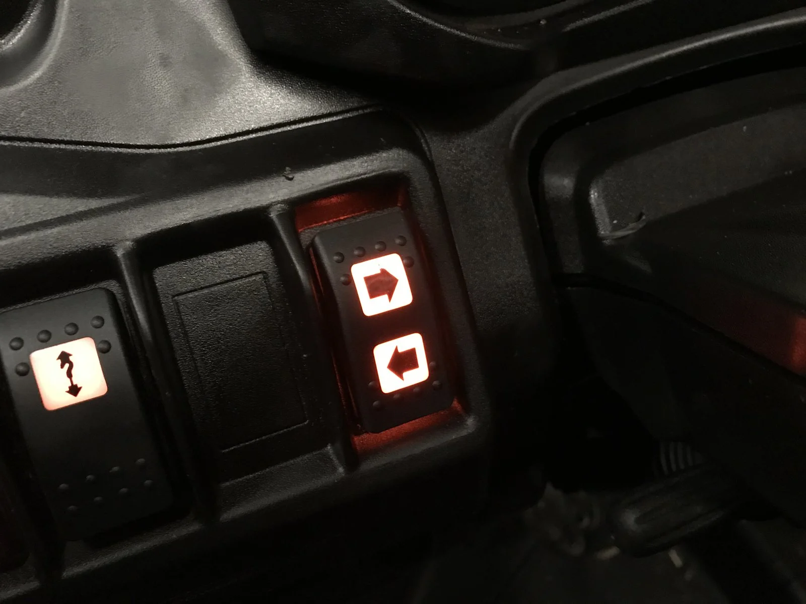

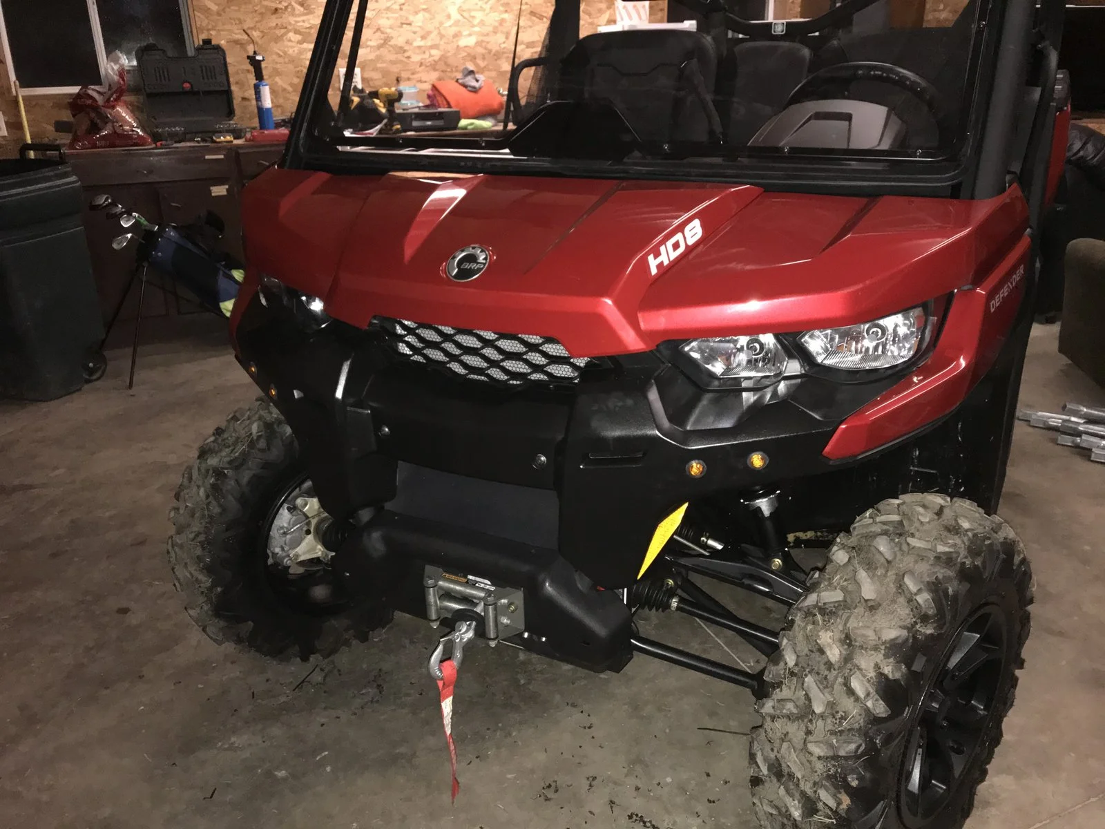

My local dealer had the Corbin Plug N Play kit, I installed it last night it worked and looks awesome.
Ktop - can you post a picture of your turn signal kit installed?  I’d love to see it - May do this too.
Also - did you get the horn with it?
-Mark
I don't think I've seen this kit before.  I think I might have to order this one.  I wasn't really a fan of the horn that seemed to come with almost every other plug and play kit.  Thanks for the help!
Any pointers on install?
No, I didn’t get the horn. Dealer recommended buy a “air” horn and putting in glove box to be road legal.  I like how it has a rocker switch rather than a car style turn signal handle also it used factory tail lights rather than drilling more holes. Install went pretty well just would recommend not using a 3/4 in drill bit on the fronts, maybe a little smaller. I had to silicone the rubber grommets in because were loose. Otherwise the kit came ready to go, even had the push pins in the correct locations to go into factory frame holes.
sorry not good at taking pictures
Looks good to me. Thanks for the pics. Definitely going to have to get this one. Seems nice and simple
