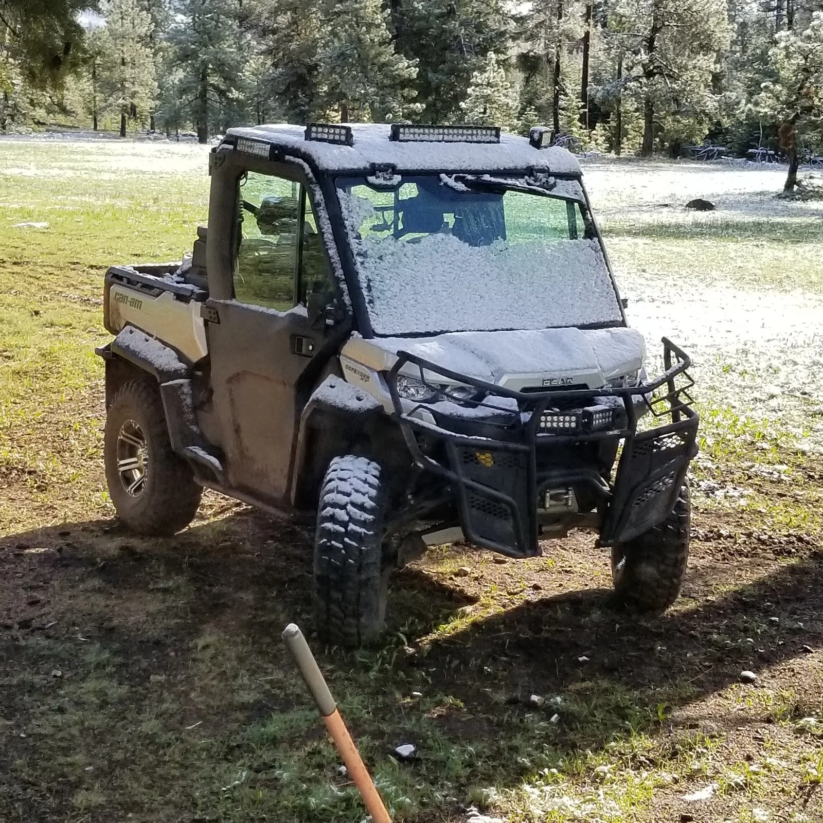

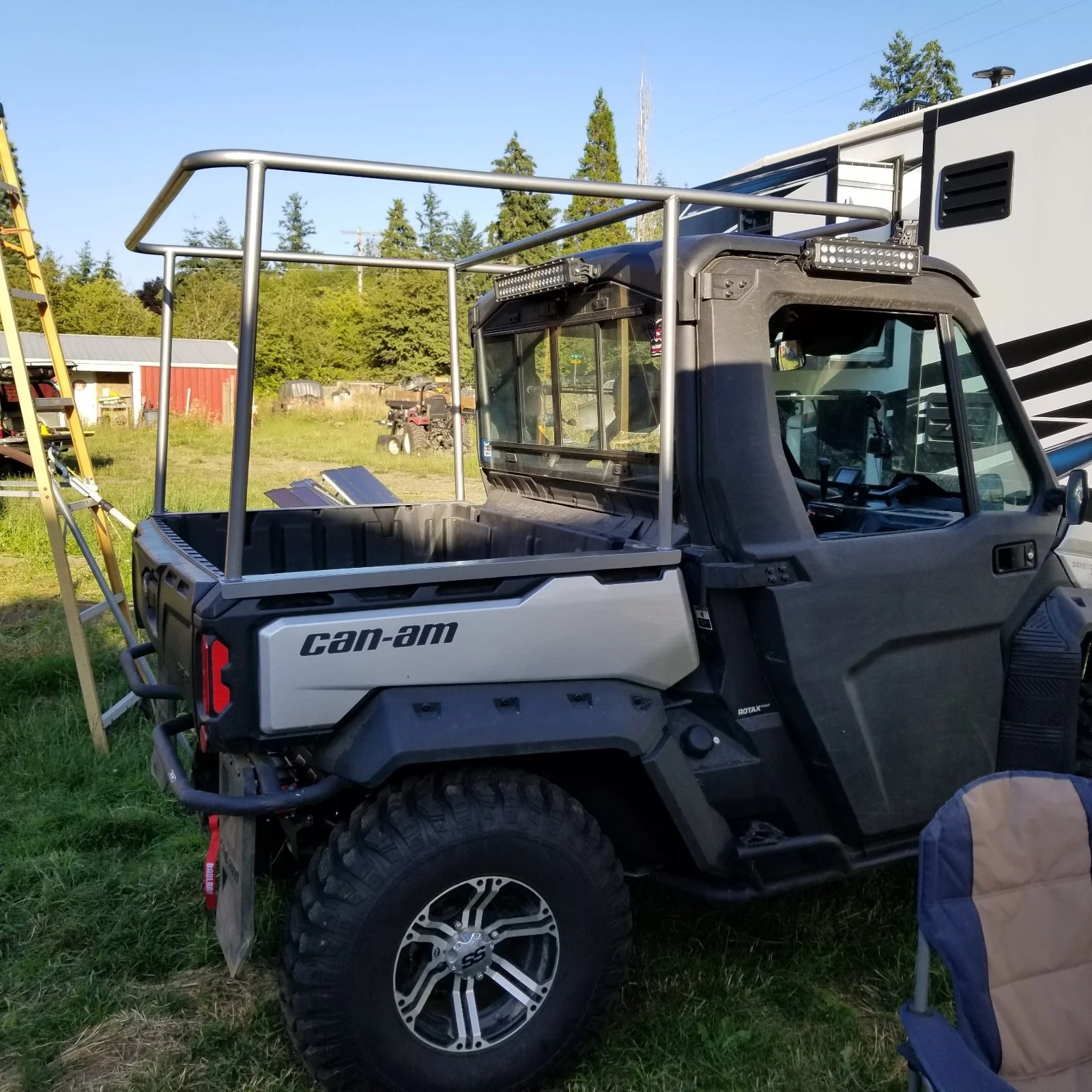

As for lighting?? I went cheap!! LED bulbs are LED bulbs... So why spend the money on a name??? I went with Harbor Freight lights.. Nice thing was... The bolts on the top of the door fit perfectly with the mounting brackets so I mounted one on each door as well... used a rubber trans. plug to make a waterproof seal at each light.... 8 in total...
Good luck!! It really depends on what you want/need...
Those fender flares really look nice. I have a Defender Limited on order & am uncertain whether to use the CanAm product or an after market set. What kind are those you have?

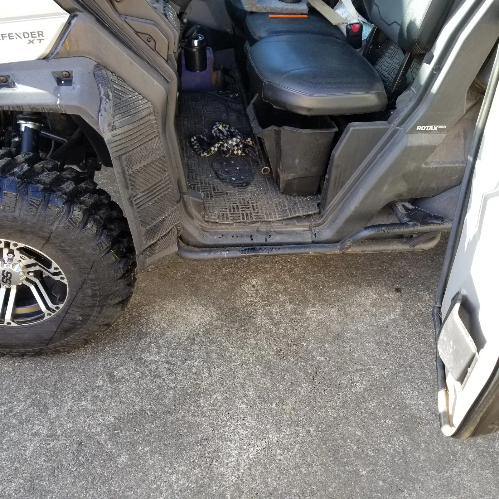

These are the OEM full flares. I've had to add to the fronts since the 32's... was an easy fix... took a rear mud mat for a mini van, cut it in half and fitted it to the flare. Now they work WAY BETTER...

For sure flares... I ended up having mud in the cab even with them on with the original wheel/tires
