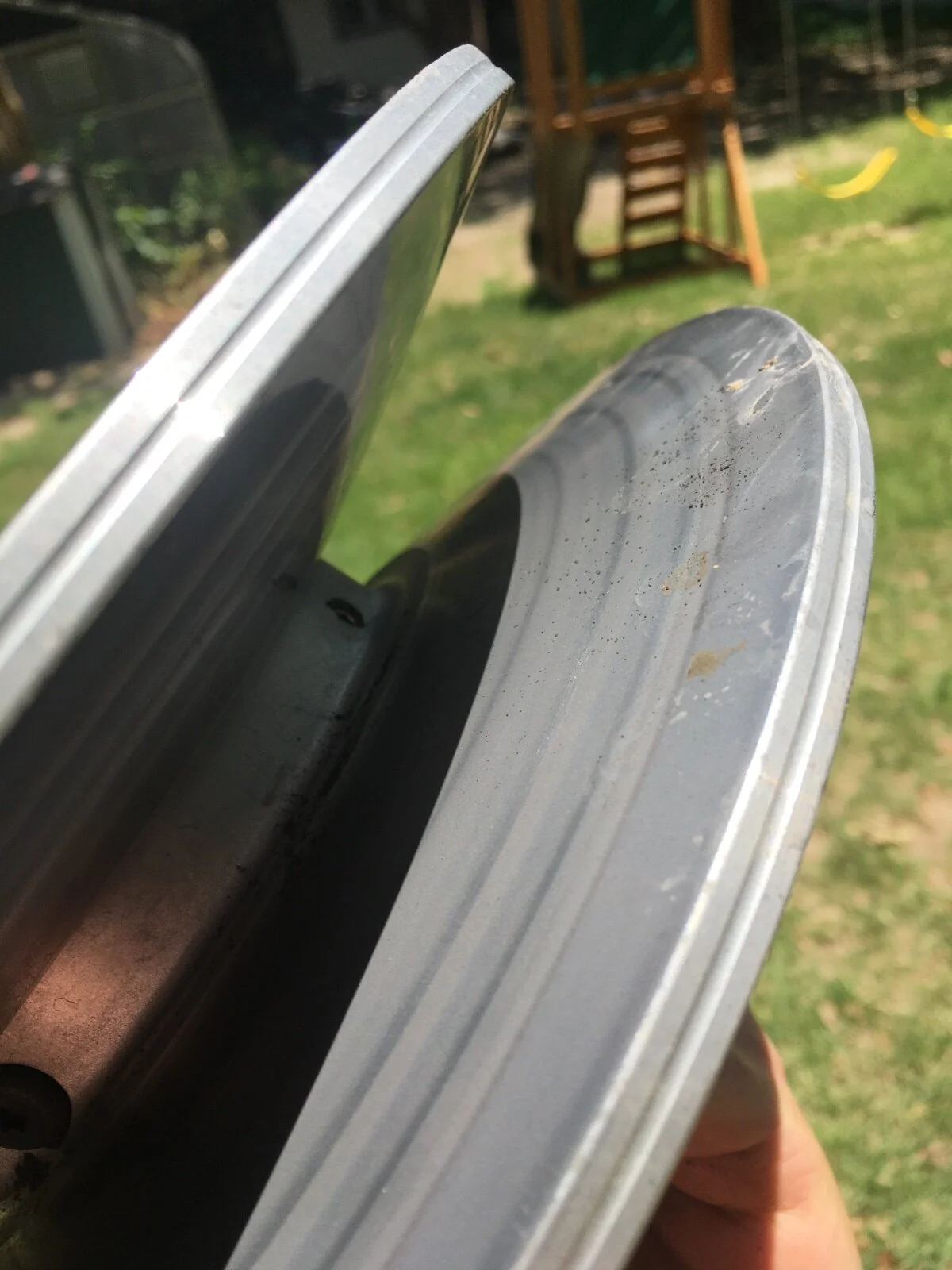

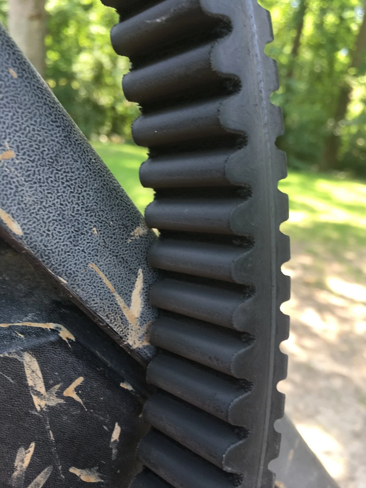

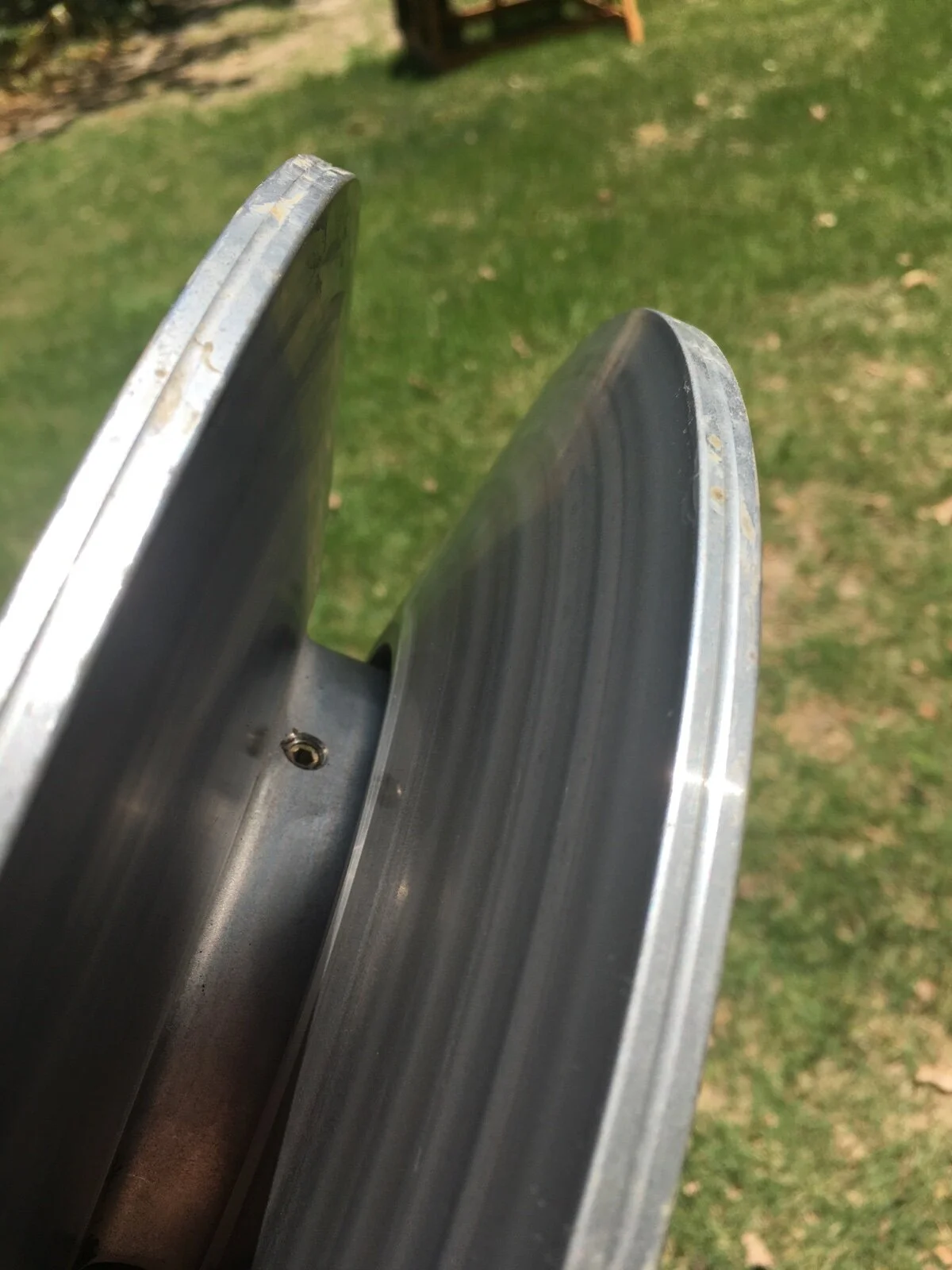

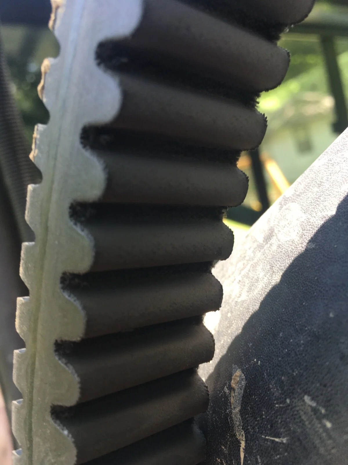

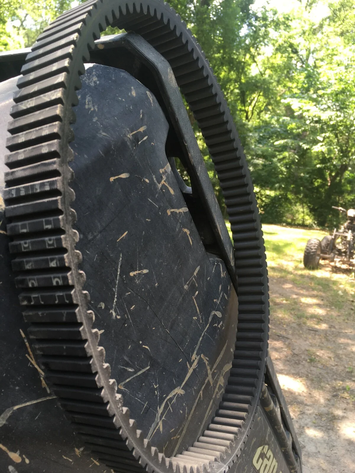

Got belt off.  Am I missing something here?  It doesn’t appear to be worn anywhere to me.
When I had the cluch compressed with the belt tool there was a rattle in the secondary clutch.  Not there with the clutch not compressed. Is that normal or do I need to take it apart and look for broken rollers?
