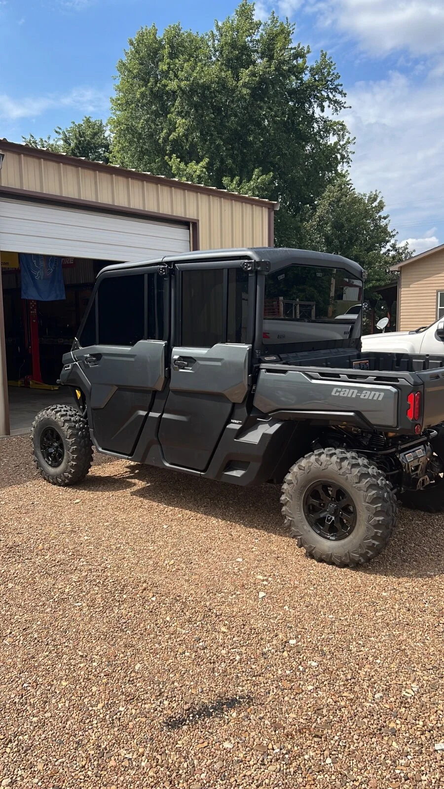

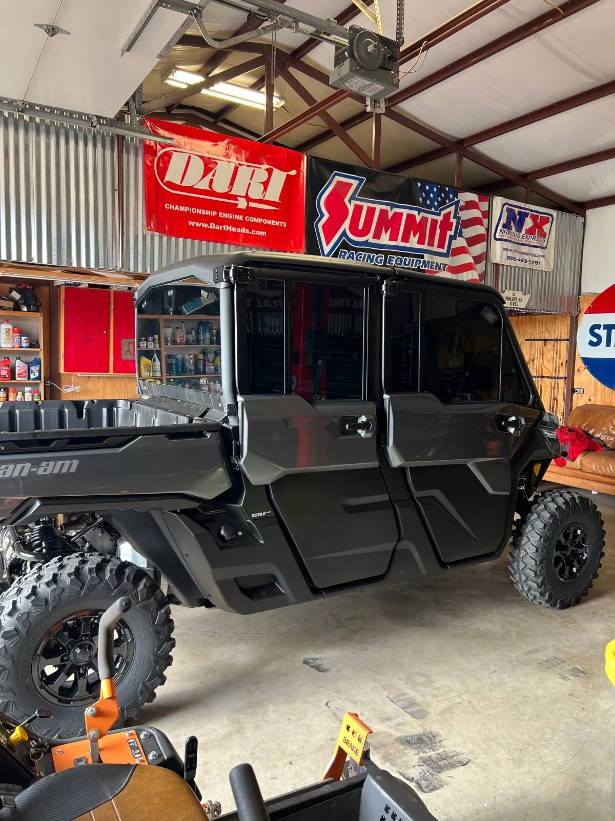

I added a 15' light bar up front and a pair of 4 bulb leds fot the rear. I also added 10x 14x30  10ply tires, then under seat storage box and cooler

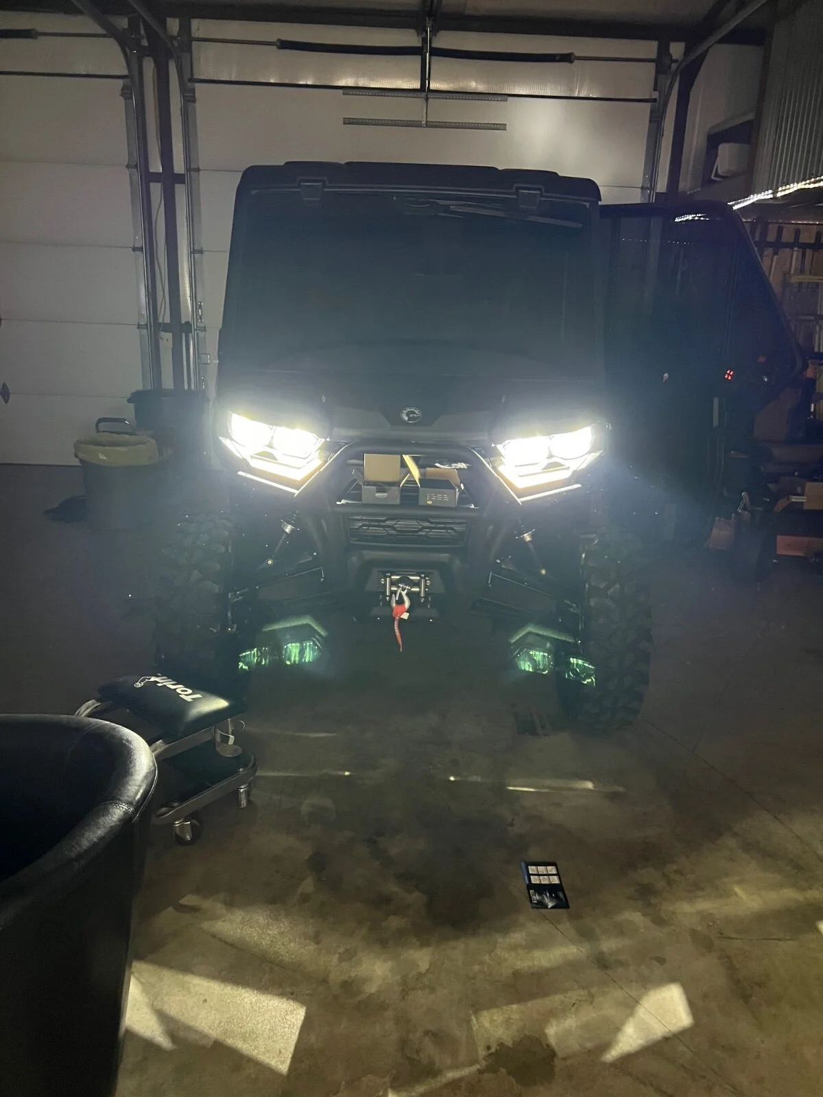

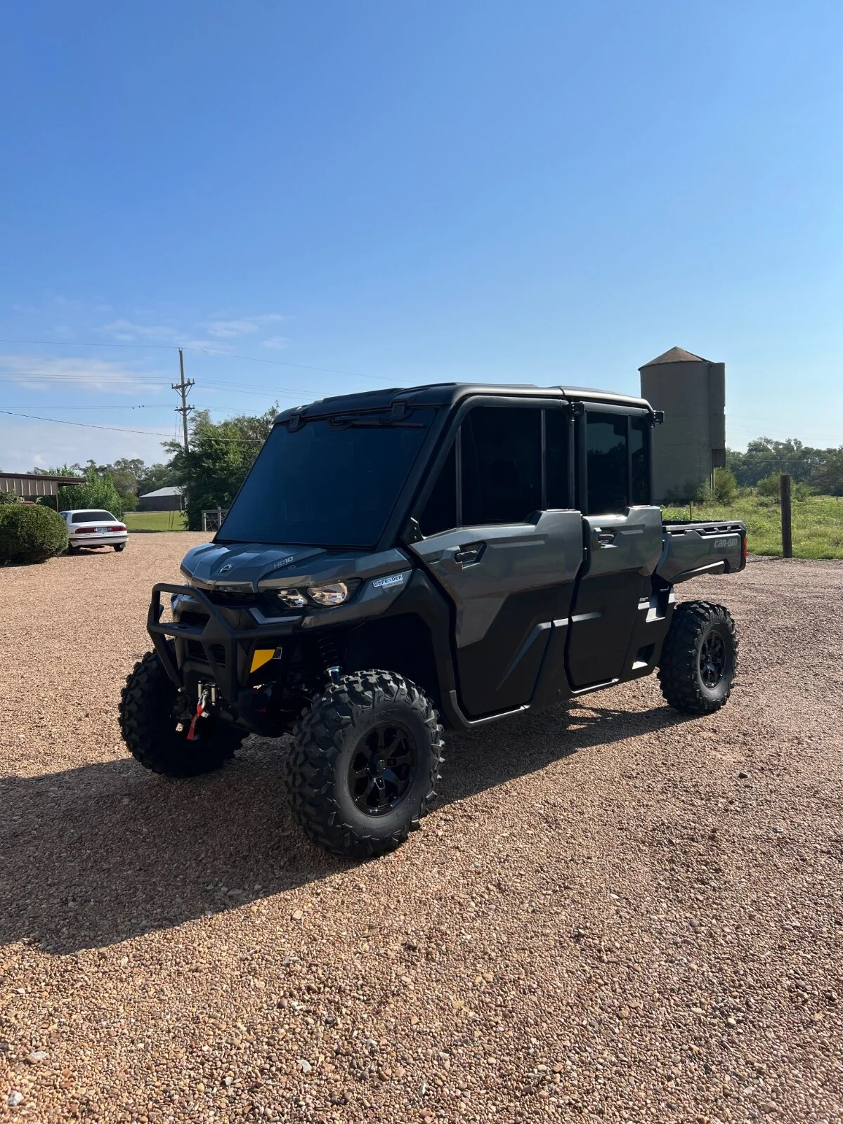

Got the BeamTech H11’s installed on the buggy last night. Huge difference. After reading several posts on this subject I thought it sounded like a good thing to go with the fanless option. Included pictures of the new tint as well. Went with 25% on front windshield with a 5% brow, and 10% on all the sides and the back. AC worked great before and works much better now. Thanks to all the other memebers posts that helped me make up my mind on stuff.

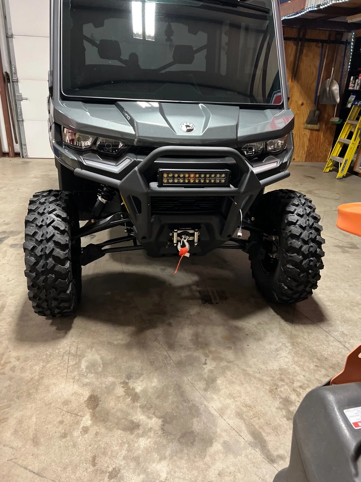

Thank you, I have added the double row 12" rough country blacked out creed light bar with driving light on the front, and the 30" single row rough country light bar underneath the bed at the back. Check them out on the rough country web site, comes with the brackets you need for the defender and everything. Wiring was simple since Can Am run several accessory wires for us.
I also added the under the seat storage bins with top (Rough Country) x 2, and two of the open top storage bins for the middle seats, and a cooler for one of them.
Can you walk me through the wiring you did? I am looking for a "plug and play" option for lights exactly as you have mounted.
Mount the light bar, then raise the center section of your hood, there will be a group of wires under there that have the female end of a bullet connector on all of them. You will need tie into those because they go through the firewall and the other ends of those wires are behind your panel where the ignition switch, and other rocker switches are. Remember which colors you tie into. There is a bus bar with two studs behind the panel you have already popped out, left side is ground, right side is hot with the key. Follow the directions that come with the light, you will have one hot for the light bar, one hot will be for the driving light that will come on when the switch is on, other one is the ground. If you get your rocker switch off Amazon follow the direction that comes with it. Pretty simple plug and play, hide your harness the best you can. There are two holes beside each other under the hood, I used those holes to mount the relay's. I will comment of the back light later today. Good luck, don't let it intimidate ya.
