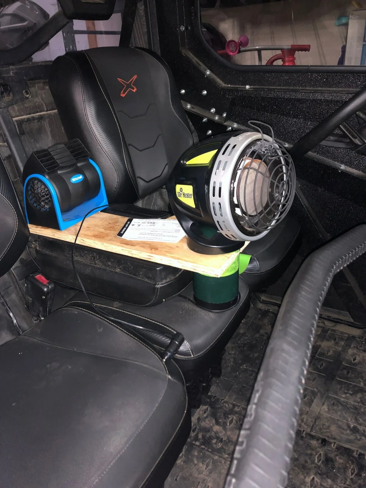

Short of actually putting in the OEM heater, which is the best option (though spendy and labor intensive), I've read about people using the small mr buddy heaters.

This is what I did until I can install an actual heater.  And honestly, its kind of nice.  It heats even when the machine isn't running so it's nice and warm when I get back into it after letting it sit for a bit.  Might leave this set up in it even after I install an actual heater.
