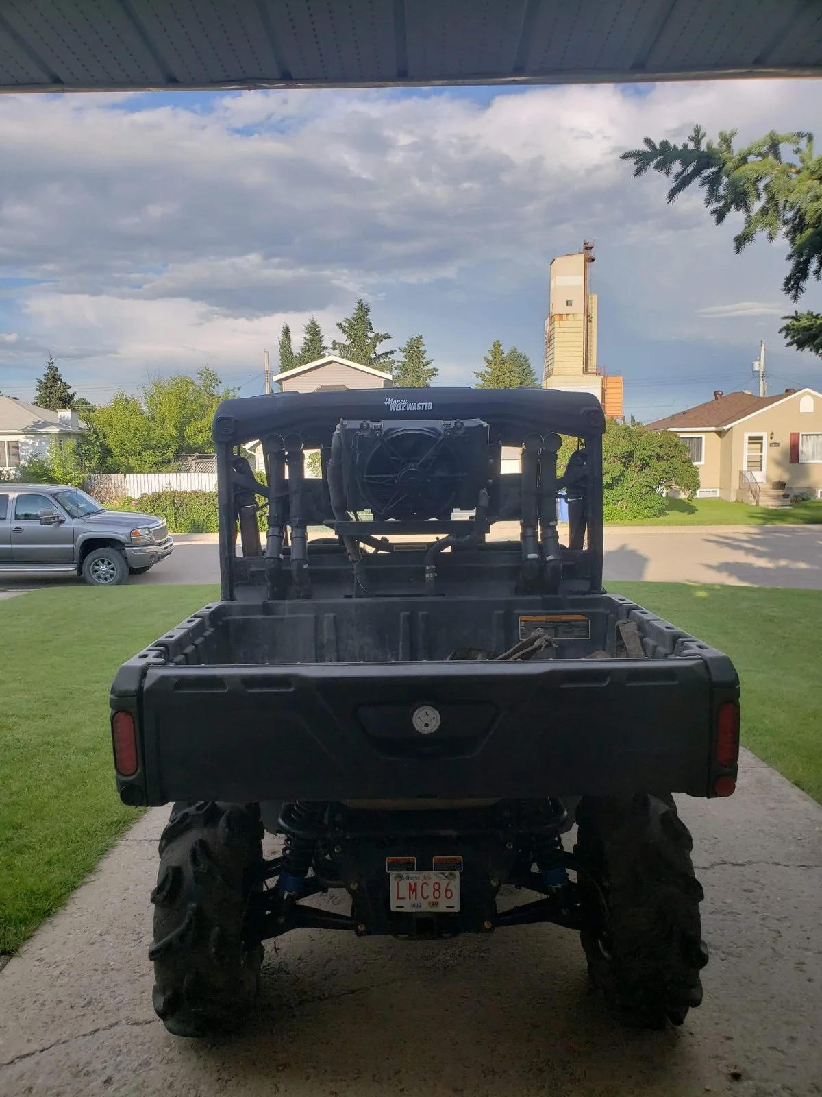

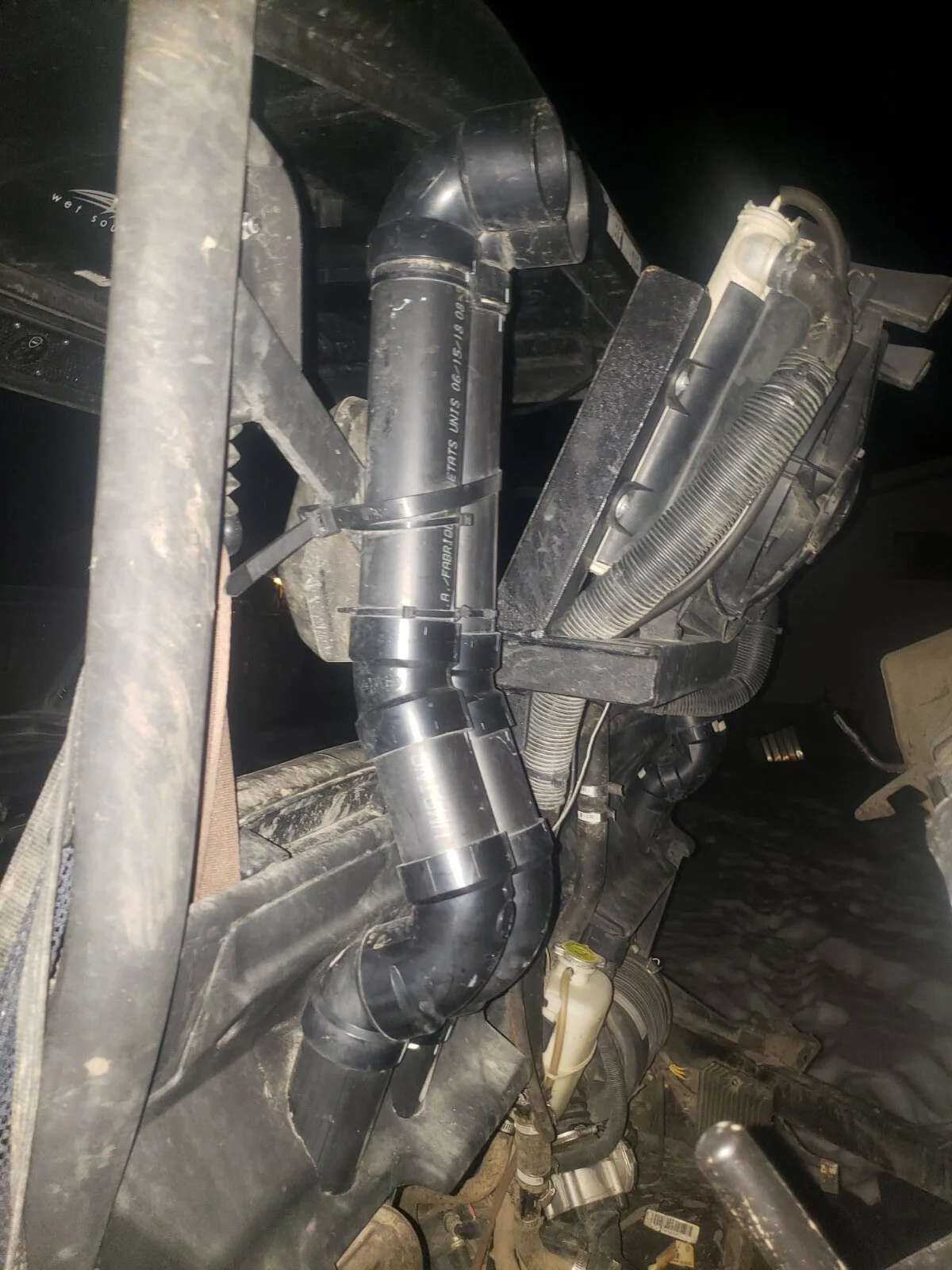

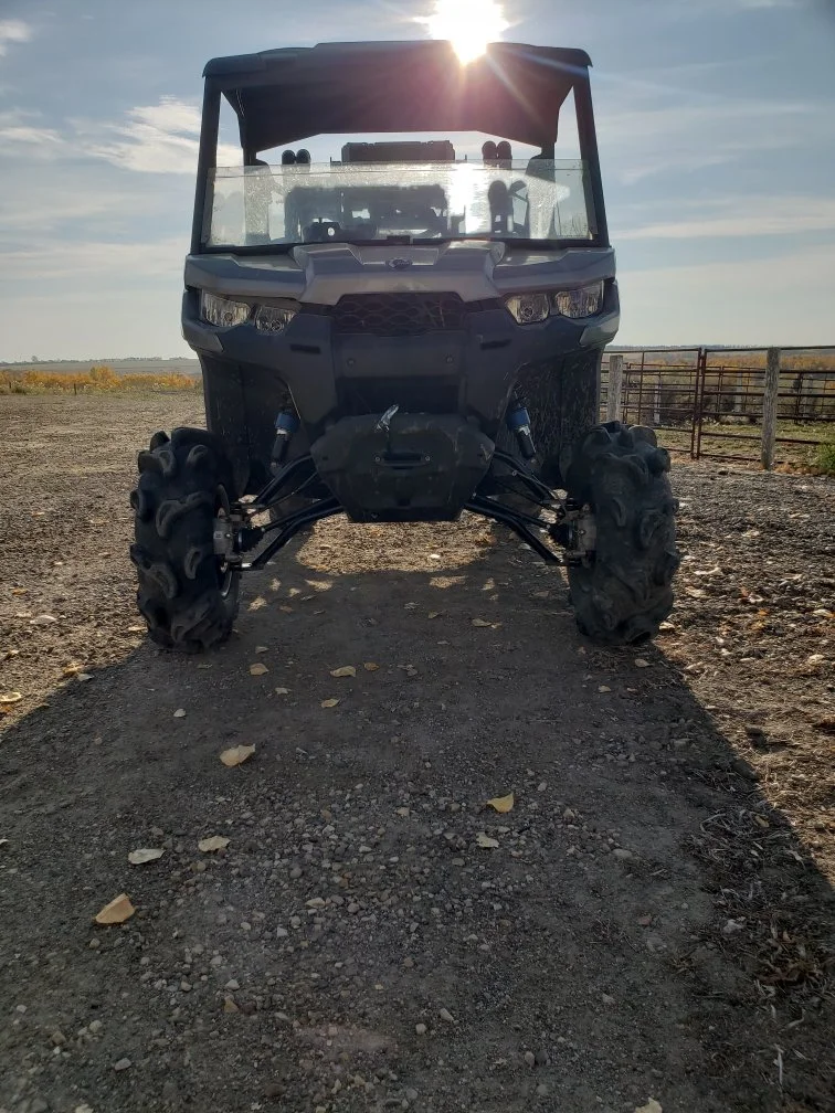

new to the fourm I'm from Alberta this is my ride 2017 hd10 dps picked it up in 2019 it was a dealer demo had 200km on it first mod was a custom snorkel kit made out of pvc then was a set of monster mayhems 29.5" fit with no lift I added 2" spring spacers soon after for added ground clearance it was like that for awhile but my rad kept plugging up so I built a rear mount out of some angle iron and flat bar and picked up a set of renagade xmr beadlock wheels most recent upgrades are moheadz forward offset a arms and a full clutch kit from airdam cant wait for the 2021 season might put on bigger tires before then but for now I'm sitting at 17" of ground clearance and that's not bad I ride mostly trails that lead to bottomless skeg patches so it doesnt really matter the biggest thing seems to be wheel speed to try and skim over it I also hunt with the machine so I have kept the exhaust stock

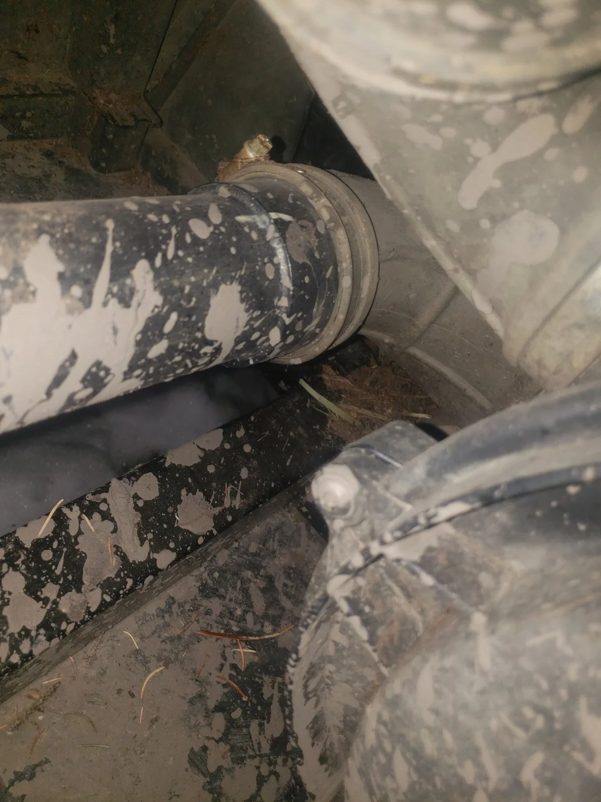

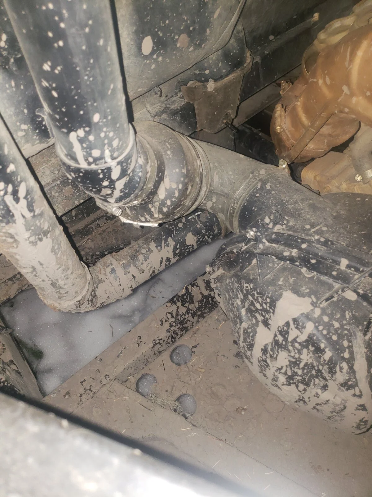

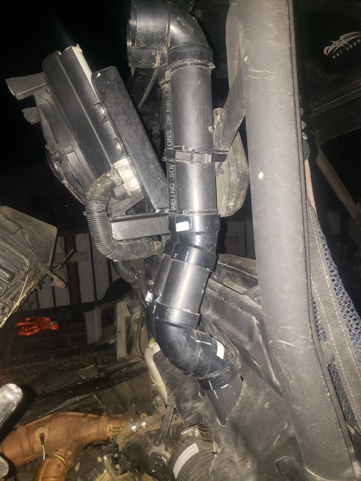

Very nice looking ride you have there. Just wondering if you’d add some more pics of the snorkels you made and what it looks like under the bed. I’m going to do my own as well. Been pondering ordering the sya raisers and doing the piping work myself also from abs. Yours look good so I might not even order the raisers. Thanks

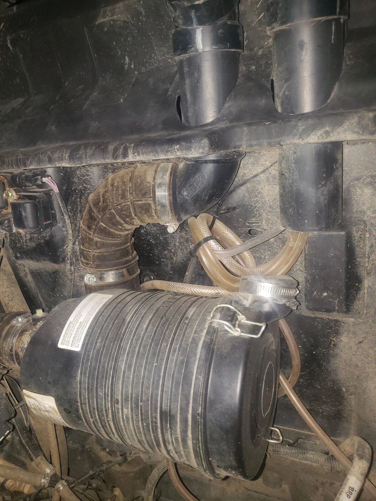

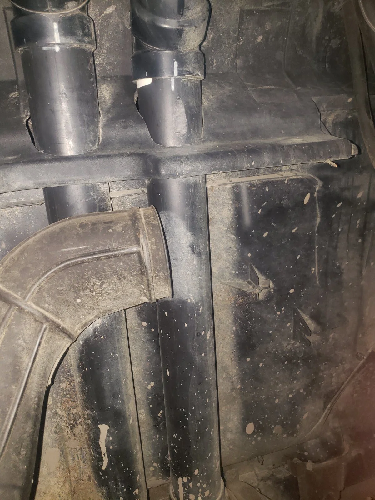

hey sorry havnt been on the forum for a while hope you havnt bought anything yet this cost me about $80 and was super easy to build the far right is just to hide the breather lines not necessary but it looks good box still opens no issues just went outside and took pictures when I seen your post sorry for the quality but I hope this helps
