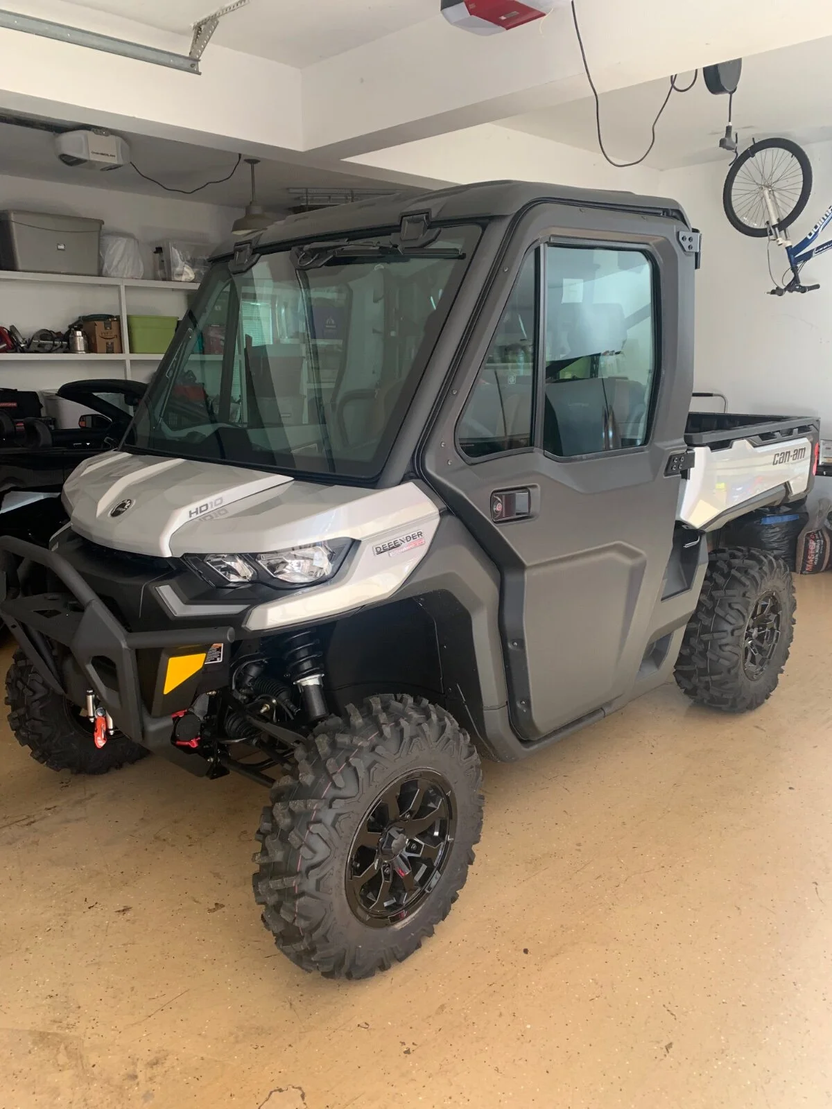

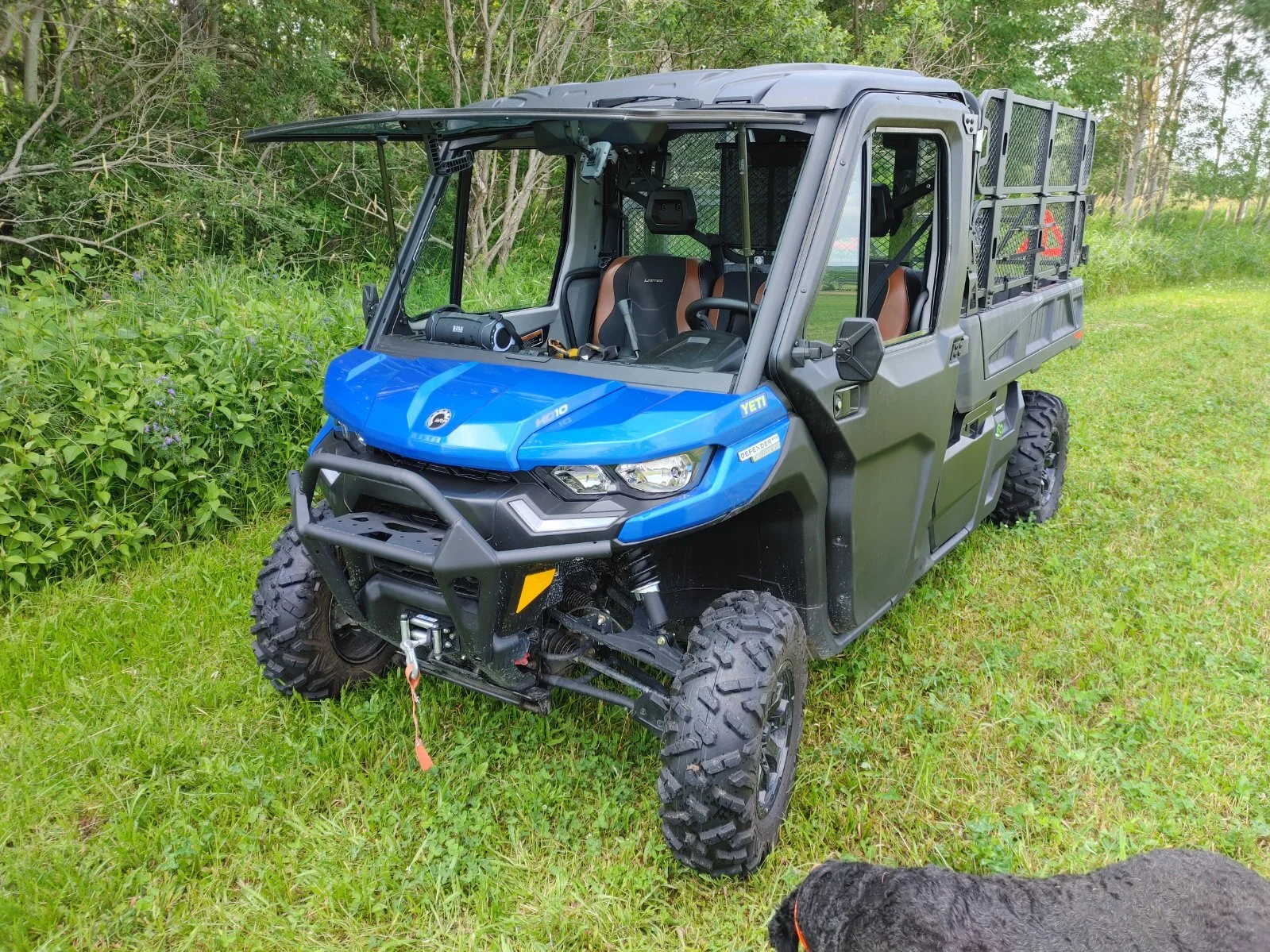

Just picked up a used Defender HD10 Limited and was wondering what everyone is doing for mirrors (rear and side) and where/how to mount them with the full cab enclosure. I did a search on this topic but didn’t find anything. Thanks in advance!
Well, first off let me WELCOME you to the forum. I didn't put anything in the builds really. But yer'z looks a bit like my "Bear".... I used the OEM mirrors... sides and rear view... You can scan my pics to see my bear...  but beware if buying the OEM sides.... they come as single mirrors...
Welcome Madwrstler!  Nice looking Defender you've got.  I don't run side mirrors but did purchase an inside rearview mirror from SuperATV and I've been pleased with it.

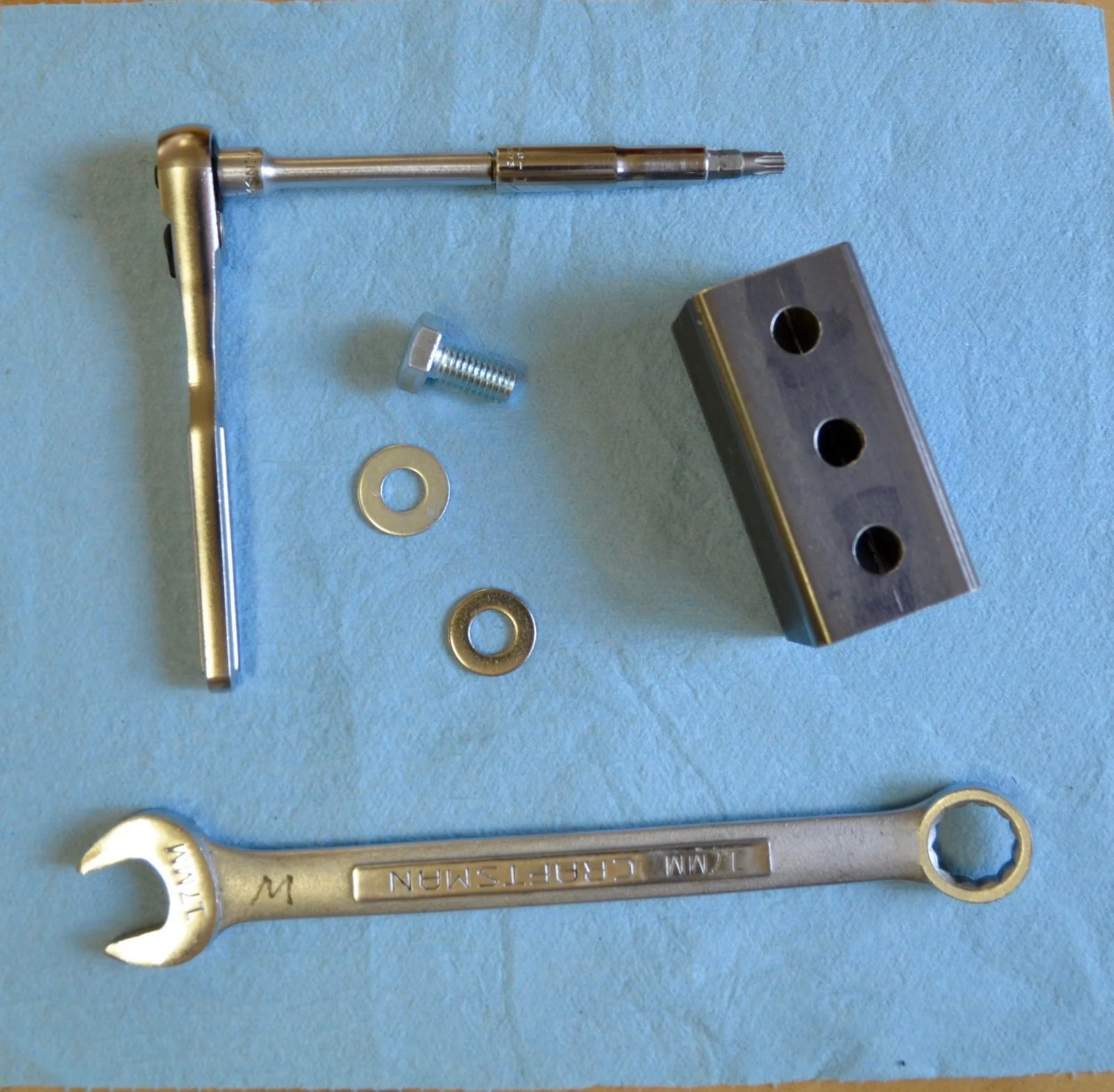

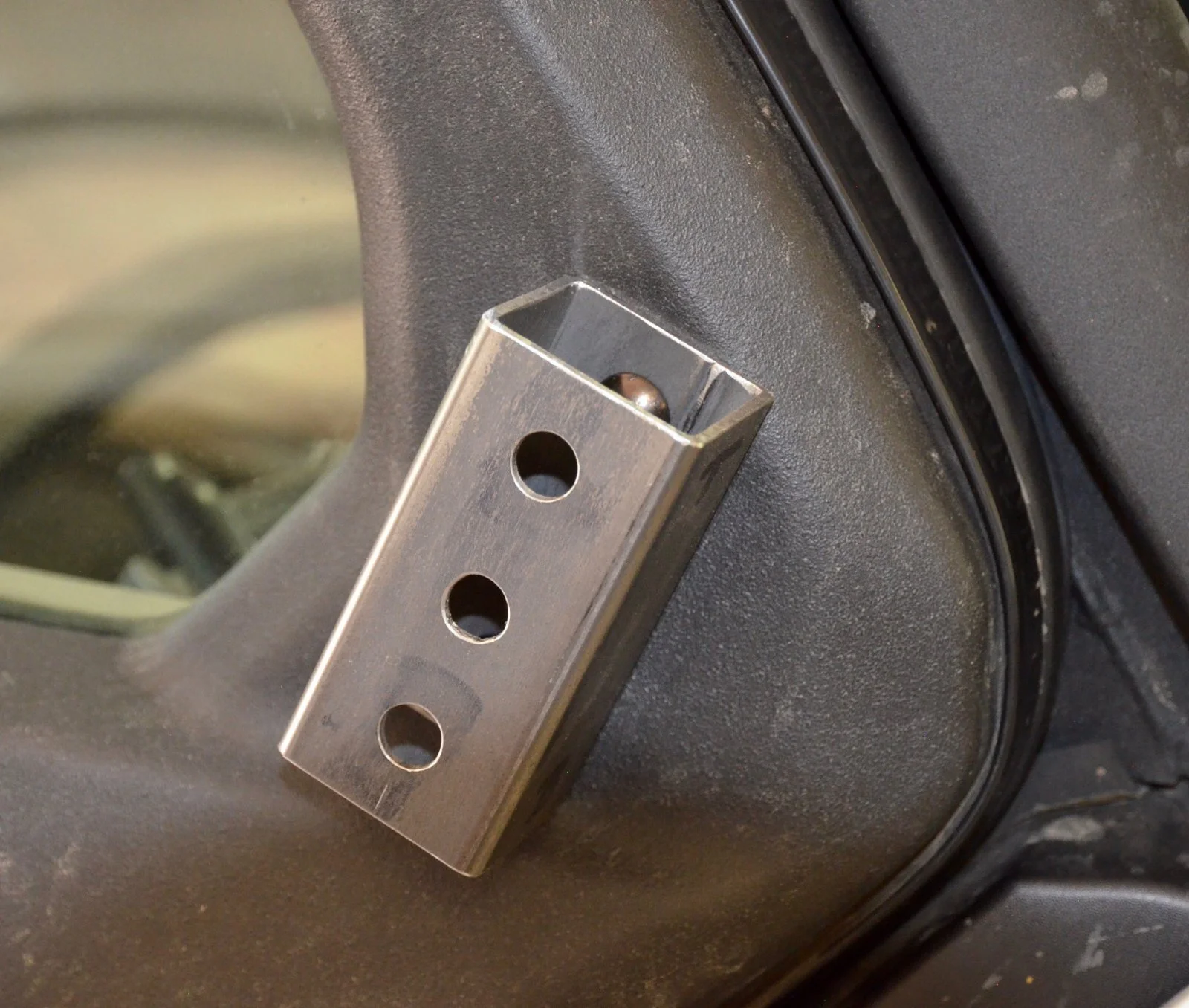

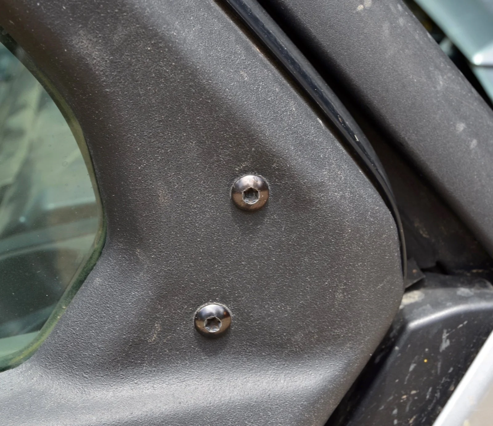

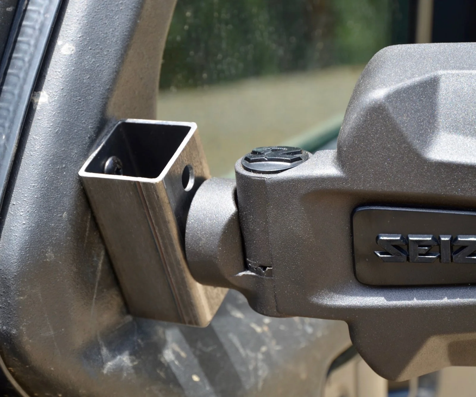

Have a procedure in attachment to install Seizmik mirrors on XT cab doors with part number !!  No need to remove inner door panels...a real hassle.  See images for appearance and tools.  Work really well and fold back for narrow spots...between trees and such.
Good luck !!

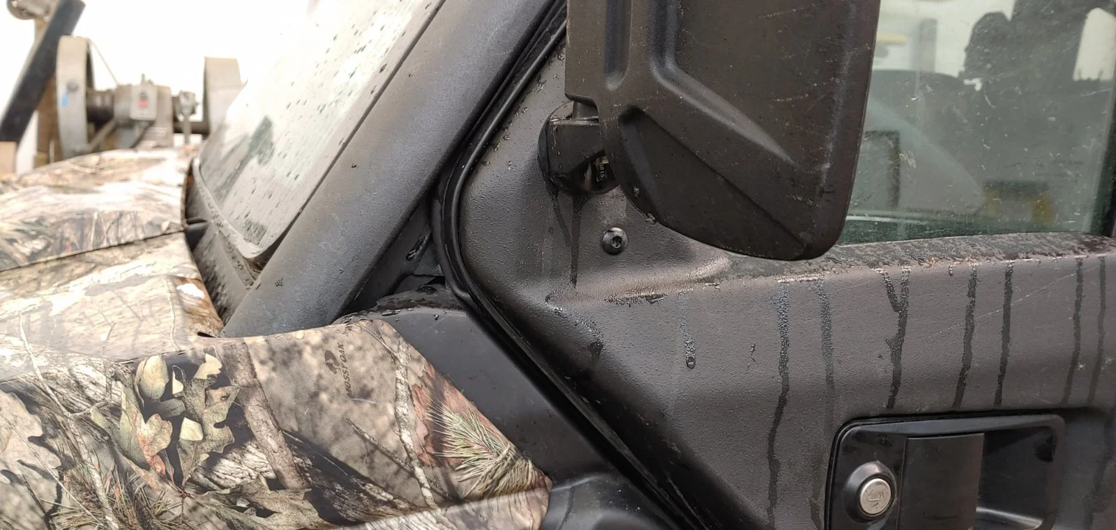

Using the XS Power Stud, you don't need to remove any panels, just one of the two screws in the corner of the door, the 6mm side of the stud threads into that hole, then the seizmik mirrors thread onto the 3/8" side. And the mirrors are still foldable.
XS Power stud is an awesome adapter !  Assume that other size combinations are produced as well.  Love it !!  Thank you !  Never knew of them before your post.
